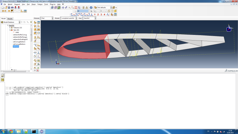

RE: define new Set
Thanks for this. I already found this but I thought it wouldn't be helpful but it is.
So I put this in my command window of Abaqus. It adds a new set with the name 'Set-1' which is good, but when I click on it no red surface appears like when I click on the other sets...
This means that it only generates a new set with a name but doesn't assgin any element or points to it.

here is the photo from the link.
Would be very glad if you can help me! Thanks in advance!
RE: define new Set
I am very sorry I changed the name from 'Set-1' into 'blalb'... it's the set with the red bang. Do you know how I can resolve this?
Thanks!
RE: define new Set
When you have only geometry and no mesh, then it is impossible to find any elements in the bounding box. You should ask for faces instead.

RE: define new Set
In your screenshot - click on the button that looks like a hex-meshed cube (below the "Plug-ins" option).
When you see a mesh, then the python command should work. When no mesh is displayed, then there is no mesh in the part. Maybe you've meshed the instance.
Then you have to switch the type of instance from "Independent" to "Dependent" and mesh the part.
RE: define new Set
I don't see a mesh when I click on the hex-meshed cube. And yes you are right I've meshed the instance. But I have too many parts to just change the mesh on part instead of instance.
Before I was assigning the 'setPiezo' to faces, and these faces were also meshed.
So it is possible to make a set on a assembly?!
Or do I have to change the region=partAerofoil.sets['setPiezo'] into regoin=aeroAssembly.sets['setPiezo]?

RE: define new Set
As mentioned before, the section assignment needs to be done at part level. So you either collect the geometry faces with your bounding box or you have to mesh the part to use the elements.
