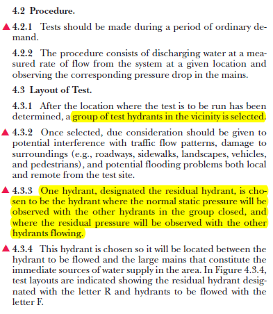

NFPA 291 2013 edition says to use two hydrants at a minimum, not sure if it didn't before
RE: Pitot tube vs hydrant cap gauge
Hummm
4.9.2 The hydrant cap with gauge attached is placed on one
outlet, and the flow is allowed to take place through the other
outlet at the same elevation.
Seems like this is allowing one. Gauge on one outlet and measure thru the other...
Where in 291 is the 2 minimum specified?
R/
Matt
4.9.2 is talking solely about the flowing hydrant,
elsewhere...
I sit corrected. My apologies.
As penance, I will read 291 again as it has been almost 20 years since I have.
Thank you.
R/
Matt
