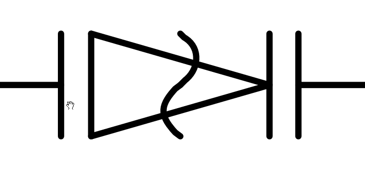

Hi all
I'm assisting my geothermal colleagues and came across a symbol I don't recognize. Can anyone tell me what this symbol means and from what standard it is derived?

My guess is either a soft close non return valve or one that can be held open.
This is a made up symbol so you need the symbol sheet to be sure. No note next to it?

@EmmanuelTop: I had seen that chart, it's the only symbol vaguely similar to this one.
@LittleInch: I think it must be some form of check valve based on the location in the system.
It's on the discharge of each cooling pump and on the return leg from the heat exchangers, where the bypass branch is connected.
There is no note or legend.

Looks like it could be a "cycle stop" valve. Transient pressure controlling valve.

It is most likely a Booster Pump Control Valve, a diaphragm actuated active check valve that opens fully or shuts off in response to electric signals. It isolates the pump from the system during pump starting and stopping, to prevent pressure surges.

I'm going to guess spring-loaded check valve.

There's no electrical or instrumentation signal or actuation on it. For a parallel pump or indeed any pump you would expect an NRV on the discharge line - this is it, there isn't another one.
I'm going with a soft close NRV having seen the diagram.

Don't know where this symbol came from. This fellow has the exact same symbol listed as a dual-plate check valve.
RE: Unknown symbol - Geothermal steam piping
But the 's' appears also on the butterfly valve, hinting that it refers maybe to a wafer-style body. I don't recall seeing that symbol for a butterfly valve either, though.

Kristjan, Like I said, find the symbol sheet.
Quite why you need to make this distinction on a p& id, I don't know.....

I agree with LittleInch that unless the detail is important to operation, not every detail needs to be shown on the P & ID. This is something that can be handled with a valve schedule in the specifications.
In addition, you should confirm with the owner of the P & ID what this item is.

I queried the designer and it's a spring loaded NRV.
The exact type of valve isn't important, however i needed to know the function of the valve.

Just a check valve with a spring load against the flapper or ball to hold it closed until a constant positive flow is assured. This prevents the valve from opening too early when flow might be variable and cause fluttering or chattering, or amplify waterhammer.
