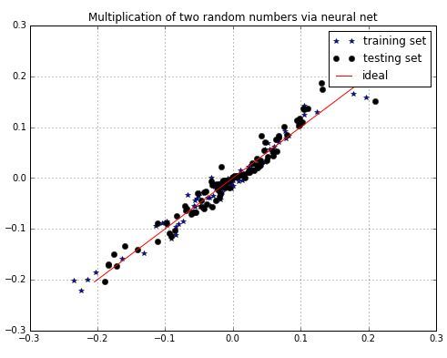

I've just started learning python, and a question on one of the discussion boards set me off looking for a neural net software that was (a) free and (b) easy to use. If you don't want to do programming then Orange is the answer, but I wanted to program it.
Anyway, without further ado here is the result, in which we teach the neural net to multiply two numbers between -.5 and +.5 together

Cheers
Greg Locock

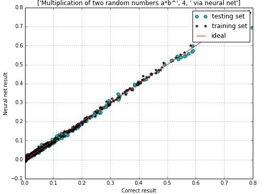

Yes that is definitely an issue - for instance in my code above both the training and the testing set are generated using the same random number generator - so if there is a fault in the RNG then I haven't really tested the algorithm properly.
The reason this came up is someone asked why on a physics course why we always jump into differential equations, so I pointed out you can derive models without assuming a DE explains a given behaviour, but since I hadn't played with neural nets I didn't know if they were any good in general.
my answer now is that they are dangerous in untutored hands such as mine - here's a fit for (a*b)^4 with a and b between -1. and 1. woohoo

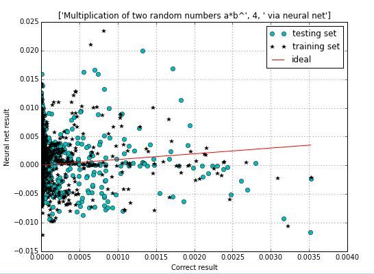

and here's the same model trained and run over the range -.5 to +.5, maybe the problem is just the small values
