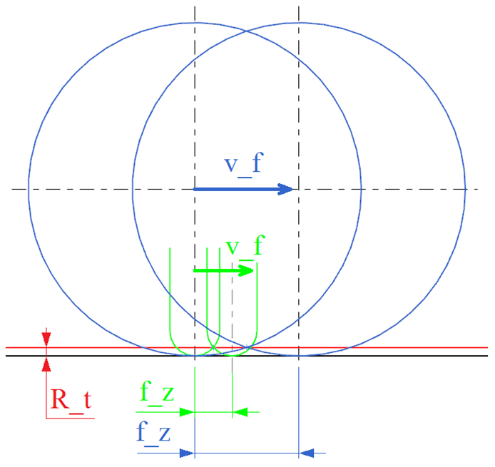

I didn't mention in the original post that, this would be some kind of improvement of an already developed technology, which is five axis milling with a ballnose endmill. The goal is to reduce costs by reducing the machining time. Using the disc cutter greater feed/tooth values could be reached, because the surface roughness is less limiting compared to the ball mill (see on the picture below, where R_t=theoretical roughness, f_z=feed/tooth, v_f=feed).
I made an assembly, in which I constrained the disc cutter several times to the surface of the slot. It showed me that, the milling geometrically possible (considering the toolholder, spindle too). A little bit edgy, but possible.
And yes, just like cnc07 mentioned, maybe the grinding can be achieved too with the generated milling toolpath.
