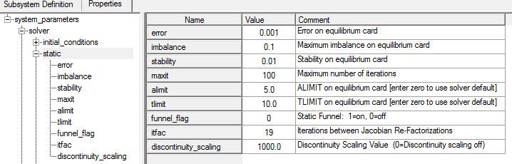

please I have got this message for static equilibrium:
ERROR:
Static equilibrium analysis has not been successful.
The maximum number of iterations 25, has been reached.
For the last attempted iteration:
The equation with the largest error was Vessel.Rear_wheel_1 Comp = 6 Error = 2468.747118
The variable receiving the largest increment was Vessel.Fixed_Vessel Comp = 4 Delta = 308356.068501.
ERROR: Lockup detected.
I want to know what is the problem, however the dynamic simulation is done

Thanks GregLocock
I have already increased the maximum iterations (maxit), and found that the error increase in this case
