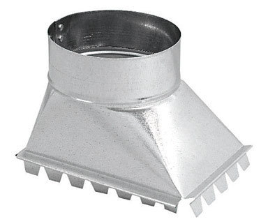

With reference to the subject I am dealing with duct work on site wherein I found discrepancy in the design & its as follows:
A DUCTED FCU of capacity 396 l/s with a duct size 700X150mm & the distribution of air to the living/dinning room is via a Diffuser(225x225mm-50 l/s= 2Nos) & a Linear Air bar grille of size 1500x100mm for 296 l/s air flow. The designer has selected 200mm flexible duct to connect it with the Plenum of linear bar grille in 4 Nos of multiple connections whereas the Main rectangular duct height itself is 150mm, hence I can't fix 200mm flex duct in a 150mm height of duct. illogical!
At this moment I cant even re-size the main rectangular duct as all the shop drawings are processed for duct fabrication.
Should I go for a 100mm flexible duct by increasing the Nos of multiple connections or I need to increase the size of a plenum?
I am worried about Noise levelmad.
Please advice. Your comments are highly appreciated.

Can't you connect the flexible 200 mm duct to the top of 700x150 mm duct instead of the side?

@317069 (Mechanical) I think its ok. but if I connect flex from the top then the balancing(round)damper will be in a vertical position which is again a issue.
And also the flex duct will be in a C-Shape.
I will check once....or else I will resize the plenum.

You should be able to make a side takeoff rectangular to round transition with a 45* entry. Have them make it 150mm on the side then transition to 200mm round.
