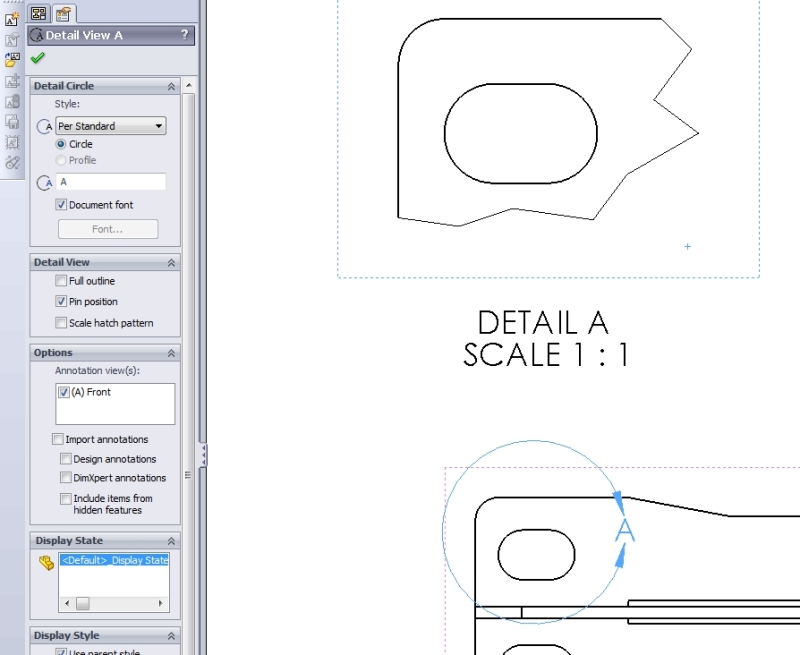

I have a hopefully easy question. I have attached a sample pdf of what I am trying to do. In solid works, when you do a detail view you see then nice smooth outline on the detail view. This confuses the owner to no end, and some of the shop guys have issue as well. I have attempted to teach them the serenity prayer to accept things they cannot change, and learn how to read the drawing, but alas with the owner saying no, I must change my ways. I have tried drawing a custom detail to show a jagged edge, but that again was met with a swift "Not an option!". As it is I have to draw in solid works, then save as dwg to modify the drawings in autocad. A very clunky and non elegant solution. Does anyone know of an easy way to accomplish the this? I need to use the standard circle to create a detail view, but where the detail view is "cutting" through a part, the edge needs to be "jagged" or at least the line must have the good old lightning bolt on it to denote it is a cut edge?

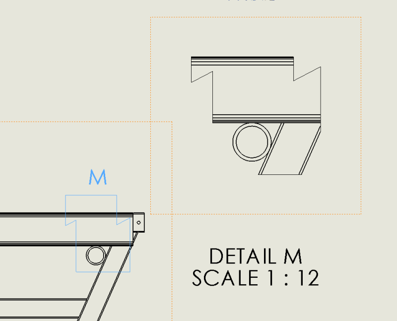

What you'll need to do is create a sketch of the profile you're trying to create (see pic). Then, with the sketch selected, create the detail view. From the dropdown menu, choose the 'No Leader' option. This should allow you to change from 'Circle' to 'Profile'. You'll now have a detail view that has the outline of the profile you drew.

I think you could draw the jagged edge as a closed set of lines in the Parent View, select them all (Select chain), and then click for your Detail View. The outline still shows as a circle on the Parent View, but the Detail View reflects the jagged lines you drew.

Place a duplicate of the source view off of the drawing sheet. Put your jagged cut section profile per JMirisola's method on the off-sheet view and use it to create the detail view on the sheet. Then fake the circle and letter on the parent view that is on the sheet.
