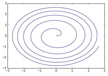

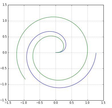

Incidentally it is a right load of old numerological nonsense, the presence of the golden ratio in the definition is practically irrelevant, you get the same shape curve whatever the relative scaling of magnitude and phasor. Here's a comparison between
x[n]=numpy.sqrt(n*nscale)*numpy.cos(2.*pi*phi*n*nscale)
y[n]=numpy.sqrt(n*nscale)*numpy.sin(2.*pi*phi*n*nscale)
and
x1[n]=numpy.sqrt(n*nscale)*numpy.cos(2.*pi*n*nscale)
y1[n]=numpy.sqrt(n*nscale)*numpy.sin(2.*pi*n*nscale)
Cheers
Greg Locock
