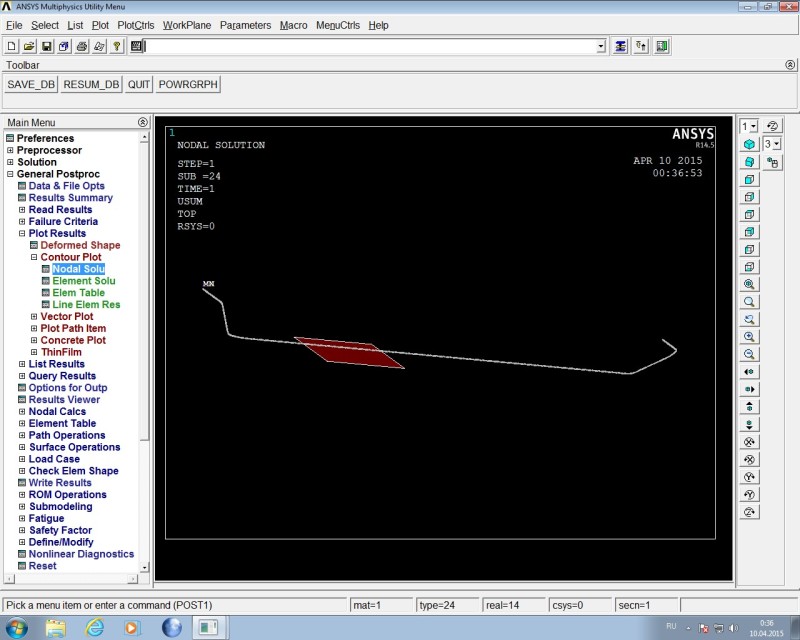

contact pipe289 with ocean sea APDL(apdl14.5)
contact pipe289 with ocean sea APDL(apdl14.5)
Hi! I am trying to calculate contact pipe with ocean floor (APDL14.5). Pipe289 was used. Contact was created by contact_wizard-conta175 and targe170 were created
I got very strange results -that stress and deform is zero. By the way , I don't manage how to made results - 3-D. How?
What may be wrong?
I attached model and picture
Thanks a lot.
I got very strange results -that stress and deform is zero. By the way , I don't manage how to made results - 3-D. How?
What may be wrong?
I attached model and picture
Thanks a lot.
