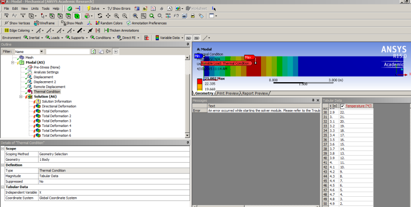

I got the two span beam. But the solution with temperature is not working. Eventhough it was the simpler one to implement. It is not letting me solve the model. What could be the mistake that is producing this mistake? I am almost sure that I deleted the coefficient of thermal expansion.
Any other advise?
Thanks greatly
RE: ANSYS simulation of beam with variable Modulus of Elasiticity (E)
Check the solution information for more information regarding the error.
