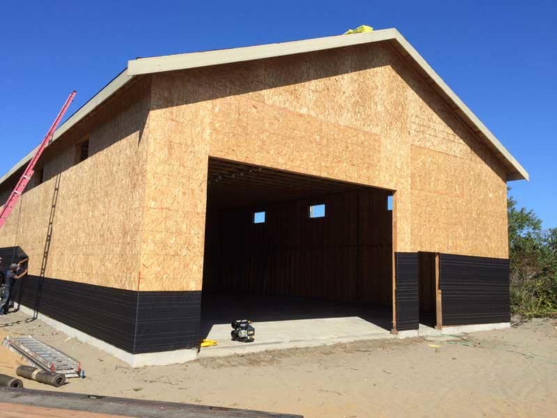

Today a large garage landed on my desk, conventional light wood frame construction. The only thing that really jumps out at me is the size of this structure. 40'x60' rectangle with 40' trusses on 15' high 2x6 walls. I haven't ran all of the numbers yet but I'm sure I can get the stud walls to work with a minor upgrade as well as the shear walls, roof diaphragm and garage door header. The stemwall foundation and slab have been upgraded by the owner and my experience tells me already that bearing loads won't be a problem either.
Nothing really special going on here other than size which causes me to wonder if at some level I may be overlooking something with respect to a structure of this size. As we begin to scale things up are there other codes or factors that come into play that would not otherwise with a smaller structure. There are no internal walls, just the 4 exterior walls with a 18' wide garage door at one of the gable ends and a 3' man door. From a prescriptive standpoint I know this structure breaks all of the IRC braced wall line rules so the IRC is out of the question on this one.
The reason I have a concern here is based on a conversation I had with an architect on a personal project about 10 years ago. At the time I was involved with my brother in a roofing materials distribution business. Being very young and inexperienced I figured I would design our next warehouse. Ultimately we had to have a architect take it over after my initial attempts. His first comment at my conventially light woof framed structure (100'x60'x20' box) was that it was simply too flimsy at that size and we ended up going with CMU for the 20' high walls.

I would push for 2x8 studs but if the numbers work for 2x6 then so be it.

I would think you would require 2x8's in your area carrying that much truss. Also, might want to align the studs with the trusses or you may have a top plate bending problem.
RE: Large Garages
Before going any farther, I would contact the owner or contractor to determine who their lumber supplier will be. I have noticed that often the longer the lumber is, the higher grade it is. So the lumber yard might have DF #1 or SS for those lengths and then you can keep your standard 16" o.c. spacing.
One other issue that I deal with on these large clear span buildings with tall walls is the tension transfer from the roof to the base requires additional detailing.

With the snow load and dead load I've got 790 plf at the top of the side walls. I've read through some discussions about top plate bending before in other posts but I can't remember if one should consider both or only one of the top plates due to splices. I'll have to search back through some of the posts. To align the studs and trusses would require moving the truss spacing to 16" o/c or moving the studs to 12" o/c.
I have never called out DF No. 1 or SS for studs but it seems it may not be out of the question.

Yes I was referring to net uplift from wind loads applied to the top plate. My most recent building (60' clear span 4/12 roof ASCE 7-05 Exp. C) had approximately 335 plf of net uplift at the truss/plate interface. I ended up blocking all of the splices per SDPWS requirements and used APA SR-101C for guidelines on nailing and anchorage requirements. Initially, I required A LOT of nails at my splices/plates, but due to the relatively low base shear (~50 plf) I "re-purposed" some of the shear nailing for uplift nailing. A good conversation with an APA engineer put my mind at ease that this was an appropriate method.

This is more means and methods, but I know of a project in my area where the stud walls were tall, and the contractor built the walls in two lifts, creating a hinge at the midheight of the walls. The structure collapsed during construction, causing one injury.
My point--make sure it is clear these are 15' stud walls, not 7' stud walls on top of 8' stud walls.

I now specifically put full height studs directly on the framing plans as I got bitten by this twice on gable end walls and vaulted ceilings.
The fix ended up being steel columns at a spacing to make horizontal wind beams at the 8' mark work out.

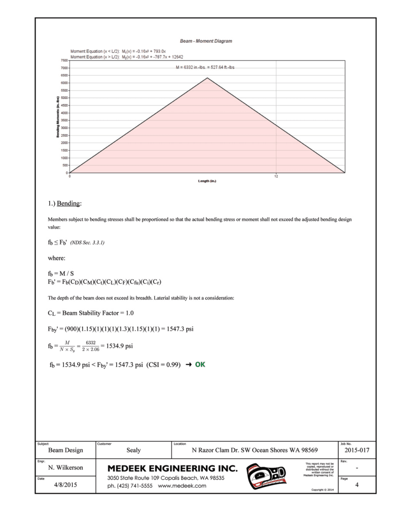

With a point load of 1581 lbs and stud spacing of 16" I get the following for bending (assuming 2-2x6 oriented flat, adding their section modulus):
I'm going to give this a pass, for a number of reasons:
1.) I'm treating this as simple supported, in reality it is more like a continuous beam so bending moments would be less.
2.) I'm not considering any additional stiffness from wall sheathing or gypsum wall board.
3.) If you consider a partial composite action of the two top plates the section modulus would be greater than simply adding the section modulus of two 2x6 plates.
4.) In my notes I specify that all top plate splices be positioned over a stud.

I would not count on the splices ending up where you want them. For a double 2x6, you are probably OK, however.
Might be better to go 2x8's @ 24" o.c. - stiffer wall, less material and the ability to tie the trusses directly to the studs for uplift.

With 2x6 DF No. 2 studs I get:
With regards to strength it will work but what I am not liking is the 1.02 in deflection at 70% C&C wind loads. Even though the IRC gives you a pass at L/120 for flexible finishes and L/180 for exterior walls with gypsum on the interior side it seems to me that a deflection exceeding 0.5"- 0.75" is excessive. Does anyone else consider a hard cut off in this respect?

I just spoke with the owner of the project and he has already purchased the lumber (2x6 DF. No. 2) for the studs. I could probably let him get away with 16" o/c based on these numbers but I think given the high winds of this locale and the overall size and height of the structure I will require him to go with 12" o/c, it is only 33% more studs.

With the same C&C wind load I am getting 0.67" of deflection for a DF No. 2 2x8 stud @ 24" o/c.
With a DF No. 2 2x6 stud @ 16" o/c = 1.02"
With a DF No. 2 2x6 stud @ 12" o/c = 0.77"
Interesting how the 2x8 does so much better in bending, the depth squared in the section modulus is to blame of course.
I don't know if the customer can return all of those 2x6 studs but it makes me wonder if I shouldn't present him with the option to go with the 2x8 studs. 24" o/c is a lot less nailing of sheathing.

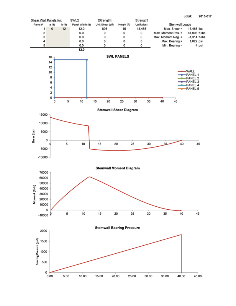

Interestingly with the one gable wall of this structure I only had 12' of shearwall. Given the deflections and the eccentricity of rigidity of the structure I opted for a rigid diaphragm analysis and distributed the shear wall loads accordingly. Even with that the load to the garage door wall was approximately 6432 lbs (ASD wind), with a unit shear of 539 plf and uplift of 8080 lbs. I always conservatively neglect the counteracting dead loads because I don't think you can rely too much on a distributed dead load to fully counteract a single "point" upload.
The 8" x 24" stemwall below this wall required two #6 rebar top and bottom to deal with the bending moment imparted into the stemwall foundation and footing. I'm not very experienced with concrete so I'm not entirely confident that my calculator for this portion of the design is not too conservative but there will be a significant moment at the edge of the shear panel as shown below:

RE: Large Garages
I needed to create a detail for the concrete at SWL2 however in the process I decided to draw up the entire wall simply to get a better feel for the size of the structure and what a fully blocked shearwall really entails. With the 12" o/c studs it does look a little out of control. Note that most of the detail notes have yet to be added, I'll finish it out tomorrow. In order to get enough moment/bending capacity out of the stemwall I dropped it low enough so that I have at least 24" of depth at the door cut outs:

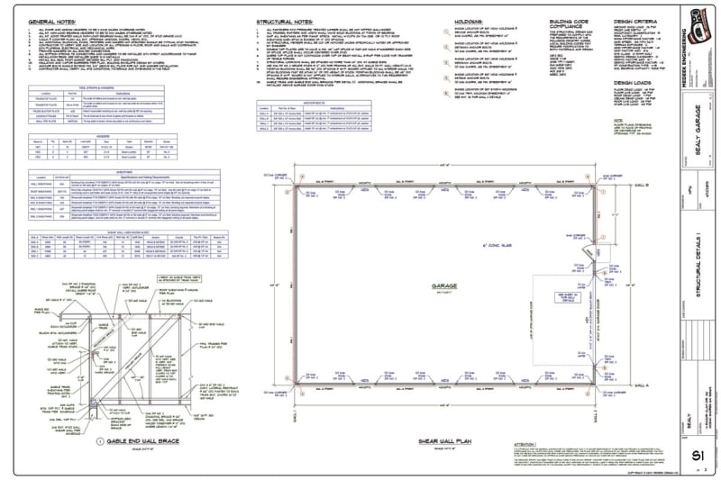

RE: Large Garages
Here is the final detail, the critical part is really only the concrete stemwall:

Is your ceiling diaphragm gypsum? How are you getting out-of-plane wind on the gable end into the ceiling diaphragm? That can be tough with high winds and tall studs. I usually end up balloon framing the gable end in these situations to avoid the issue.
RE: Large Garages
Yes, the ceiling will be gypsum with standard 0/12 bottom chord mfg. trusses. In these situations I treat the gable truss like a drag truss and in the notes I specify to the truss manufacturer the lateral loads these gable end trusses can expect as well as sheathing requirements. I've had a couple truss manufacturer's actually call me a couple times requesting a decrease in lateral loads for these trusses, but how else can you get the roof diaphragm loads down to the shearwalls unless the truss above can transfer this load?

The gable truss above is normally plywood sheathed and acting as a vertical diaphragm, right?
I generally do this kind of thing for the out of plane forces: Link
Having a gypsum ceiling in addition to the discrete bracing feels good from a belt and suspenders standpoint but I never count on it. Unless you detail it carefully -- and atypically -- it's unlikely to be a complete / competent diaphragm.

I am talking about wind blowing on the end wall of the garage. How does that load get into the ceiling diaphragm as it is bracing the hinge between your stud wall and the gable end truss?
RE: Large Garages
I have never provided a detail for this before (relied upon the truss manufacturer for their standard gable end frame detail) even though I have discussed it at times in varies threads on the forum here.
Being that the span and size of these gable end trusses are so large it is something requiring a second look.

The more I think about it the more I'm realizing that this is actually a very critical location. Half of the out-of-plane end wall wind load is being transferred by the studs to the top plate of this wall. Somehow all of the load has to get transfered either into the roof diaphragm or into the side walls (shearwalls). The gypum ceiling cannot be relied upon for this. The continuous lateral restraints at 10' o/c attached to the bottom chords of the trusses will help spread this load into the other trusses but without sheathing they offer no diaphragm action on their bottom chords.

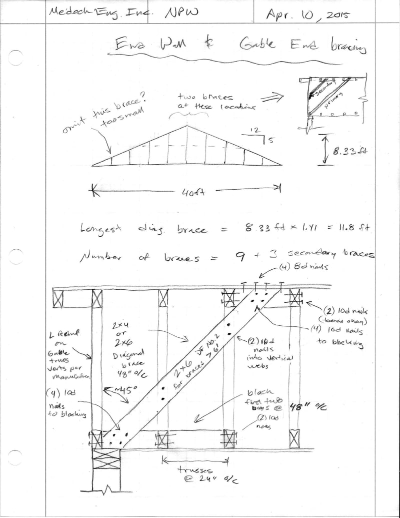

That is why is makes sense to balloon frame it. There is no free lunch. You will need at least 2x8's if not more to do that.
I have tried the GBC's, but it is about impossible to get the kickers fed thru the trusses - much easier if it is stick framed. They also put a huge uplift on the end wall and the truss that they connect to (depending on the wind direction) This load is also about impossible to deal with.
Might want to try a plywood ceiling for the first 12 ft or so.
I have done this by specifying that the first 6 trusses be made 1/2" shorter in height than the rest. Then they can sit on top of the plywood and you still have a smooth GYP ceiling.
The contractor hated it!

RE: Large Garages
This may be an oversimplification of what is going on at the gable end but I think it is good enough to give me some ballpark numbers.

RE: Large Garages
Based on Simpsons F2 values I'm going to assume about 450 lbs of lateral resistance per 2x4 brace using their GBC connector. This neatly works out to a diagonal braced every 24" o/c. At the other end of the brace I've got two 16d nails connecting it to vertical blocking between the truss top chords:
Z = 141
Z' = 141 x 1.6 = 225 lbs
Capacity = N x Z' = 2 x 225 lbs = 450 lbs -----> OK

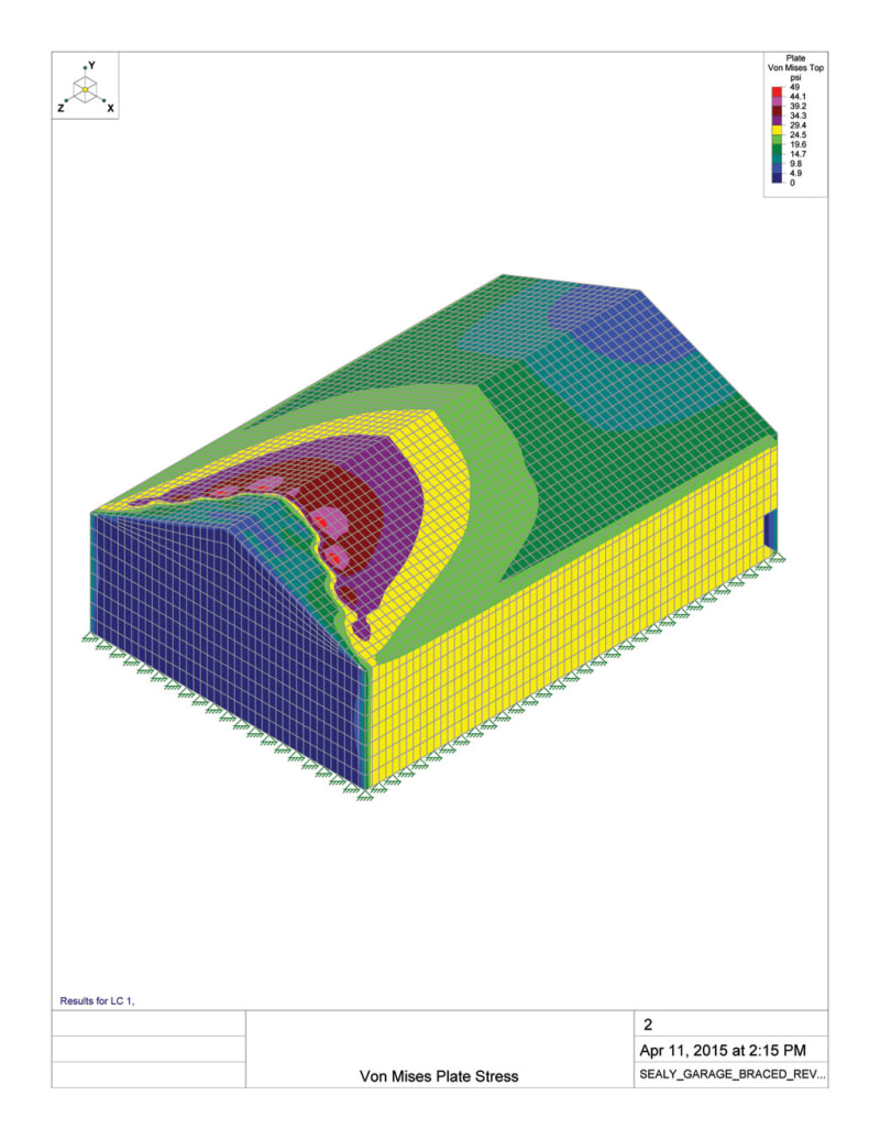

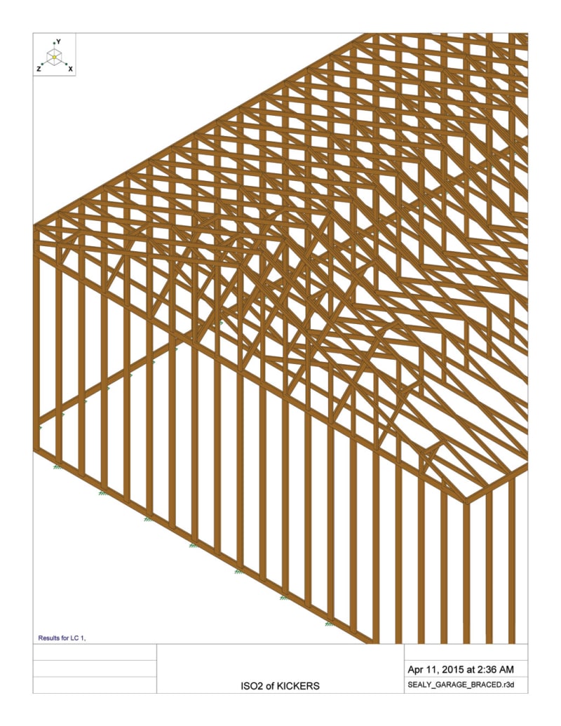

Here is my analog in Risa3D of the braces interacting with the roof diaphragm:
https://www.youtube.com/watch?v=9FnB5Y0qgHw
The uplift on the roof diaphragm is not very desirable but I suppose the trusses can resist that load in some fashion or another since this seems to be the common method handling this.
I do like the horizontal truss and ceiling diaphragm method however both of these method are not transferring the load into the roof diaphragm but rather directly into the sidewalls and bypassing the roof diaphragm altogether. My roof diaphragm in this direction is very strong (60 ft deep), to not tie into it and replace it with a partial ceiling diaphragm 12 ft deep and 40 ft in length is hardly a optimal solution either. There is also the issue of the diaphragm aspect ratio limits of SDPWS Table 4.2.4, for an unblocked diaphragm I technically need 13'-4" of OSB/PLY on the ceiling.

Something along these lines possibly for the bracing:

I'm not entirely happy with the connection of the diagonal brace to the blocking at the ceiling. In compression it would work fine but if the wall is sucked out and the brace is in tension the nails connecting the block to the gable truss are subject to withdrawal.
A confused student is a good student.
Nathaniel P. Wilkerson, PE
www.medeek.com
RE: Large Garages
I'd recommend attaching your braces and your gable end truss to the sill plates, separately.

The axial loads in the kickers given by RISA3D:
The wall studs loads are:
The RISA Model:
Closeup of the gable truss with kickers:
Planview:

I wish I knew more about FEA and plate modeling. I think if one could establish a realistic model that accounts for various factors such as nail slip and tension etc... it would be interesting to see really how accurate our simplistic assumptions are.
Here is the Von Mises Plate Stress from the model above:
I never did take an FEA class in school, wish I had. My other electives (robotics, jet engine design, aerodynamics etc...) are pretty much useless to me now. I guess it is time to find a good text book on FEA and understand plates a little better. I would also like to utilize some FEA models to validate my new FTAO and Portal Frame calculator that I'm working on.

Here is my first draft at the Gable End Wall Brace Detail:
The overall structural plan for reference:
I've decided to try 36" on center spacing since 48" on center has to high of point loads at the connections to the top plate and also at the connection to the roof diaphragm

Now that I've got that more or less worked out back to KootK's diagram.
Take a flat ceiling diaphragm, flip it up vertical, support it at both ends and you have a really tall, thin beam. However the way I see it is that the direction of the rafters or girts play into it. From my recent work on the pole frame structures it can be shown that the diaphragm chord forces are not just at the perimeter as is typically assumed with wood framed diaphragms but rather shared by the internal girts as well.
I would be really interested to read more on the methods used to come up with the diaphragm allowables found in the SDPWS and what their assumptions and simplifications were. Are these numbers from purely empirical testing?
The to further complicate the matter you pitch the roof. Low slope roofs are probably pretty close to the classic diaphragm but what about a 12/12 pitch roof. Does the higher pitch make the diaphragm stronger or weaker? Where does this change in pitch show up in the SDPWS tables? Maybe it is a insignificant factor.
My thinking with the cross grain splitting is what is the failure mode. Will the nails heads pull through the panel first or through the edge before the framing splits. My suspicion is that the nails will pull through the edge of the panel before the framing members splits when the nails are not closely spaced (ie. 6" o/c at edges).
I actually think modeling diaphragm action, nails included would be a good candidate for FEA. I'm just not sure how to model the nails and sheathing effectively. What I am interested in visualizing is how the nails load up in a diaphragm. Do the nail loads mirror the classic diaphragm shear diagram (zero load at the middle) or are there other effects or factors at play that are overlooked by the classical diaphragm model?

Thanks for reviewing my sketch guys. As follow up, I submit the additional sketch shown below. Given Medeek's loads, and the assumption of distributing those loads throughout the entire length of the diaphragm, the first plywood joint would need to transfer about 225 lbs of tension. With a 6" nail spacing, that's equivalent to a 12" strip of plywood with two nails in it holding up a standard olympic barbell loaded with four 45 lb plates. Does our collective intuition still tell us that this would be okay? Ditto for a drywall option?
Note that I'm just having fun with this as an arcane technical discussion. I'm still handling this as everyone else does: full diaphragm engagement, blinders up.

ever consider storage trusses?
RE: Large Garages
I'd stand under that for a short duration (especially if beer was involved as shown)
You have a potential career as an artist :>

As a follow up I went out yesterday and took a look at the construction. If the roof was a bit higher of a pitch I definitely would have suggested storage trusses. I could really use a garage this big.
Picture of the framing of the shearwall next to the man door:

RE: Large Garages
Looks like the framer and the building inspector missed the note that all 15 ft. walls are to be 2x6 DF No. 2 @ 12" o/c spacing.

RE: Large Garages
Looks like truss bracing and gable end truss bracing are missing, I only see rat runs.
Are truss straps correct?
Can't see the outlooker straps/clips.
Is the exterior water drainage being followed? tall exposed OSB sheathed walls needs more then 15# roofing paper
Consider checking the nailing of the 2x8 on the inside of the garage door opening.
The garage door track attached to it and is a critical elopement we have seen failures during high wind events of the door blowing in.
RE: Large Garages
He only has one (center) gable end truss brace installed, I let him know that the other gable end braces needed installing. Its still under construction so I expect some of the elements to still be missing.
@boo1
The exterior cladding will be hardiplank over the felt. What is your thinking on the 15# felt, what do you suggest?
