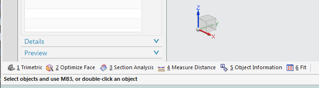

RE: Corner blend
Hi John...
A bit off topic, but in your movie I can see some "status bar" showing your history actions. Is this NX10 only or also a setting which can be done in NX9 ?
Ronald van den Broek
Application Specialist
Winterthur Gas & Diesel Ltd
NX8.5.3 / TC9.1.2
HPZ420 Intel(R) Xeon(R) CPU E5-1620 0 @ 3.60GHz, 32 Gb Win7 64B
Nvidea Quadro4000 2048MB DDR5
HP EliteBook 8570W Intel(R) Core(TM) I7-3740QM CPU @ 2.70GHz, 16Gb Win7 64B
RE: Corner blend
What you're seeing is something I added myself using Customize (and yes, it can be done in NX 9.0 as well). I'm utilizing the 'Bottom' Border Bar as a repository for the last 10 'Repeat Last Command' items. I use it as an alternate (and in all honesty, easier to use) version of the 'Repeat Command Drop-Down' found on the upper most Border Bar (where the 'File New', 'File Open', and 'Save' icons are located).
The way you set this up is you first have to have a model where you've performed at least 10 different functions so that the current 'Repeat Command Drop-Down' is full. Then go into 'Customize' and while holding down the 'ctrl' key, drag the icons that you find in the 'Repeat Command Drop-Down', one-at-a-time, starting with the first one and then going in order, from there to the 'Bottom' Border Bar. Once you've copied all 10 icons, leave 'Customize' and remember to save your Role.
Now as you're performing operations, if you wish to repeat any of the last 10, just selection it from the 'Bottom' Border Bar.
Note that you'll have to repeat this for each major application or task that you want to have access to this 'feature', such as Modeling, Drafting, Sheet Metal, etc.
Anyway, have fun winky smile

RE: Corner blend
To make a sharable, file-based, bottom border bar definition that can be centrally deployed from a shared network location, create an ascii text file with an ".abr" extension containing the following:
CODE --> Recent_commands_bottom_border_bar.abr
!  Recent Commands NX Bottom Border Bar ribbon file
! Place in "%UGII_SITE_DIR%\application\profiles\UG_APP_MODELING" etc. directory.
TITLE  Custom Bottom Border Bar
VERSION 170
ATTACHMENT_TARGET BottomBorderBar
BUTTON UG_TOOLS_REPEAT_LAST_COMMAND_0
!! Uncomment one of the following STYLE directives to adjust the appearance.
!! "DEFAULT" (or no directive) is icon only.
!STYLE DEFAULT
!SYLE TEXTONLY_ALWAYS
STYLE IMAGE_AND_TEXT
!STYLE TEXTONLY_MENU
BUTTON UG_TOOLS_REPEAT_LAST_COMMAND_1
BUTTON UG_TOOLS_REPEAT_LAST_COMMAND_2
BUTTON UG_TOOLS_REPEAT_LAST_COMMAND_3
BUTTON UG_TOOLS_REPEAT_LAST_COMMAND_4
BUTTON UG_TOOLS_REPEAT_LAST_COMMAND_5
BUTTON UG_TOOLS_REPEAT_LAST_COMMAND_6
BUTTON UG_TOOLS_REPEAT_LAST_COMMAND_7
BUTTON UG_TOOLS_REPEAT_LAST_COMMAND_8
BUTTON UG_TOOLS_REPEAT_LAST_COMMAND_9
The ".abr" file (above) needs to be located in the "%UGII_SITE_DIR%\application\profiles\UG_APP_MODELING" directory (or appropriate peer application directory) for each NX application that wants to display the border bar. (See "%UGII_BASE_DIR%\ugii\menus\profiles" for the "application names".)
This displays both the text title and icon for each recent command (as shown in John's AVI). If just icons are desired the 10 lines containing "STYLE IMAGE_AND_TEXT" can be deleted. This is compatible with NX 9 and NX 10.
HTH,
Joe
