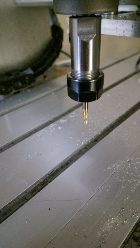

I just bought a Chinese 3040 230W engraving CNC machine and have recently been struggling with milling operations on aluminium as you can see on my previous forum posts. I am trying to cut through a 4.3 mm thick aluminium box with a TiN coated carbide 2 flutes 42degree end mill with the following specs:
  • Mill Diameter: 3/32" (2.38 mm)
  • Shank Diameter: 1/8" (3.175 mm)
  • Length of Cut: 1/4" (6.35 mm)
I am trying to cut a profile through the entire thickness of the box. To generate my gcode, I used CamBam with the following parameters:
  • Depth Increments: 0.5mm
  • Target Depth: -4.5mm
  • Cut Feedrate: 125 mm/min
  • Plunge Feedrate: 62 mm/min
  • Spindle Speed: 6000 rpm
  • Tool Diameter: 2.38 mm
  • Inside Profile Cut (Rectangular Shape)
I have been trying 4 times to complete the operation but every single time, at some point, I would start hearing a really harsh noise and could see that my spindle speed was gradually slowing down or even see my end mill completely jam in the aluminium. When it happened, I always tried to shut down my controller as fast as I could to prevent further damage to my machine but during my last trial, the fuse blew and had to replace it. I use WD-40 as a lubricant and compressed air to blow the chips away.
Since I was able to cut through softer 1.25 mm thick aluminum plates with the same machine, end mill and parameters, I am wondering what is causing my problems. At a first glace, do my parameters look good? Is my machine powerful enough to complete such operation? Any hints/tips would be greatly appreciated! Thanks a lot!

Off the cuff math shows your feed per tooth is .0004" / .01mm
That's super low for any machine. Couple that with what is likely a rather not-rigid spindle, a tool that probably is experiencing significant runout, and a motor that isn't even advertised to cut metals... you might be rubbing more than you're cutting.
Slow your spindle speed a bit. Half it, even. See what happens. With a machine like that, there's too much going on to go "by the book" with suggestions, so the solution is basically to make intelligent experiments and see what happens. Without seeing the thing in action, I can't really say exactly what it is that's going wrong.
With metal cutting you CAN be TOO gentle.

My experience with these little hobby-duty machines:
Effect of coolants and lubes on tooling is negligible. The damn things don't have the horsepower to really heat up the tool.
That said, a bit of kerosene or tap magic type stuff can help prevent galling in gummy-bear aluminum, but frankly if the setup is such that it crashes cutting dry, it's gonna crash lubed too.
In these little machines, crashes and jams occur 90% of the time due to lack of rigidity, poor work holding setup, or poor tool holding setup. IE: Something moved.
Do you absolutely require that tiny endmill? Can you get away with a larger diameter? 1/8"?
Make sure you are conventional milling: NOT climb milling.
Does your jam occur only as the cut gets deeper? Or will it occur on the first pass? If it only occurs deeper, can you widen out your pocket to allow some chip-space?
How well is the work held down?
Do the slides allow significant lash/wiggle?

6000 rpm is very slow for a 3/32 carbide endmill in aluminum. If you are limited to 6000 rpm, slow down your feedrate (seriously!
What grade of aluminum are you cutting? Liquid coolant application at the point of cutting is absolutely critical in aluminum. Plunging causes most heating and chip-welding problems, in my experience. Ramp the plunge if you have room to do it, feeding in the x or y at a ratio of about 10:1 per z depth. Manufacturers like to boast about the end cutting ability of end mills, when in reality, end mills perform very poorly plunge cutting in very soft materials.

So here how it looks like:
There is 17.5mm between the end of the tool and the toolholder.
I have noticed when my end mill was totally jammed inside my workpiece that it was no longer tight and fixed inside the collet. I could lift my Z axis and the end mill would not follow.

Feedrate is relative to the robustness of the cutting tool and the setup, neither of which are optimal in this case. 0.0004 is a healthy enough bite for a 3/32 endmill. The real issue is lubrication/coolant, and what alloy it is. Also, 17.5 mm is excessive tool protrusion on that small of an endmill, unless absolutely necessary to perform the cut. I've been in the shop for about 35 years, and the first thing that one figures out is that all of the speeds and feeds that the tooling manufacturers provide are highly optimistic, and may work only under the absolutely ideal conditions, which the OP does not have.
JNieman is correct in that you should take full depth of cut if you are able to side mill through the sheet. Far less heat will be generated, and you then have room for your chips to evacuate.
RE: End Mill Jamming in Aluminum during CNC milling Attempts
Fair point - I may be aggressive in my assessment of the chip load, but before seeing that photo, I'd have still encouraged a more aggressive rate.
However, now that I see you're hanging that tool so far out (think in terms of length-to-diameter ratio) you need to suck that thing back up in the collet. If you're going to cut full depth, your chips can evacuate down, so you can have that tool holder running with minimal clearance over the plate and be fine (probably). Less tool protrusion, more rigidity. You don't have much rigidity to start with so take it wherever you can.
If the tool is pulling out, your collet isn't holding it too well, or your tool is really bound in the part and your motor is just strong enough to let the tool pull out. Do you have any other means of holding tools aside from that ER-looking collet?
