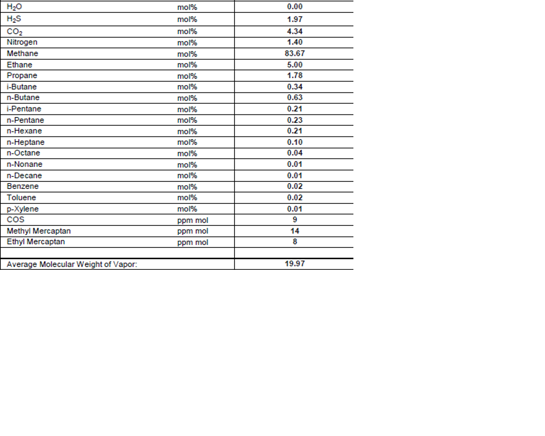

Dear All,
Thanks for your reply.
Content of flare Gas are as following : H2O, H2S, N2, Methane, ethane, propane, I-Butane, n-Butane, i and n-pentane, n-hexane, n-octane, n-nonane, n-decane, Benzene, p-xylene, COS, Methyl Mercaptan and Ethyl Mercaptan. Molecular weight of Flare gas is 19.97.
This is HP Flare. Pressure Drop allowed for Tip and seal is 4.5 Bar.
One note is written " Flare shall be provided with a smokeless flaring capacity equivalent to at least 15% of design load.
Please correct if I am wrong. I understand from above note that Smokeless flaring is required on and above 15% Design Load.
For above content whether smokeless flaring is possible without Blower or not. Please guide me.

Considering 19.97 Molecular Weight you are burning mostly Methane and (some) Ethane. Concentrations of other components seem to be negligible. It is hard to imagine that you would need any kind of assist fluid to ensure smokeless flaring.

RE: Smokeless Flaring Possible without Air Blower or Steam Supply
Please below the Content Analysis.
Is this flare gas composition relevant to all flaring cases, or only to the peak flow case?
What about max intermittent continous loads that may be due to a compressor shutdown etc?
Assuming this flare gas composition is relevant to continous intermittent case also, at 15% flow, tip dp would have dropped to 0.15^2 * 4.5 = 0.1bar = 1.5psi, which isnt much at all.
Maybe ask a flare tip vendor about this turndown limit with this flare gas composition.
But at peak flow, dont see a problem with smokelss operation.
At 2% H2S, the other question to ask the flare tip vendor is destruction efficiency for H2S - you may need to ask the plant owner what turndown is applicable to H2S.
