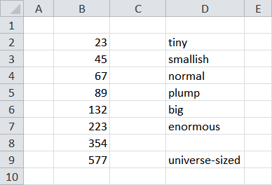

So for a spreadsheet like this:
You will get these kinds of results:
See how that works?
And as you might suspect, if you use the ug_read_list() flavor, items can be added to and removed from the list quite dynamically, and NX can respond to that. More on that in a second.

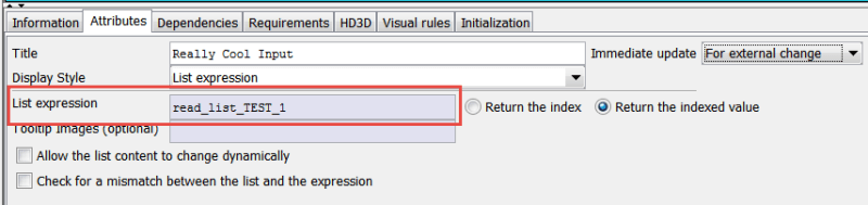

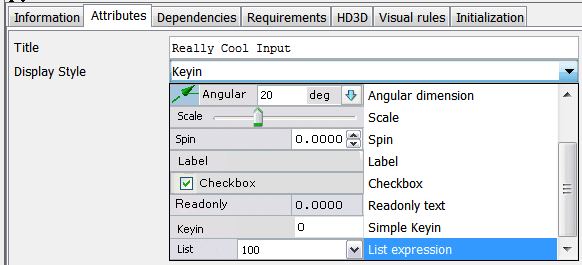

So, once you've got your lists from the spreadsheet into a List Expression, you can:
2. Inside PTS, use the new "List Expression" display style (at the bottom of the list.)
Populate the "list expression" field by dragging and dropping the desired list expression from the Model Explorer (the table with the eyeball on it) into the field:
And then figure out which other settings you want. (Including the usual "index vs. indexed value" question.) smile
Setting "Immediate Update" to "For external change" will re-ping the spreadsheet dynamically, looking for new values. Of course, there's a tradeoff here, as this will also ping ALL external sources referenced by parts in session (all referenced spreadsheets, Teamcenter Requirements, etc.) so this may or may not be a "heavy" operation, depending on how you work and where these files are located (native O/S, in TC, etc.)
And of course, you could also use this to pull a list of strings from your spreadsheet, and then drive your model logic based on the "index", just like you could before NX 9.
