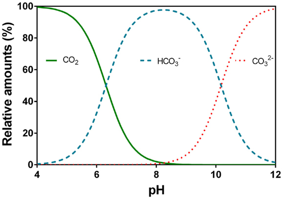

Hello,
I am working on a drinking water treatment project design which takes place in an African country.
The chosen surface water (and only available) is soft and very low in mineral content (very low alkalinity). Alkalinity is not enough for the coagulant additiv to be effective (generaly Aluminum sulfate). By working with the "Hallopeau & Dubin carbonic graph", I realize adding soda ash (Na2CO3) or lime would not solve the problem as we quickly arrive on the vertical part of the curves where pH rises but no more the alkalinity.
If I do the calculation properly (using the graph), adding soda ash or lime would allow me to use effectivly 25 mg/l aluminum sulfate. All additional aluminum sulfate would not have alkalinity to consume. I know by experience that in rainy season, I could need to use until 80 to 100 mg/l aluminum sulfate to reach an effective coagulation, so 25 mg/l is not enough.
All the ferric coagulants consume also alkalinity so changing coagulant additiv to a ferric coagulant does not seem to me a good solution.
Another alternative is to add carbonic gaz CO2 jointly with lime or soda ash, but this requires:
- supply of carbonic gaz; in deep african part, probably difficult;
- refregirated storage of carbonic gaz; in an environment where there is often power outage, risky;
- highly qualified operators which lack in that area;
Therefore it seems to me unappropriate to implement such process considering the above difficulties and risks.
Finally, I read it was also possible to mineralize water through slow carbonate dissolution using marine limestone but it seems this process is adapted to small treatment plants (500 m3/d maximum) whereas the expected treatment plant capacity in this project is 11 000 m3/d.
I did not find an appropriate solution to solve the very low alkalinity problem of this water. I would really appreciate if someone could help me on this !

If you look at the "Hallopeau & Dubin carbonic graph", one can see that the problem is caused by too much carbon dioxide. The solution is to either air strip the carbon dioxide or eliminate the carbon dioxide by reacting it with an alkaline material. The pH increases with either solution.
As to the OP's problem, the solution is to add enough alkalinity to raise the pH to a level that allows good coagulation and also to add enough alkalinity to mitigate the alkalinity loss caused by the coagulant.
The "Hallopeau & Dubin carbonic graph" is not really appropriate for what you are trying to accomplish.
If you look at the alkalinity equilibrium graph, you can see that if you add enough alkalinity so that the total alkalinity is 80% bicarbonate and 20% carbon dioxide, you would have a pH of 7, regardless of how much alkalinity is present.
Add any alkalinity that is economical, but do not add any more carbon dioxide. You already have too much.
