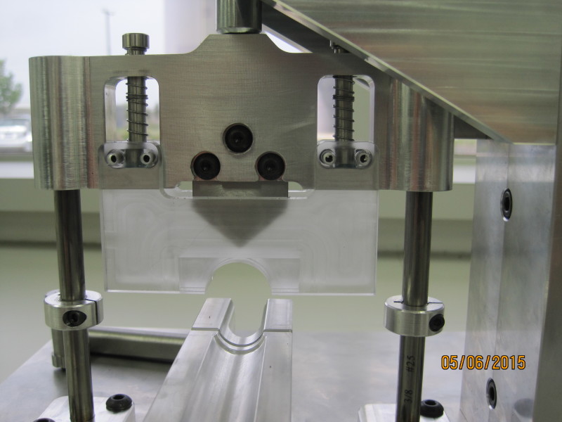

I have a plastic tube type part that I need to repeatedly and reproducibly section. The material is LLDPE Dowlex 2517. I am trying to design/build an automatic sectioning fixture so our operators/inspectors don't have to do anything but put part/s on this sectioning fixture and push go, and the fixture automatically cuts the part without distorting said part/s. I've been doing some pretty diligent research on the interweb and have been striking out. Have any of you designed or built any type of fixture like this? Or do you know anyone that does?

The part is just over 6.5" long, and has a diameter of 0.875" and needs to be radially cut about 4" down from one end.

Thickness is 0.075". Yeah there will have to be a saw or some sort of cutting device. I'm envisioning a two handed button type operation, punch press like. Safety is a key factor. I have to ensure that there is absolutely no way possible for a person to be able to touch any moving parts or blades. This device is going to be the first of many for me.

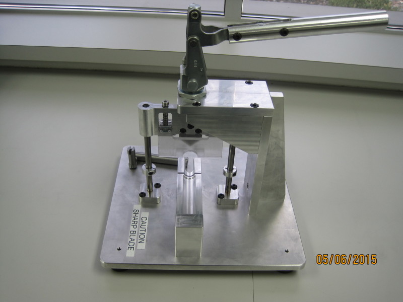

I think I am going to go with a guillotine type cutter for now...

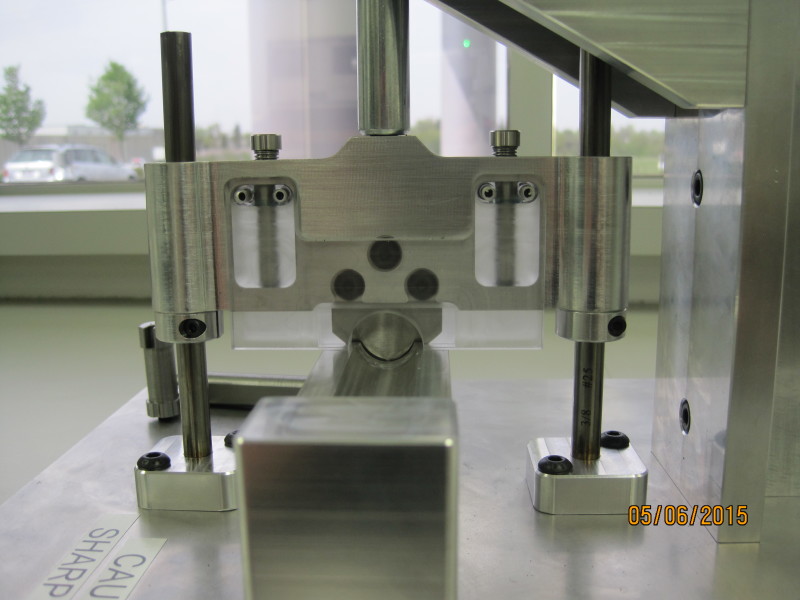

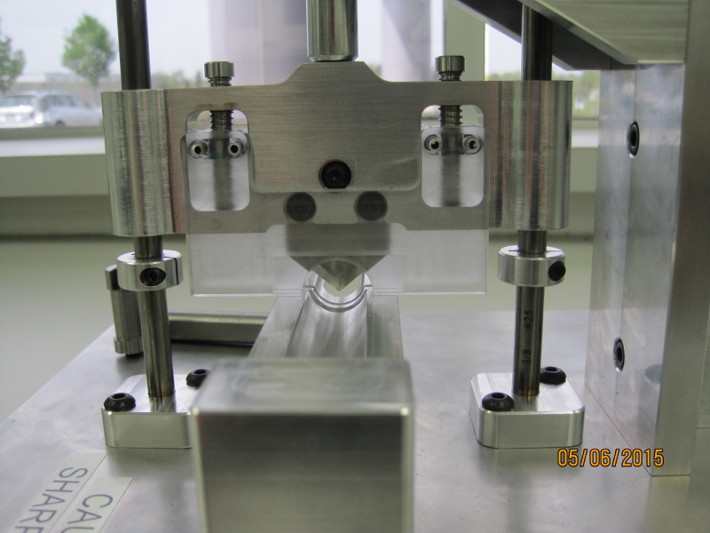

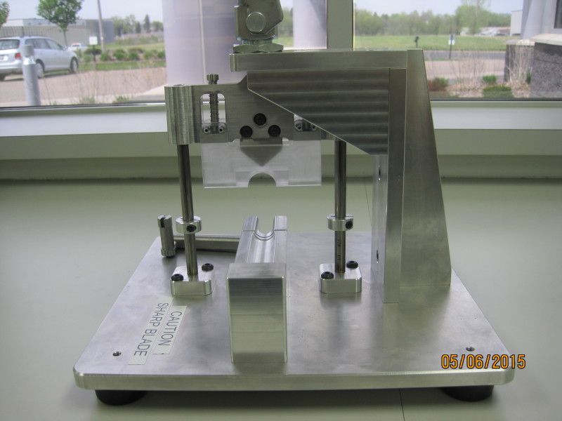

So this is the design my machine house and I came up with. I started with a concept on paper and this was the final design. I have some inserts that fit inside the part to keep it from crushing. I am getting a distortion free cut. It also cuts like butter, you don't even know the part is being cut.
