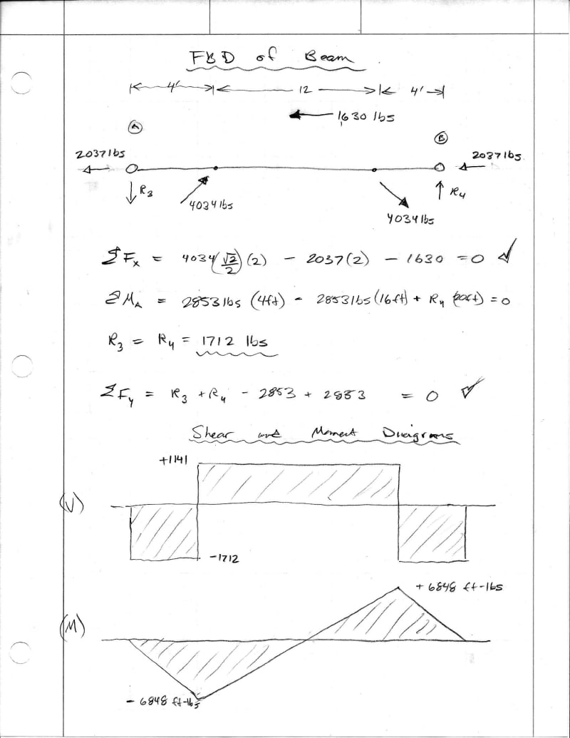

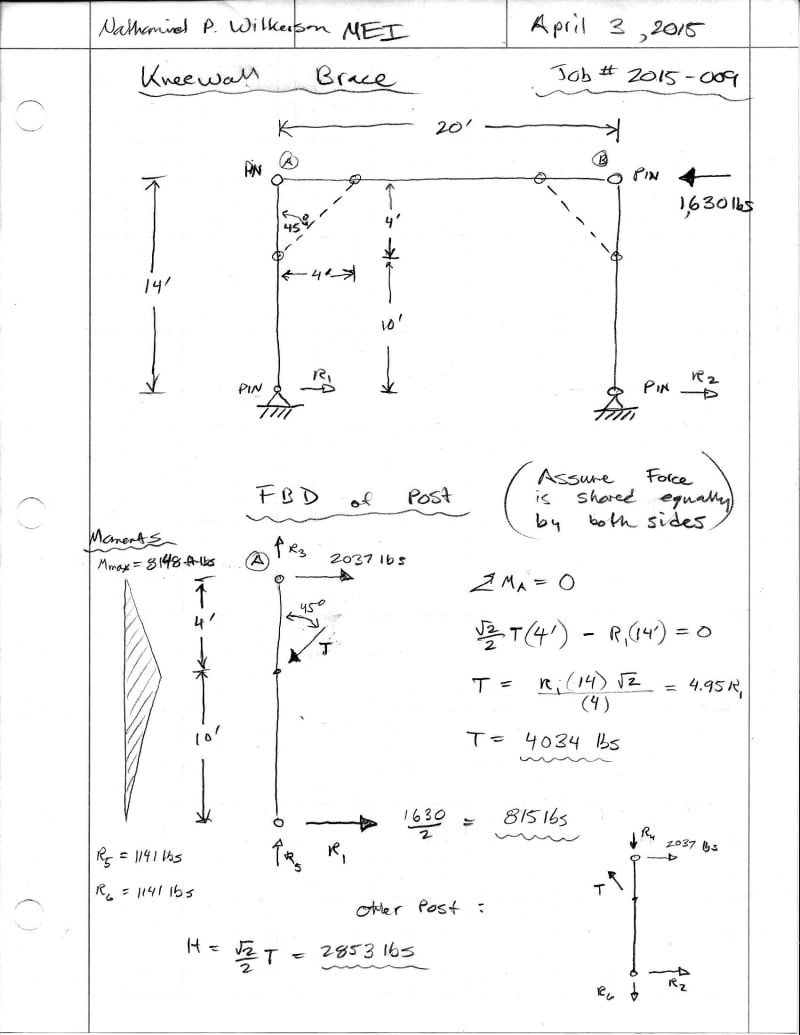

Everything seems to calc out okay until I get to the bending moments at the base of the central posts (see second to last page of pdf). The problem is I'm dealing with an "as built" so I can call out a 6x8 DF No. 1 post, I'm stuck with a 6x6 PT post that is probably a HF No. 2.
Current Spreadsheet and PDF output is here:
http://design.medeek.com/resources/postframe/
The ultimate wind speed is 155 mph (120 mph ASD) or 100 mph fastest mile. I've taken a reduction of .87 in the wind speed in order to bring this down to a Risk Category I building, which drops my ultimate wind speed to 135 mph.
Even so the combined stress on the 6x6 HF No. 2 central posts (windward side) are at 151% of the allowable.
What else more can I do to make this building work?

Assuming that the structure transfers the bulk of its lateral loads to the end walls (shearwalls A and B) and the post frames on grid lines 2 and 3 do not offer any significant resistance I get a shear load of Vw = 1630 lbs, which doesn't sound like a lot.
So I then run the following manual calcs to determine if a 4' diagonal knee brace will work on the one end wall:
The axial force in my knee brace is a whopping 4,034 lbs.
I then check to see what effect that might have on one of my 6x6 HF No. 1 corner posts:
As you can see it does not work, not even close.
The loads on the horizontal header would also require some beefing up of the gable end truss bottom chord but that can easily be arranged.
With respect to the knee brace and the corner post I don't think sheathing the knee brace will do much to decrease the bending moment in the corner post but I could be wrong. Any suggestions?

Number 3 and 4 were kind of the answer. My original analysis assumed a pin joint at the ground, this throws all of the lateral resistance onto the knee brace. In reality we have the two knee braces and the embededded posts resisting the lateral loads. When I tried to run the statics equations by hand using the pin/roller @ .7d modeling method things got too hairy for my liking so I put it into Risa3D:
Actually, before I ran with RISA, I first checked to see what would happen if just the embedded posts tried to resist the load without any knee braces and assuming 815 lbs at 14 ft off the ground I get a 11,410 ft-lbs ground line moment. That certainly wasn't going to work.
Anyhow, even with the reduction in moments and assuming a DF No. 1 post the numbers are still too high. Bending wise it comes in at about 98% but then if you add in the axial and calculate the combined stress index its about 170%.
However, putting it into RISA was a good idea since I got a deflection at the eave that manually I could never have reasonably calculated. The deflection is about 2.2", which is extremely large compared to the deflection of the roof diaphragm (7/16" OSB sheathing on 24" o/c trusses). So given that I can assume a rigid diaphragm and basically throw most of my calculations out the window...
The question is now do I really need any sort of knee bracing at all. The three other walls are fully sheathed with 15/32 plywood, plenty of shearwall and stiffness and no windows or doors.
I kind of wish I knew RISA a little better, I would probably put the whole structure into it and let it figure out what component (post, shearwall, knee braces etc...) is actually taking the lateral loads.
