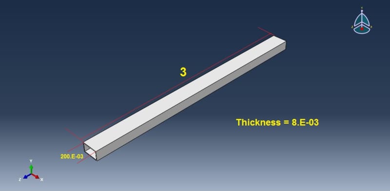

Created Beam part with details shown in image (1):
Image (1)

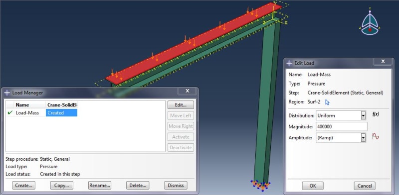

Load module:
Load configuration for this model shown in the image (4):
Image (4)

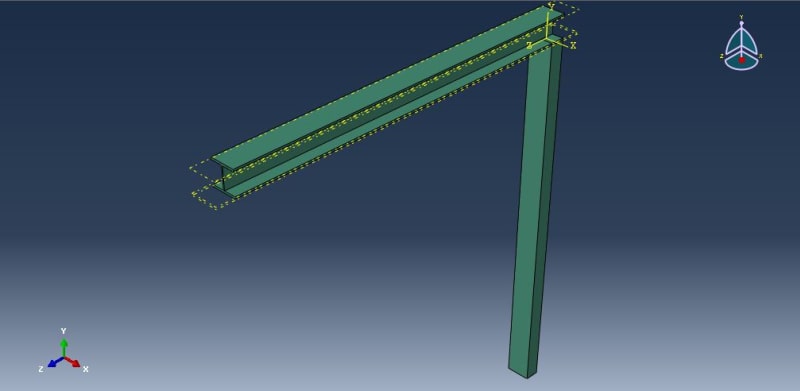

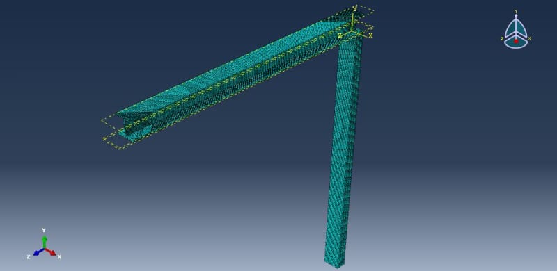

Mesh module:
All elements type is:
C3D8R: An 8-node linear brick, reduced integration, hourglass control
Image (6)

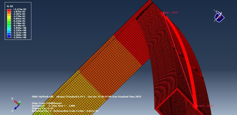

Now it's time to see the results.
Visualization module:
After the job done, click on the "Plot Contours on Deformed Shape (from above) choose "U" then "U2" now you can see bending of the model (like image 7).
Image (7)

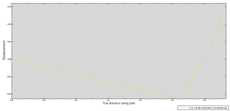

To get the bending graph use this structure:
1) Get to this address: Tools>>>Path>>>Create…
2) Enter the name then Choose "Node list"
3) Click on "Add After…"
4) From Viewport choose this tow Points shown in image (8)
5) After choosing, click on done button
6) In "Edit Node List Path" window click on "OK" button
7) Go to the "XY Data From Path"
8) Choose "your path"
9) Choose "Deformed"
10) Choose "Path Points"
11) Check "Include intersection" (with choosing this option you say choose the points between the two origin Points)
12) Choose "True distance"
13) Choose the last Step/Frame from "Step/Frame…"
14) Click on "Plot" button
Now you can see the graph (like image 9).

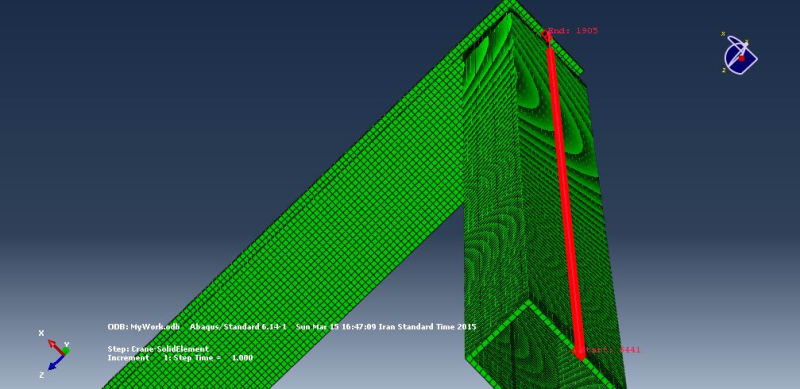

RE: How to get the moment in a solid element? Output request sf is not available for element type c3d8r
I’m trying to get a graph of the bending moment (N.m) and traction (N), from the beginning of the beam until the end, as is selected in the path created on the following image:
The path was chosen on the bottom of the beam.
Image (1)

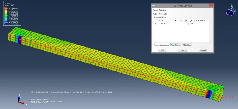

So I open the stress linearization window, and selected the path:
Image (1)
Which one of this components (img 3) I should to use to get the bending moment (N.m) on the beam? Actually none of them give me good results.
Image (3)

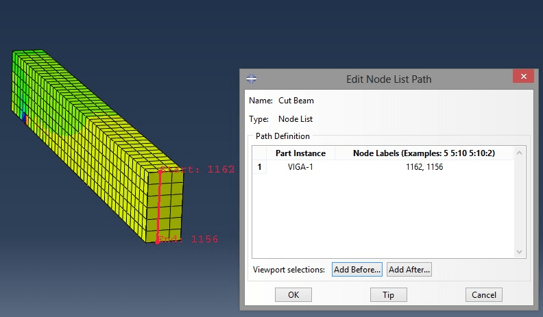

Do I need to created sections paths, as in the following pictures, to get the moment on the beam?
Image (4)
Hello again everybody
Sorry guys for my absent, in this days I'm a little busy.
To answer your question "Marquiavel" I should say "no" because it depends on your orientations.
If I add a boundary condition to the end of the beam like image (1), result will be change if you choose the U2 then you see the Beam Bending (With their proper values in the Up-Left), like image (2).
Image (1)
Image (2)

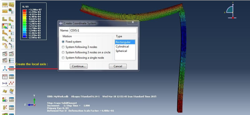

But if you choose the U3 you will be see the Column Bending (With their proper values in the Up-Left), like image (3).
Image (3)
Then your Outputs depend on your orientations (model, axis…).
If your model did not lie on one of the Global axis, then you can create a Local axis to get wanted results.
Image (4)
Yassou.
