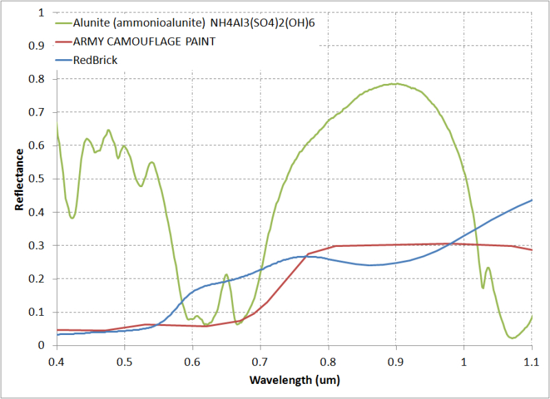

Below are some representative reflectance spectra. While some materials are not particularly distinguishable in the visible band, they do have spectra in other bands, such as LWIR or SWIR.

If your argument is that you could make a reflectance spectrophotometer which was able to identify a few pure substances, absolutely I'd agree. You'd do even better with transmission so you can get the dilution correct. You might even be able to detect some of those substances in some mixtures. But most everyday mixtures have reflectance spectra that look like those camo paint and red brick spectra, all the way from the far IR to the vacuum UV. A few hills here and there- maybe the odd notch.
