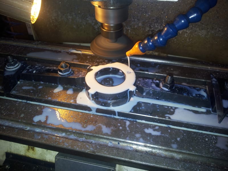

More shots of the real thing for your viewing pleasure. The rear of my BM has one of these - fine bit of kit. I now make the friction discs myself and get them chromemoly sprayed, I grind the friction cups too when rebuilding,
Im getting about 2yrs from a set of clutches made in house, lot cheaper than buying them from someone!!

Going to share in the big secret? Do the side gears load against the main casing or into the split housing? Just can't tell from your pictures.
RE: Question about clutch type limited slip differential
I'm not fully sure what you mean, but from what I think you mean the spider shaft displaces the dog housings against the clutch packs.

Is the thrust trying to force the side gears apart applied to the split housing or through the end of the gear to the main casing. This was only discussed for about 1/2 this thread.
I kind of missed that bit - the thread was a bit ''we've never seen the like of this type diff before'' which is what threw me and caused me to add images. The thrust is applied to the ''split housings'' via the spider gear shaft between them, and it trying to climb the ramps as it is turned, by the ramps.
I hope that makes sense.
Brian,
That still didn't answer the part questioned. Does the thrust of the side gears go into the split housing and clutch pack, or does it get transferred to the main case? It was theorized that the hub of the side gears is against a bearing between it and the case so the thrust went to the main case and also that the backlash of the side and spider gears is kept constant.
