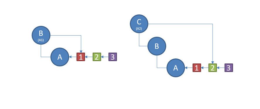

If you have a look at below picture
Assy A has been created with 3 arrangements and saved and released...nothing can be changed in there anymore.
Assy B is created where A has been added as sub assy. Assy B is telling A to show arrangement 1.
That information is now stored in Assy B, assy B is released and locked for changing.
So far this is working as is currently... No problems here...
Now I'm creating Assy C. There I want to add B as Subassembly, but now Assy C is telling to "override" B arrangement setting and tell A to show arrangement 2...
So I am not wanting to change any information in Assy B. I am only storing information into assy C such that, when it loads Assy B, it changes A to arrangement 2.
Think of it like the Override possition as used in constraints..that setting is also stored in context of the assembly..(if I'm correct).

RE: Sub assembly Arrangements
Your description and diagram is absolutely correct, the only point missing is that in your A/B/C assembly, 'C' has NO say in what happens to the Arrangement setting in 'A', that's the responsibility of 'B' only. And your proposed solution, which is pretty good BTW, falls into my second comment from my original response to you, which in essence describes what you referred to as the ability to 'override' what has been saved in the lower level Components:
"More likely, we would need to come-up with some totally new scheme to define these arrangement settings outside the Assembly's current structure that would be imposed on the Assembly, and its relevant Components (i.e. the sub-assemblies), when it was opened."
The issue is not, "can we do this" (you can do anything with software ;-), it's the fact that it takes time and resources and as I said, open your ER but we will need to see a broader interest than just a single user or organization asking for this before we could reasonably make this a priority for our R&D people.
