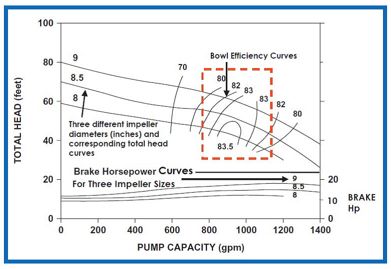

Pump efficiency is a measure of how much water horsepower is produced by the pumping plant from the input horsepower. It is the combination of three efficiencies:
1) Bowl efficiency - the efficiency of the pump itself.
2) Driver efficiency - the efficiency of the electric motor or engine.
3) Transmission efficiency - a measure of losses that occur in transmission shafts, chains, pulleys, and v-belts.
Pump curves provide three important performance relationships in one graph:
1) the relationship between pump capacity (gpm) and total head capacity to lift and pressurize water expressed in feet);
2) the relationship between pump capacity (gpm) and bowl efficiency (%); and
3) the relationship between pump capacity and brake (shaft) horsepower.
A pump performance curve shows a range of conditions where a pump can be expected to perform efficiently. The bowl efficiency of a pump can be expected to decrease if operated outside these parameters or as it wears.
Published pump performance curve with bowl efficiency, required pump input power and required net positive suction head.
For centrifugal pumps, the pump efficiency is the amount of work or power out of the pump compared to the amount of power put into the pump. As an example: HP out of the pump/ HP into the Pump.
Flow = gallons per minute of water as measured coming from the pump discharge.
Head = Measured at the discharge side of the pump. Negative suction heads are added to the pump discharge head, positive suctions heads are subtracted from the pump discharge head.
