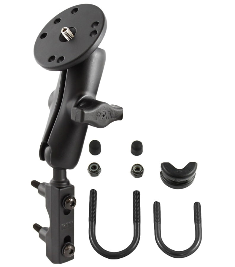

Does anyone know of a company that makes locking/friction fit ball joints for OEM applications? I need a ball-in-socket type joint, but instead of being free floating I would like it to either be lockable, or preferably, have enough friction to hold up a 1 lb load until moved by a human. Essentially I need an oversize GPS mount with threaded connectionson either end instead of typical mounts.
Any help is much appreciated.

There are 1001 products on the market that do something akin to "an oversize GPS mount".
Some are so simple that I'm sure a small amount of reverse-engineering would furnish you with an assembly you can use.

Quote (Sparweb)
You'd think that, until you start researching it. Very few have the features I'm looking for (friction fit w/o a separate locking knob, threaded terminations on both ends, OEM supplier, etc...). RAM mounts (as you've pictured) do come very close, but I wanted to see if there was anything else.
Obviously reverse engineering is a possibility, but I'd like to avoid it if I can. Its not worth the effort if an off the shelf solution exists.
