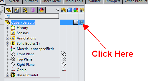

In answer to the above thread's original question: at the part level to toggle transparency of the entire part just click on the transparency column at the top part level of the Display Pane, as shown here:
Remember the display pane visibility can be toggled with F8
