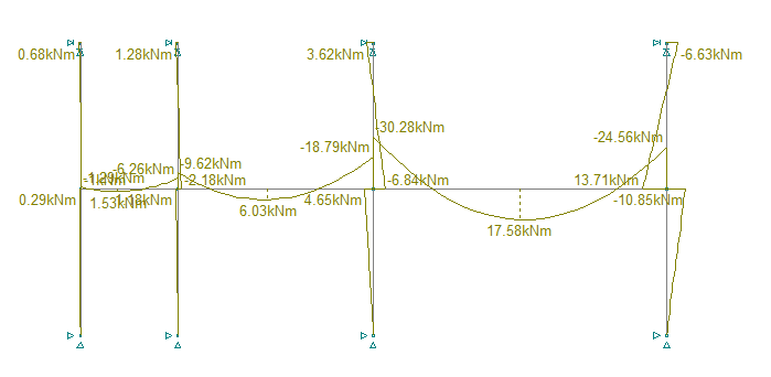

Something has been racking my brain today after looking into some column design. I'm trying to understand how column moments "flow" down through the floors down to the footings.
I understand how the unbalanced column-beam moments get distributed evenly above and below, but I'm trying to see how it all fits into the big picture. And for that matter how one can use the idealised frame method (sub frames) to work the column moment down throughout the floors.

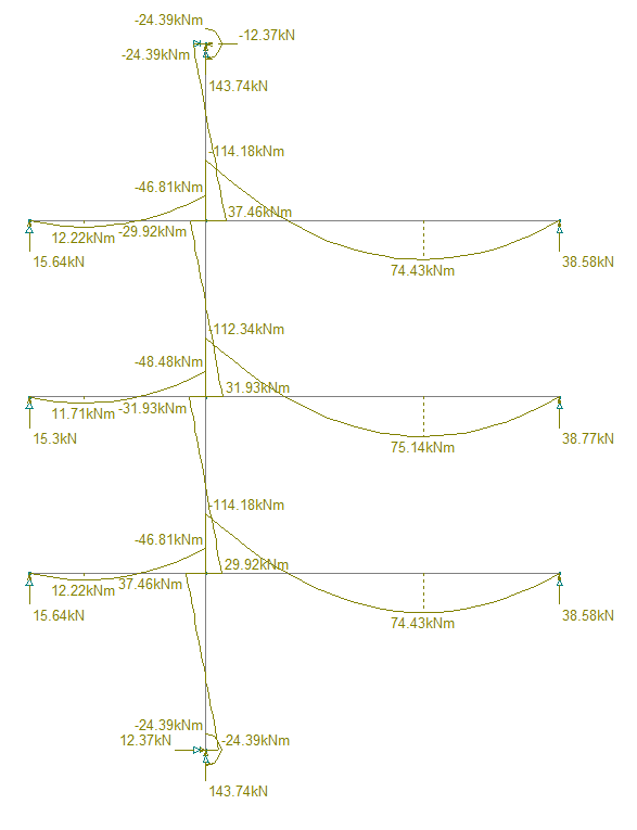

So I set up an example (as shown below). For simplicity EI is constant, beams are loaded with 10 kN/m. Left beam is 5m, right is 10m and floor to floor is 5m. Assumed braced structure.
I've been trying to draw free body diagrams but just can't seem to get the numbers (moments).
Anyone have a link to material that explains what I'm trying to understand/learn? Much appreciated.

This has always bothered me too, particularly in concrete. In a multi-story building with unbalanced -- and perhaps alternating -- moments coming in at the floors, you pretty much need a 3d model to capture it all adequately.
For the most part, I see columns designed using moments derived from the sub-frame analyses that you mentioned. That relies on the validity of the assumptions that are made regarding the location of column inflection points. In the case of floor to floor repetition and no unbalanced load casing, as shown in your diagram, a model with pinned supports at the column mid-heights makes sense.
The rabbit hole goes even deeper for steel relative to concrete. In steel, you'll have column splices about 4' above the floors every second story or so. Depending on how those column splices are designed, they may behave as pins for part of their load history.

Design codes allow you to use idealized sub-frame analysis based on the columns being fixed at the floor above and below (except at the opined footings!) for gravity loadings.
For any other loading you need to do full 3D with nominal reductions in member stiffness to allow for cracking/ stiffness loss. So these are not elastic moments, they are allowing for reduction in stiffness. So you may as well do that for the gravity loadings for the columns for column design as well, at least for combination with the sway effects. Probably should then use different values for gravity loading only as the same stiffness reductions may/do not apply.

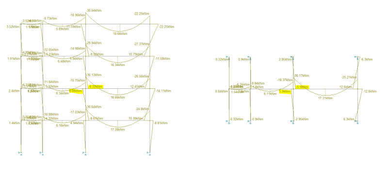

Ok - new example - comparing a full idealized frame model (lets say a nice one way slab and beam frame) with one of it's sub frames.
Observations:
Column moments are generally larger in the full frame model.
The ratio of the smaller to larger column moment will always be 2 in the sub frame, yet in the full frame it is generally less than that. I can see this affecting the determination of a short column.
Floor structure moments are generally similar in both cases.

This:
Quote (Trenno)
Is what leads some to this:
Quote (KootK)

I did not think I mentioned RC/PT factors.
Pin the column at the base of your sub-frame example (as you have in the full frame) and see if that has an effect. It should increase the column moment under the floor!
Also, is the frame braced or unbraced? Because your sub-frame is braced and it is very asymmetrical! PS I find it hard to believe the moments at the top of the ground floor columns! I would not expect the first floor column moments to be larger!
For comparison to the column below the roof, the sub-frame would have to be rerun with no columns above.
Yes if you want more accurate moments for slenderness design, a full analysis needs to be done. But the sub-frame results will be conservative in this case. How often in a multi-storey frame are columns not stocky, even using these conservative moments? If using the more conservative values from the sub-frame does result in a non stocky column and you are having trouble making the column work, go to a 2nd order full frame analysis!

Thanks for the help/response, rapt.
Pinning the base of the did increase both the largest span's max midspan moment and the columns above moment.
I agree with everything you have said above. I made up the frame to be very asymmetrical to accentuate the unbalanced moments.
As I said earlier I'm just trying to get a better understanding of how unbalanced moments in columns accumulate down through a multi-storey building - and thus not blindly be unconservative due to ignorance.
I think generally I will stick with the sub frame analysis (fixing each remote end of the column unless it's going into a footing).
