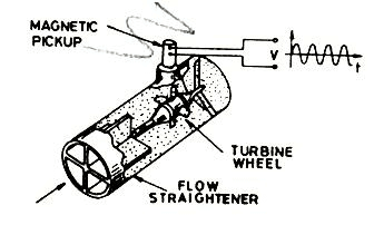

have a water softner which has a small processor. The resin regeneration process consists of a small motor which rotates a plastic cam shaft which, in one rotation, opens and closes various valves. The regenerating "cycle" is meter initiated,
Basically a 3/4 inch plastic "turbine" is living in the water outlet and a magnetic pick-up cable runs to the processor
and the small motor is started. I see the motor is stopped after one rotation by a micro switch. My question is how the
meter is starting the motor. Any help will be much appreciated. Thanks for reading.

Service personnel or homeowner sets water hardness level in memory, based on results of water analysis, also present time of day, desired regeneration start time, etc., etc.
Processor counts number of pulses from magnetic pickup & compares same against number stored in memory; number stored in memory varies inversely as the hardness of the water.
Once number of pulses has exceeded number stored in memory regeneration cyle will be initiated during the next overnight period when water usage should be zero to minimal; there is typically enough service margin remaining for the softener to last the balance of that day so its zeolite is not compeletly exhausted by regeneneration time.
More than likely the micro switch will be operated by a series of index notches on the periphery of the nylon cam wheel to bring it to rest one step at a time as regeneration proceeds.
Timing and duration of backwash / brine tank fill / regeneration / fast rinse / back in service is governed by processor programming.
Particulars of how processor initiates drive motor start will depend on manufacturer & unit design.

Basically the controller jumpers or bypasses the micro switch until the motor has rotated the cam far enough that the micro switch recloses. Then the controlled circuit opens and the cam is able to stop the motor at the correct position.

Symptoms reported so far suggest that a wire or printed circuit trace has cracked or corroded, or more likely, the turbine has become fouled or unbalanced, and no longer rotates freely.

Thanks for responding Mike, As far as why the unit failed in auto the answer may by your first
suggestion. As for the Turbine I tested it first by waving a magnet past the pick-up to test the cable and the led flashed to indicate flow. later while I had the unit in manual regeneration I opened some faucets and again the led flashed. so it seams that the pick-up/cable and the turbine are operating as they should?

I know nothing of these systems in particular, but the "turbine" description sounds like a turbine flow meter, so Bill's theory on insufficient flow makes a lot of sense. If you know for sure the flow isn't actually insufficient, then because the flowmeter is sending pulses or waves to a totalizer, it might be a loss of that totalizer value that makes the mP "think" the flow is insufficient. The first and easiest check to make is to follow that wire from the magnetic pickup and make sure that wherever it connects, there is not a build-up of corrosion or something obvious like that. Those sensors work on very very low signal energy, even the slightest increase in circuit resistance can render them useless.

Thanks for sharing jraef, I did catch Bill's comment on turbines and did follow-up. The blinking of the led flow indicator
did vary with the flow. I checked at low, medium, and higher, flow and the led varied accordingly and our normal water usage has not changed. I also removed the magetic pick-up to check/clean and all was free of any corrosion. All insightful input but as a very smart mentor told me many years ago, "there is always the 16 ounce ball peen hammer" ha ha, just kidding, so was he! Joe
