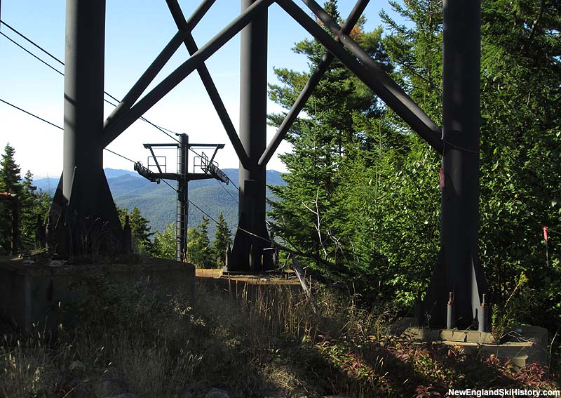

There was a time when ski lift towers used long spacers on their anchor bolts. These days I expect the installation spec might include a turn of the nut spec.
http://www.newenglandskihistory.com/lifts/NewHamps...
As I rode the lift I would impress my cute captive audience by theorizing the intent was to provide lots of fastener stretch to accommodate embedment etc and maintain preload. For some reason most skied off quickly to "catch up with their friends."
