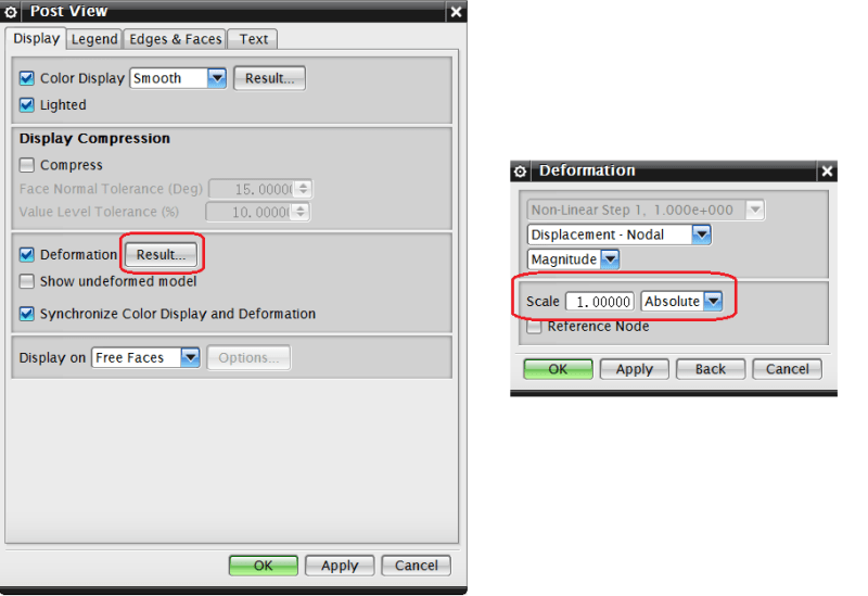

RE: advanced simulation
Hello Monopolystar,
The reason is simple. It is the default view plot setting for Solution101, that exaggerated the deformation of the simulation model for better understanding about the deformation shape. To further support my statement, you can check the overall displacement result, and the displacement magnitude should be very small...
To set the displacement scaling to actual, you will need to click the Edit Post View button, then check and set the parameter circled in picture below.
