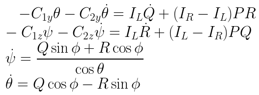

I'm designing a controller for rocket Pitch and Yaw control (aim is for rocket to remain upright, so zero pitch and yaw angles). I'm having trouble developing the dynamic equations and can't find existing material corresponding to my needs elsewhere. I've got the following non-linear dynamic equations:
I'm trying to get a transfer function so I need to linearize these. This is where my problem comes in.
The actuator that I will implement will be unable to roll-stabilize the rocket so the rocket is free to spin, and I want pitch and yaw angles to remain 0==> ψ=0 and θ=0. The problem is then that if I linearize around an equilibrium position where roll angle φ=0 and roll rate P=0, then the linear set of equation that I get is:
These contain no information about roll! Can you confirm that effectively pitch and yaw control is decoupled roll control in rockets?

The only way for the fins to induce a rolling moment would be if they are actuated in opposite directions. If they're adjusting for pitch/yaw, they are are not doing this. Minus tolerances.
Ditto gimbaled engines.
RE: Rocket pitch and yaw control question : is is decoupled from roll control?
In doing some reading, it seems that ever author is allowing him/herself to decouple pitch and yaw from roll, and from each other even, just as you described because they assume that the rocket is roll-stabilized so the situation of "super fast roll rate" will never arrive. In my situation, it is a model rocket and I have no interest in adding additional mass for an internal inertia wheel for roll control. I will work more on my problem and post back results. Meanwhile, if anyone has suggestions for attitude control of roll uncontrolled rockets reading (I've found none), please drop in a word.

2. In a model rocket, roll instability is compounded by the higher likelihood of aero surface misalignment causing a roll rate proportional to forward speed, and due to a low roll-direction mass moment of inertia, both in relative terms to full-scale orbital boosters.
Given 1 and 2, it is even more likely that an attempt to control yaw and pitch via ailerons, on a typical model rocket, is doomed from the start given the assumption that theta-dot remains below a threshold that causes the instability.
Do look at the "AIM 9" and/or "rolleron" entry in wikipedia, and/or search google images for the term rolleron. They are a pretty low-mass, self-actuated solution to the problem.
I don't quite understand what you mean after the "given the assumption that theta-dot..." as it seems to me like that very assumption is what would ensure that the control system works (given that we mean theta-dot is the roll rate).

So I've re-written the dynamic equations and simulated them in MATLAB. I attached a PDF of the equations as well as the 2 Matlab files you need to run the simulation. They seem to work well, but disclaimer : this is work in progress!
Now comes the linearization step, which I will report on once I do it. In the PDF of the equations, the notation is:
x,y,z = coordinates of rocket CG with x the roll axis, y the pitch axis and z the yaw axis. If the rocket is drawn upright on paper then x is up, y is right and z is into the paper, with the origin at the c.m. (Center of Mass).
ψ,θ,φ = yaw, pitch, roll Euler angles executed in that order.

Read the whole sentence, which starts with "Given 1 and 2", 2 being a statement that (for two independent reasons) in a model rocket, theta-dot is extremely unlikely to remain a small value once the fire gets lit.
