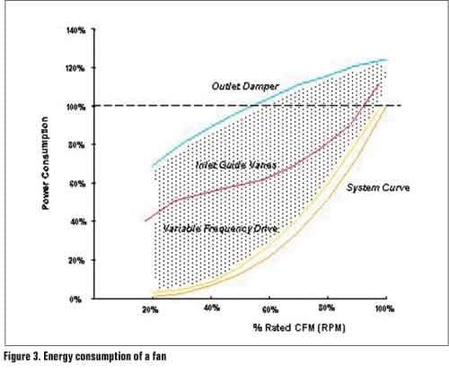

How a VFD can save energy is by reducing losses in a variable flow system from OTHER means of FLOW CONTROL. It is simply a more efficient way of accomplishing it. If for some reason a tank fill operation MUST employ variable flow input, for example to retain a specific tank level at all times within a narrow band and a variable outflow, then using a proportional valve and running the pump at full speed will consume more energy than running the pump at reduced speed to match the outflow. But using a VFD to replace a simple fill / drain on-off system is not a good energy savings plan all by itself.
By the way,
Quote:
Let's install a VFD and run the pump at half speed. Flow will be reduced to half ...
Therein lies the mistake most people make in this scenario. 1/2 speed does NOT equal 1/2 flow. Static head must be overcome FIRST. There is now way to directly equate speed and flow without knowing ALL of the dynamics of the system. I have seen many many marketing pieces, some from my own company, that make this equivocation error, but if you look at the data files behind the slick charts and graphs, you see that the Engineers who actually created them did NOT make that mistake, the energy savings charts clearly say FLOW, not speed, but the Affinity law used for the argument says SPEED, not flow. It's typically the marketing people who make the leap.
For example, here is an image of a pumping system performance curve showing a VFD vs a throttling valve.
In reality the VFD energy curve would likely have a straight line drop off of energy savings at around that 40% flow spot, maybe 30%, but usually no more than that, because for most pump designs that is the point in the speed curve where you no longer overcome the static head. So running the pumps with a VFD slower than that cannot offer any further savings, because if you don't overcome the static head, your fluid is no longer flowing and you are completely WASTING the energy. But the "belly of the beast" in most pumping systems is in the 40-90% flow range, right were the system efficiency is best using speed control. But you will see that if you look at 50% flow, it is roughly 25% energy, not 12.5% as per the affinity law for speed. This is more correct.
But compare that to this fan chart, where someone put in a parenthetical comment of (RPM) as if it were the same as CFM (flow), then used the affinity law RPM values on the X axis, not the Flow values. So if you extrapolate the 50% flow rate you see the 12.5% power consumption, but this is NOT correct. This happens a LOT and leads to a lot of confusion.
