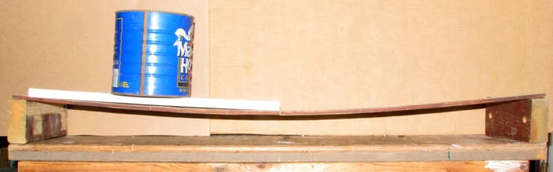

You fellows do come up with some interesting problems. Since I participated in the linked thread from years ago, was inspired to do a "science project" this morning. I modeled the current problem (not a software model in a computer... an analog model in my garage) smile
Below are photos of my 39" long, yellow pine beam.
The first is with no load: Deflection = 0", of course.
The second is a heavy load (can of nails) and on a stiff 19 1/2" beam: Midspan Deflection 1 19/32"
The third is the same load, plus the 19 1/2", beam at the midspan point: Midspan Deflection 2 1/4"
The fourth is a closeup of the two beams:
IMHO, rapt has put this into words better than I have seen.
Next step is to do the math and see if deflections are what they "should" be.

Very fine load test with great photos!.........however, this just demonstrates difference in deflection caused by different distribution of load........which you can see by referring to basic beam formulas (se Table 3-23 in ASIC Manual).
White board is not "sharing" load and does not reduce load that is being resisted by the main beam. Visually......picture supporting each end of the white board on blocking (which could be however high you want; and zero-weight relative to beam) and you should see this essential point.
Also.......picture the white board as being almost as long as the beam.........and you will then see deflection reduced to almost zero again.

Concept of "load sharing" is subject to shades of meaning and interpretation. However, in general, I submit that it means that load resisted by a member is somehow reduced.
However, for practical purposes......and as demonstrated (though with caveats noted below) by the simple though fine load-test illustrated above....the "board on top of beam" can be used to reduce deflection of, and bending moment in, the beam......... even though total load resisted by the beam is not reduced at all......and deformation of the two independent members is significantly different.
Based on standard calculations.........point load (P) at midspan of simple span causes midspan deflection that is 16-percent greater than midspan deflection caused by two equal loads (each P/2) placed at third-points of the beam.
As for the greater increase of deflection (compared to theory) that appears to have occurred in the above load test..........several factors are likely relevant ......including additional weight of white board (though that may be minor) and behavior of this specific wood beam. If same test is performed using several, more substantial (deeper) beams, deflections should average out to values resulting from standard calculations.
When length of "white board" member is equal to span of the lower beam........the 2 beams will share load similar to the condition for an upper beam oriented perpendicular to, and placed on top of, a lower beam. However, in such case, ends of the upper beam are supported by entirely different supports.

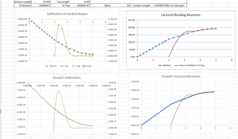

RE: Beam on top of beam, not connected, and of different length.
I see I was involved in the referenced thread as well.
The OP asks the question about a full length simple span beam with another beam on top extending only half-way across.
Assume the upper beam has some stiffness, and assuming that the load is applied to the top of the half-beam along its length and then applied to the top of the full beam along the remaining half-length of span, then there certainly would be some load sharing between the two beams.
But the actual behavior depends on the relative stiffnesses of the two beams.
Upper beam very stiff (i.e. rigid):
If the upper beam's stiffness is high enough, then the upper beam will be essentially spanning its length with one half of the load going into the end support and the other hslf load becoming a point load on the lower beam at its midspan point.
Upper beam very flexible (i.e. wet noodle):
If the upper beam is much more flexible, then it will tend to simply distribute the applied load down to the lower beam.
Upper beam somewhere in between:
The upper beam will take some of the load and deposit it at its ends like end reactions of a simple span beam.
But as the upper beam deflects onto the lower beam (i.e. the upper beam span-stiffness condition is lower than the lower beam) it will deposit some of the load through direct contact along some length at each end with varying degrees of pressure. There would be a gap - similar to SlideRuleEra's photos above - but there would also be a length of contact at the ends. A very complex problem.
I think it would be easily modeled in an analysis program with two beams and multiple joints along their lengths with rigid compresion-only links between them.

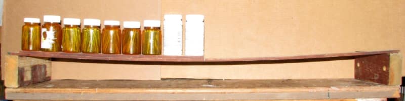

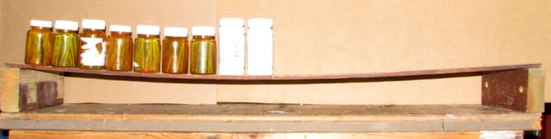

Ok, have finished the next analog computer run. Results indicate the "short" beam, covering the first half of the "long" beam does help:
First photo shows the stiff "short" beam putting two equal point loads on the "long" beam, one at x = 0, the other at x = midspan. Measured midspan deflection = 1.13" (Lower Bound of Deflection)
Second photo assumes a very flexible "short" beam (explained in my previous post) putting single point load at the "long" beam at the quarter point. Measured midspan (yes, midspan to be consistent) deflection = 1.59" (Upper Bound of Deflection)
Again, as above, to verify the analog model checked ratio of theoretical deflections (1.38) to measured deflections (1.38). Calculations attached.
I agree that this problem is surprisingly complex, but working with my analog has really helped to get a grasp on what is happening. Been a very fascinating day!

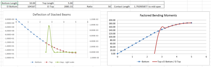

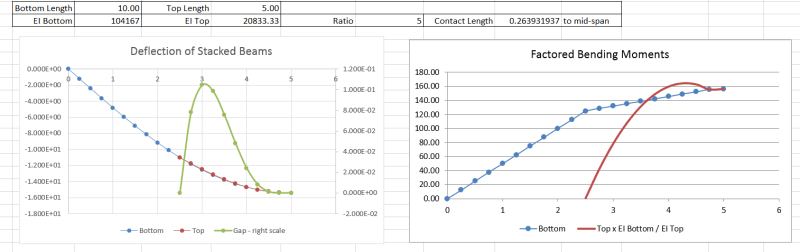

See the attached - close up of SlideRuleEra's first photo - note the flexure in the upper beam has created a measure of contact
across its end for a short distance. Then it lifts off the lower beam as its stiffness results in a lower deflection than the lower beam.

Hokie - I have carefully gone over your posts, including all other postings through today. Also have worked with my analog model to refine the input values. Bottom line... looks like KootK is on the right track, a similar sized short upper beam (no connections just sitting on top of the lower beam) does contribute to the load carrying, even with a uniform distributed load applied to it. Here are my analog results:
First photo: A single beam with UDL over half its length. Analog mid span deflection = 0.81" + 0.03" Theoretical mid span deflection = 0.80"
Note that I do not use a true UDL, but 9 equal & equally spaced point loads. I did the math, 9 point loads is better than 99% the same results as a true UDL.
Second Photo: Same long beam, with similar closely matched short beam spanning half of the long beam. Same UDL. Analog mid span deflection = 0.72" + 0.03"
Here are the detailed inputs:
Long Beam: 39" clear span, simple supports, I = 3.4 x 10-3 In4
Short Beam: 19.5" total length, I = 2.9 x 10-3 In4
Uniform Distributed Load = 0.317 Lb / In, It covers the top of the 19.5" beam.
Jfmann - Please see if you can confirm, or disprove these results. Then give us the numbers that your calculations reveal for the above inputs.

JFM, thanks for taking a look. I'll start with your 0.64" deflection and see if I can back figure what is going on with the analog system.
I did an error analysis on the model and was able to greatly improve accuracy, specifically by testing to get a better estimate for the two beams' moment of inertia. Also, helps that as time goes by I've had a number of occasions to solve problems using analog methods. Long ago, even had the opportunity to get a brief introduction to a "real" electronic analog computer - just before it was retired. They were very impressive machines and amazing to watch the results being drawn as a graph on a large X-Y plotter. Of course, they were no match for a digital computer, even then... except for rare, unusual problems. I'm beginning to believe that may be the case here.

I think you may be getting some composite action with your short beam. Would be interesting to see what happens if you grease it...may have to pin one end to prevent it sliding downhill.
Hokie - Your are probably right, since they were hand ripped they have rough surfaces. I had though about putting a sheet of poly between them. I'll be going by a lumber yard tomorrow, may stop in to see if they have something better to use as beams. What a place to go to get parts for your DIY computer.

Hokie - I'm pretty sure maximum moment is not as straight forward as wL^2 / 8. Based on my efforts on this thread, consider the sketch shown below:
Beam "L" deflects from two fixed end points, "A" and "C"
Deflection of Beam "T" exactly follows the deflection curve of Beam "L". Then things get more complicated.
One end of Beam "T" is fixed at point "A". However, the remainder of Beam "T" is not fixed. It's location dependent of how much Beam "L" deflects.

I have now satisfied myself that the way this works for an upper beam with a UDL is:
- There is a point contact at the ends of the beam.
- At mid-span they are in contact with zero shear and equal curvature.
- Moving away from mid-span they remain in contact with the UDL distributed such that the shear force and bending moments remain in the ratio of their flexural stiffness, hence the curvature of the two beams remains equal at any cross section.
- At some point the beams separate, such that the upper beam can have zero bending moment at the end, and the lower beam has a moment equal to the end reaction x the distance from the end of the upper beam to the support.
- At this point there is another point load transfer to maintain equilibrium.
I have modelled this behaviour in a spreadsheet, producing the graphs shown below. In the deflection graph (left) the red and blue lines show the beam deflections measured from the end supports (the blue line is hidden because the separation is very small). The green line shows the separation of the two beams (right hand scale), showing they are in contact for about 1 metre, then separate and re-join at the upper beam end. The bending moment diagram shows that the bending moments factored by the stiffness ratio (10) are exactly equal over the contact length, then diverge.
I have also uploaded the spreadsheet (see SSSpanU Example Tab), which uses the Excel Solver to find the end reaction, and uses a quadratic formula to find the contact length. But beware, it is very sensitive to changes in these two values, and needs a good starting guess, or it won't find a solution.
Doug.......certainly "A" for effort........though your analysis is off
First.......lets clarify that configuration being analyzed is for upper beam (length L/2) centered within span of lower beam (length L).....and for uniform load on upper beam only.
For more general condition length of upper beam could be different (within limits so as not to result in drastically different configuration that would not be applicable) and loading on upper beam could be whatever you want.
Taking your conclusions in order;
(1) At end of upper beam......clearly, at lowest theoretical limit of stiffness for upper beam (I-upper = 0)......and with I-lower > 0.......upper beam is in full contact along entire length of upper beam. For positive, but very low value for I-upper, some gap eventually develops. However, without at least some mathematical basis, there is no basis for claim that contact at end of I-upper is limited to point contact. In fact, for uniform load on upper beam ...and for relative stiffness used for your analysis (I-upper = (1/10) I-lower) there must be some length of contact at each end of upper beam, as discussed below.
(2) For specific case you are considering, there is contact at midspan.........but this is not always the case, as discussed below, and as discussed at length in previous posts.
(3) This appears to be key flaw in your analysis. Moment (and shear) in each beam is not proportional to relative I-values (stiffness is not correct term since stiffness is function of E, I and L) wherever curvature is the same; see below for explanation. However, your moment graph already proves that this is not the case...........since, where red line crosses blue line, graph shows equal moments at point where the beams are not in contact and therefore do not have same curvature.
(4) Zero moment at end of upper beam is not caused (as implied by your statement) by separation of two beams somewhere between end and midspan of upper beam. Moment at end of upper beam is zero since that is always the case at end of beam that is free to rotate. Your description of moment in lower beam is correct only for x = L/4 (at end of upper beam). However, there is no obvious meaning to such statement.
(5) Meaning of "At this point" is not clear. More important is lack of free-body diagram to demonstrate "equilibrium" of upper beam.........which is most important flaw in your analysis.
Since your deflection graph lists absolute values.........you must be using specific moment of inertia values for each beam (which is fine for spreadsheet routine)........however such limited analysis is of course not useful for understanding general behavior for this setup.
Sounds like your analysis is for I-lower = 10 I-upper.........which is same as I-upper = (1/10) I-lower.
Red line in moment graphs must be for upper beam (with M = 0 at left end).
Explanation that solution is "very sensitive to starting value" is strong indicator that your analysis is not quite correct.

For real-life demonstration of this behavior.......just review photos provided by SRE (above) which clearly show ......for point load and uniform load on upper beam.......continuous gap between both beams except at ends of upper beam.

I ran a SAP model as JAE and I recommended above: using rigid, compression only links. I've attached the model in case anyone would like to tinker with it. Here are the details:
1) There are three sets of plots below:
1a) Shear, which I believe to the the best indicator of contact zones.
1b) Moment
1c) The axial force in the rigid links.
2) Within each plot set, there are six cases:
2a) Uniform 30 kN/m load applied to entire length of upper beam. Ix_upper = 10 x Ix_lower.
2b) Uniform 30 kN/m load applied to entire length of upper beam. Ix_upper = 1.0 x Ix_lower.
2c) Uniform 30 kN/m load applied to entire length of upper beam. Ix_upper = 0.1 x Ix_lower.
2d) Concentrated 150 kN load applied to center of upper beam. Ix_upper = 10 x Ix_lower.
2e) Concentrated 150 kN load applied to center of upper beam. Ix_upper = 1.0 x Ix_lower.
2f) Concentrated 150 kN load applied to center of upper beam. Ix_upper = 0.1 x Ix_lower.
3) Lower beam span = 10m; Upper beam span = 5m; 1.0 x Ix_lower = W18x35, 50 ksi steel.
My conclusion: there only seems to be a narrow band of relative stiffnesses where the interaction is very complex. If the relative beam stiffness ratio exceeds that range, the upper beam simply ends up simply supported. If the relative beam stiffness ratio is less than that range, the upper beam simply serves as "blocking". All this would seem to be pretty consistent with a lot of people's intuition here.

I have modified my spreadsheet (copy attached), and it is now much more stable, working with a wide range of relative beam lengths and beam EI values. The procedure used is now:
Assuming two beams, the top one shorter than the bottom, arranged symmetrically about mid-span, with the top beam subject to a UDL of its full length.
- Check if the beams contact at mid-span. If they do not, or if it is a point contact, find the moments in both beams from statics. If they do contact over a finite length:
- Find the total moment at mid-span from statics
- Distribute this moment in proportion to the beams EI values.
- Assume some contact length, symmetrical about mid-span.
= Starting from the mid-span moments, find the moments in both beams at the start of the contact length
- Calculate the point force transfer at the start of the upper beam required for static equilibrium with the calculated moments.
- Find the point force transfer at the start of the contact length required for overall static equilibrium.
- Apply these loads to both beams assuming point contact of the ends of the upper beam on the lower beam. Calculate the difference in deflection at mid span, relative to the ends of the upper beam.
- Adjust the contact length until the difference in deflection is zero.
I have set up the spreadsheet to use the solver, but if you don't have that activated you can also use the goal-seek function. You need to make cell L13 equal to zero by adjusting cell L2.
The spreadsheet works on the assumptions listed above, but it will work with any UDL, any ratio of beam lengths up to 1:1, and any finite ratio of EI values.
Using this spreadsheet with a range of values supports what I have said previously; assuming both beams have finite EI, and the top beam is shorter than the bottom:
- If the top beam has an EI greater than some limiting value then it will span between contact points at its ends, with no other contact.
- For any non-zero EI lower than this value there will also be contact over some length, symmetrical about the mid-point of the beams.
- The contact zone will increase in length as the upper beam EI reduces, but it will never extend over the full length.
- The pressure distribution over the contact length will be a fixed proportion of the applied UDL, such that the shear force in the beams is in the same ratio as their EI values.
- In addition there will be a point force transfer at the ends of the contact zone to maintain static equilibrium.
The graphs below show deflections and factored bending moments for a 10 m lower beam, 5 m upper beam, with a range of relative EI values (lower/upper = 5, 50, and 500).
http://interactiveds.com.au/images/Stacked%20Beams...
Doug Jenkins
Interactive Design Services
http://newtonexcelbach.wordpress.com/

For the stiff upper beam I agree, but for the lower end of the range, as shown above, the contact zone never extends over the full length, there will always be a finite length of separation over which the beams can have a different curvature. In your case with the top beam resting on the left half of the lower beam the contact zone will spread out from the left hand end (where they both have zero moment), and the gap will be at the right hand end only. Other than that, I think your results are in line with mine.

Spreadsheet results compared with a Strand7 analysis using contact elements with friction set to zero:
Frankly, I'm amazed the agreement is so good.
All Strand7 results are directly from the output, other than the upper beam moments, which are multiplied by the EI ratio (10).
Doug Jenkins

It's also instructive to look at what happens from first contact, as the upper beam EI is reduced. Using the example of the upper beam half the length of the lower beam, symmetrically placed about the centre, with a full length UDL.
The upper beam first touches the lower when its EI reduces to 1/2.4 of the lower beam. At this stage there is no load transfer at midspan, and the upper beam moment is half that of the lower beam. Its EI is less than half, so its curvature is greater, and there is only a point contact.
The point contact continues until the EI factor reduces to 1/4. At this stage 20% of the UDL is transferred to the lower beam, the lower beam moment has increased, and the upper beam moment reduced such that the ratio is 4:1, so the curvatures are equal.
Any further reduction of the upper beam EI would further increase the curvature of the upper beam, but it is constrained by the lower beam, so the point contact spreads to a contact over some finite length.
From this point the contact length increases as the relative EI of the upper beam is reduced, as has been described before, but so long as the EI is greater than zero there must always be some non-contact zone at the ends of the beam.
Finally it should be said that we are talking ideal beams here, and the gap size as the contact zone extends is tiny. In any real beams the deviation of the beam surface from a smooth curve would result in multiple point contacts, rather than a single contact zone with two well defined gap lengths at the end. Also the "point contacts" would also be "small area contacts", because a point contact would result in infinite stress.

John - yes that is what I am doing, but no, it isn't arbitrary, it is the only way to satisfy both equilibrium and compatibility.
Over the length of the contact zone compatibility requires that the applied load over any length is distributed to the two beams in the ratio of their EI values. If the applied load is uniform, the load transfer between the two beams must also be uniform. This leaves a force to be transferred to maintain equilibrium. It can only be transferred where the beams are in contact, but it cannot be transferred anywhere within the contact zone, so it must be applied at the ends of the contact zone, where the curvatures of the two beams, moving away from the CL, start to differ.
This is only exactly true for our ideal beams. In real beams there will be some local deformation so that "point" loads are distributed to bring the contact stress down below the yield stress. There will also be some transverse strain which this analysis ignores. Curvature of the two beams will be exactly the same at their contact surface, but the curvature of their neutral axes will be slightly different. But this non-linear behaviour is equally true of a point load at mid-span with no contact length.
For my last quoted example I used a 10 m lower beam and 5 m upper, so the total contact length was 2.0204% of the upper beam length. I used a lower beam EI of 10,000 kN.m2, but this does not affect the contact length.
Doug Jenkins

For your second example my spreadsheet gives:
Top moment/Bottom moment at both locations: Exactly 0.23 (to machine precision)
Gap at both locations: 0.000% of total deflection (1.09E-14 m at both locations to be exact).
Contact length = 4.083% of upper beam length
Contact pressure = (1/0.23)/(1/0.23 + 1)
Point loads at end of contact zone = WL/2 x 0.19495
Entering your loads into my spreadsheet I get almost the same moments as you (differences in the last S.F.) and a gap of -0.28% and-0.27% at the ends of the contact zone and mid-span (i.e. the top beam is calculated to be below the lower beam).
Similar findings for the first example, but the difference is less because the contact length is less.
Doug Jenkins
