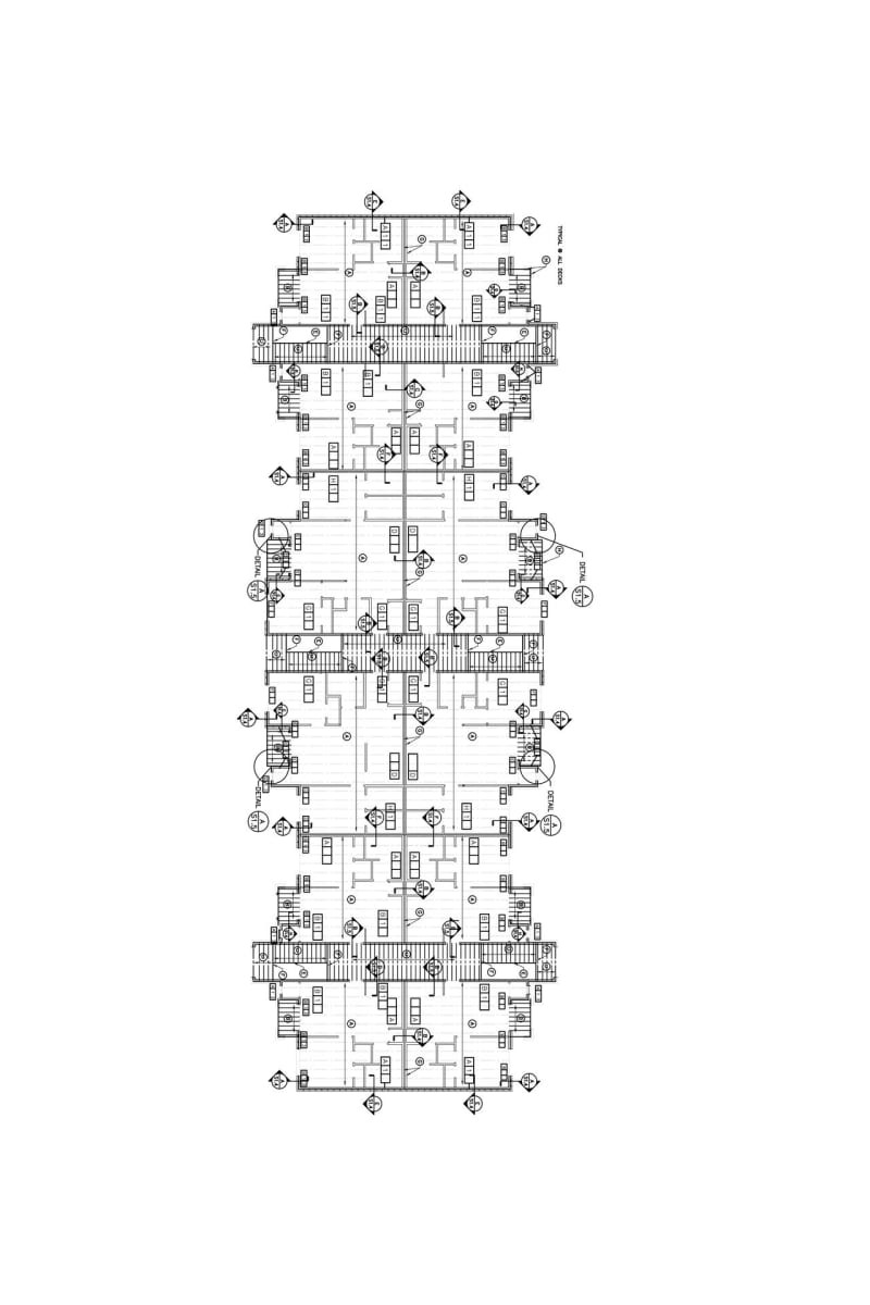

pfft, that's not even half of my concern now, I was doing the wind analysis by hand and I don't know if my numbers are very off, but even the exterior walls on the third floor do not provide enough shear resistance (most sections are less than 2') and I was thinking on how to approach it, I don't know if it's permitted to have the single interior shearwall take the whole hit or do i extra-reinforce the ext. walls even if they don't really pass by either strength or service, this a regular 3 story and 4 story building [I attached the plan so you can have a look].
The architect restricted us to 2x4's, the ext. walls are already overbearing, the first floor is (3) 2x4's at 12", One of my coworkers said I should run the thing on Woodworks and have it design it by it, but still I'm hesitant on how it could differ so much from my work. I was using TEDDS to do the shear wall analysis/design (either perforated or segmented) but i don't really trust that thing.

Yeah, for this, I would take it all down the middle. That's how it'll tend to behave in my opinion anyhow. I know that there are other members here who will likely disagree with that approach however.

As much as I don't like it that's likely how I would do it as well. Hope that there is enough capacity on the central wall.
Although can you when you're obligated to consider it a flexible diaphragm?
RE: Hold down for a bearing wall question with contiguous shearwall?
The method only works if the diaphragm is assumed/proven to be rigid. I view it as another permutation of the three sided building really.

The funny thing is that the Corridors (where the beams C run across) are not to be sheathed (you know architects), although in my office they want to model it as a single building I must say it would act like two different blocks and an allowance for the kick (or ram, not sure how you call that the collision of bdgs due to displacement) must be taken into account unless bdg is extremely rigid. This thing is not even complicated at first glance but it's giving me a headache already.
And then they are not to use sheathing in ext walls, they just expect the gypsum to do all the work. I wouldn't live in this bdg even if i was paid to.
