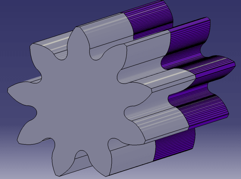

I created a CAD file to simulate a rack cutter generating a gear, and also an Excel file to output the tooth data.
What I have discovered is that its possible to have two sets of input parameters, which produce exactly the same gear!
Okay, there might be a tiny bit of difference in the root area, but that's in the clearance zone anyway.
The image below shows two gears generated with completely different data, yet they're identical.
[img ]
The purple is obviously generated by the rack cutter simulation, with the data, Module 2.0, 20° deg P.A, 0.295mm offset.
The grey one is from my Excel file, with Module 2.11111, 27.105° P.A, 0.0 offset
I know the Excel data is completely random, but does it not show that gears don't necessarily have an absolute identity?
Does that mean the same gear can be referred to in different terms?
I guess there are application where for example gears don't need to adhere to conventional manufacturing methods, such as EDM manufactured gears, so in such cases do people still try to stick to whole number Modules, or is it okay to create totally random gears if the required application demands it?

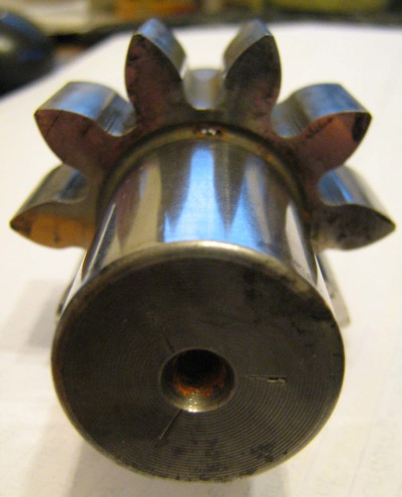

I ended up measuring tooth thickness at various displacements from the gear centre using a DTI and milling machine for indexing, then plotting these co-ordinates on CAD, and then driving the best fit involute through the points.
Having the added bonus of the gear pump body at hand to measure the actual centre distance, I was able to use this as a means to check my measured involute. I was surprised how accurate the best fit involute method turned out to be, within a few microns.
This is a gear pump gear so as such I didn't know if it would follow normal gear conventions, and measuring the O.D. at Ø23.25 seemed to confirm it is a bit random.

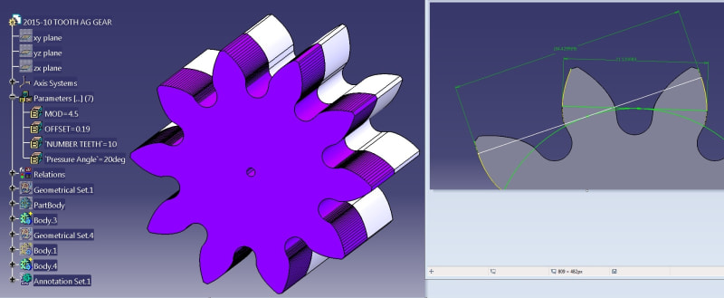

Since the curve generated at the root isn't really a true radius, how is that area of the gear actually inspected?
I haven't come across any information throwing any light on inspecting this area.
As you can see in the attached image, even a sharp corner on the cutter generates a rough curve,
so how on earth do you verify from inspection what rad the cutter tip had on it.
I realise you can assume it was a standard, but surely there must be a way to verify it nevertheless?

WRT to the cutter radius, you could make a replica of the tooth root you wish to measure,
section it, and examine it under a microscope, perhaps with a template in the optics,
or just looking at the end of a gage pin placed adjacent the replica.
Even in your CAD system, at some point, starting with a zero corner radius on the cutter and steadily increasing it,
the gullet produced by a single tooth pass will eventually be shallow enough to not resolve on your screen, and a real cutter's
mark will be indistinguishable from a scratch.
Beyond establishing that the cutter had enough of a radius to not leave a terrible stress raiser,
well, why should you care?
Example: The Gleason system generates compound curved hypoid teeth using straight sided cutters,
of generally trapezoidal shape, with a modest edge radius between the three cutting surfaces.
You can see the tracks of the individual cutters in the tooth roots of the finished gears.
Nobody cares.
Mike Halloran

You seemed to be asking about the generating cutter's corner radius,
and I told you one way to measure it. You could also get the information from
a sufficiently fancy profilometer.
The tooth root radius is different. You can measure it differently.
For instance, to check for a radius of 0.6mm, you can
lay gage pins of 0.5 and 0.7 mm radius in the root and watch
how they behave. The pin of smaller radius will roll a bit,
touching the root on one line, whereas
the pin of larger radius will touch the root on two lines,
and will not roll. You can verify by touch or optically.
You could even use one of them damn CMM machines to extract the tooth root radius.
Mike Halloran
Pembroke Pines, FL, USA

It's actually not made up.
Here it is.
[img ]

As you can see, is quite unconventional, and like you say, with an unconventional profile shift.
I don't understand why people automatically presume things are conventional.
I would tend to presume the opposite to be true, and thereby help ensure something incorrect isn't created purely as a result of presumption.

So is all the 10-teeth gear data that you have supplied taken from this sample?
RE: IDENTIFY A GEAR
Yip.
The 24T gearbox stub tooth mentioned further up the thread is another real example.
RE: IDENTIFY A GEAR
That gear looks like it's the driven member of a hydraulic pump.
Typically; 22.5 deg pressure angle is used in this application.

I created the gear in CAD directly from measured data, then simulated a rack cutter operation, both to the same specifications, and both overlay perfectly, with no impact on the O.D.
You can see the specifications in my parameter tree. (I just created the fillet in the purple manually, i.e.not part of my simulated rack cutter).

RE: IDENTIFY A GEAR
Quote (MRSSPOCK)
Could you explain how the O.D. is dependent on profile shift?
That's not very difficult: Addendum = M * (1+x-k)
"x" is the profile shift, "k" stands for shortening of the addendum - not applicable in your case,
and OD = PD + 2*Addendum
RE: IDENTIFY A GEAR
