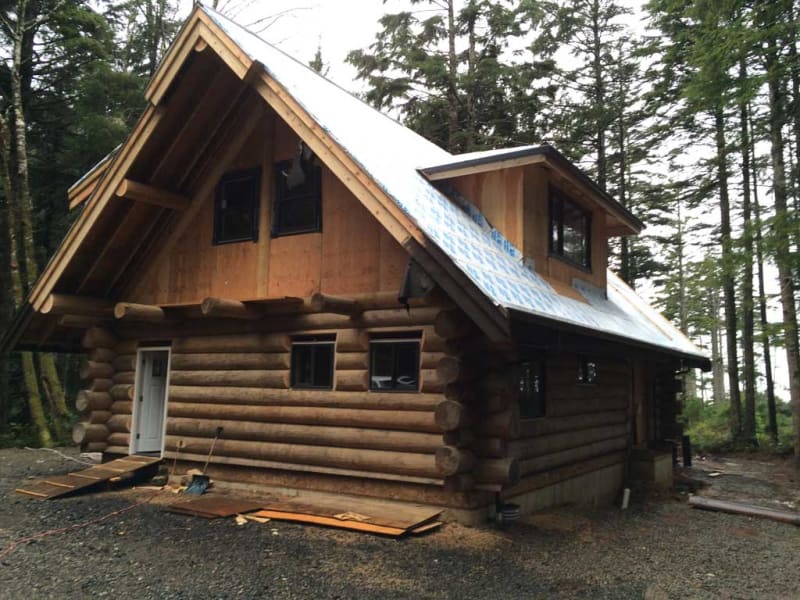

Starting work on a a 4'x7'x24' CMU chimney with two flues. Does anyone have any suggestions or resources they would recommend? My biggest concern will be lateral loads due to seismic, the dead weight of the CMU stack will be rather substantial.
This chimney is for a traditional log home, not your usual stick frame construction. Even though the chimney will be attached to the wall I don't yet know how much lateral bracing I can or cannot assume from this connection. The additional lateral load to the log framed shearwalls is probably another factor worth considering and I'm not sure the original engineering took this into consideration. Another major issue is the settling of the logs and the differential movement this creates in the wall relative to the chimney.

I would have to see the proposed placement in plan wry the existing walls to comment on the lateral. As for the settlement, if the structure has been in place for two years, most of the 3 to 6 inches of anticipated settlement should have occurred already.

As you can see from the picture it is brand new, they are about to put the roof on. I was quite impressed with all the measures in place for settlement throughout the structure, jacking screws at the posts, 4" of clearance above all the windowss and doors and even interior partition walls have special screws/ slots for gyp. board etc... in place to deal with the projected 4"-5" of settlement.
Thank-you for the reference in the IBC Woodman88, that will be the first thing I review before getting too involved in this project.
Originally the chimney was to be stick framed with a cultured stone facade, however the owner decided he wanted a "real" wood burning fireplace. Fortunately, he made this decision prior to pouring the footing, so he does have a fairly substantial footing under the fireplace footprint (11'x8'x18"), which calcs out for a little over 100,000 lbs of dead load at @ 1500 psf. However, the masonry and engineering was not part of the original plan and engineering. This one is going to be interesting and challenging.

Manstrom I would tend to agree with you but the client has already been told by another engineer that he would need to have ugly braces off of the roof helping stabilize the chimney and that they would need to somehow allow for the shrinkage of the logs etc...
My first thought when he described what he wanted was to engineer the chimney and its footing as a freestanding column. From the bottom of the footing to the top of the chimney will be approx. 32'.

I would make it freestanding, isolated from the wooden structure.

I agree with Hokie66 - make it free-standing.
The space over the windows & doors is intended to accommodate shrinkage of the logs. 6 logs losing 1/4" each due to shrinkage adds up to 1.5". This also means that the roof will be at least that much lower as time goes on. The foundation for said chimney will also settle as you load it up with the CMU/stone as well as some soil settlement over time.
Connecting the chimney to the structure (or vice versa) would be foolish as it will lead to problems in the future. Detail all connections between the chimney and structure such that they can accommodate some differential horizontal movement and a lot of differential vertical movement.
