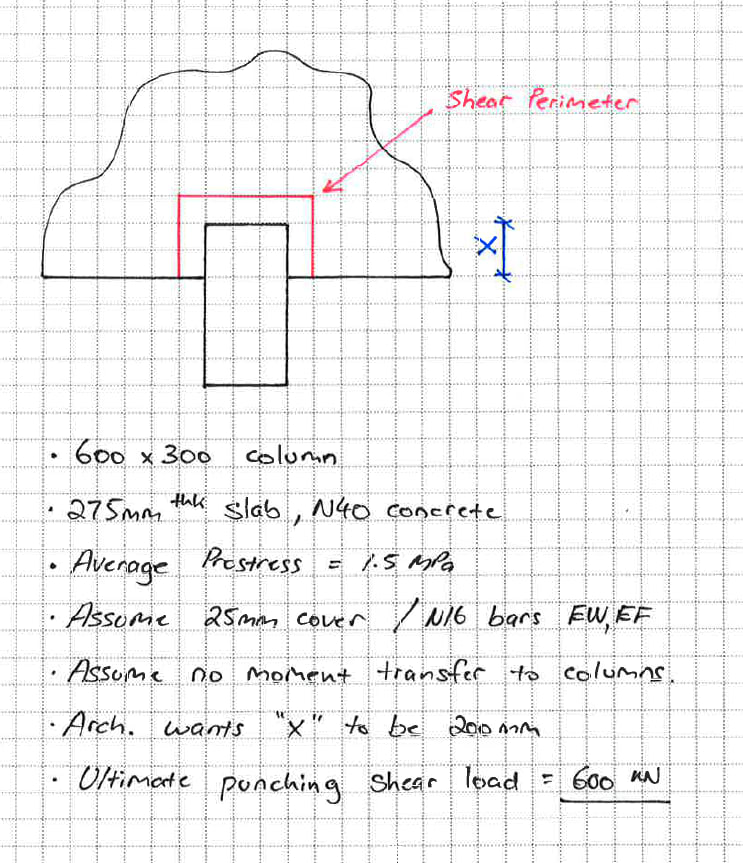

Hi all,
I'm trying to find ways of making the below detail work.
I'm using AS3600 currently, but am definitely open to other code's justification. I know we are pretty conservative when it comes to punching shear.
At this stage the Arch. is aiming for "X" to be 200mm, however I can only seem to squeeze 400kN punching shear capacity out of the configuration below.
Does anyone have any suggestions or point me towards material that can help me justify the smallest possible "X" dimension?

What are the magnitude of spans and loadings?
My guess is your 275mm slab is based upon your shear issues, or are your spans large too that results in 275 (deflection and flexure)?
Also, be careful of using your average prestress values in your punching shear equations for edge (and corner) supported column where the P/A is not fully developed.
And 'kick' the architect in the head too...
RE: Partially Connected Column & Punching Shear
I will go further than Ingenuity and suggest that you ignore the prestress completely. You will need sufficient reinforcement developed to the back of the column to transfer the moment to the column. With 300mm wide, I doubt that you can get it in there!
I would be insisting on an edge beam to tie the whole thing together.
PS you cannot "assume" no moment transfer to the columns. It is there and the only way it will go away is if the column connection fails and that is a brittle failure so no zero column stiffness assumptions are allowed!

All fair points and duly noted.
Spans are roughly 8.5m each direction for an office environment.

Damn architect's. That connection would feel better with a 300mm x 300mm bearing area as a minimum.

This needs an edge beam, or a beam in the other direction. Architects can't dictate everything about our structures.

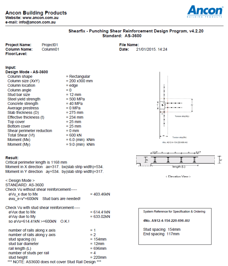

Asixth, this is what the shear rail option would look like...

I still do not see how you can fit any decent top reinforcement into the column. The gap between the column bars is a maximum of 300 - 50-50-25-25 = 150. You can probably fit 2 bars between! And they have to develop fully so they cannot be large bars. For 8.5m slabs, that is not much tension force!
Also, your studs are at 154 spacing with a depth of 220. Hope someone tells the concrete the shear failure plane has to be at 30 degrees or less.
And you have ignored the applied moment from the analysis. That has to be included. Even your Mmin is wrong as it is based on a 200 long column, not 600.

I'll look into the stud rail formulae and calcs to see if the design requires the shear crack to cross all four shear studs. Maybe there is some sort of assumption worked in that explains this. But I do agree with you, seems weird it would detail them like that.
The crack only needs to cross one stud. I see no problem with 220 long studs spaced at 156 o/c.

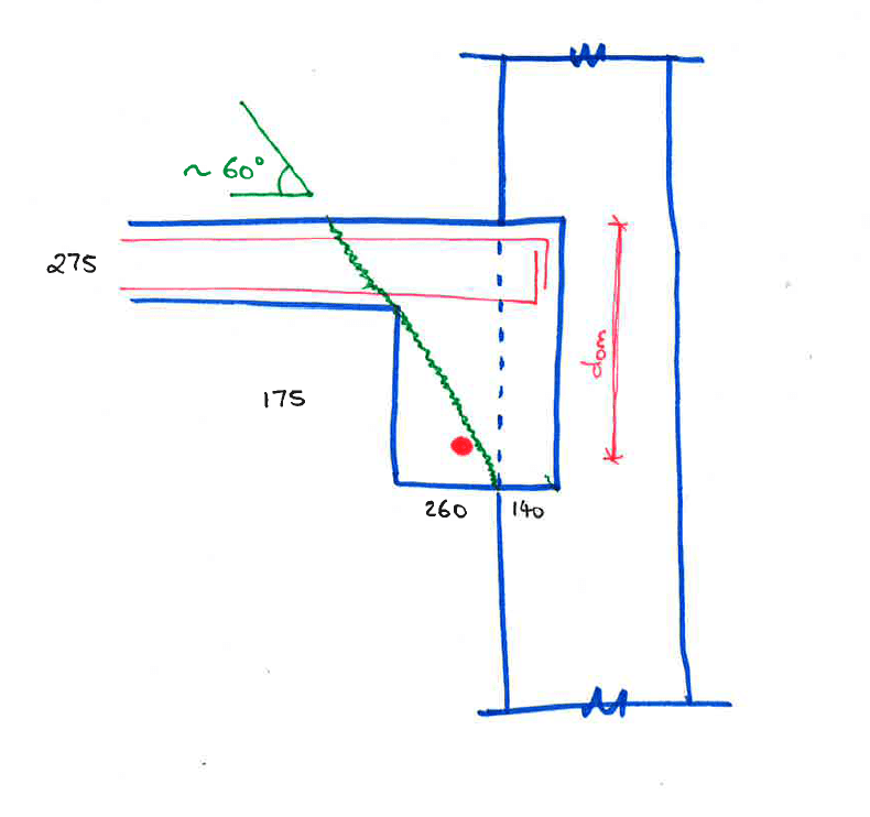

Now I'm trying to get my head about what punching shear with a spandrel looks like (see sketch below). I'm wondering if you need to reduce the extends of the critical shear perimeter from dom/2 to something more aligns with the crack angle shown. However I can see in Figure 9.2.1 (B) AS3600, that the shear perimeter for my situation does in fact extend past the width of the beam.
Now I'm also thinking that by introducing a spandrel beam, we are now looking at mostly just a one way beam shear problem. As load will be attracted to the edge beams, then through the beams to the columns?

I've also checked the bearing surface for crushing and it is fine ^^^
I hope you have some really good column ties over the depth of the beam connection, and especially over the slab depth, to transfer the forces to the column, just so that it does not tear itself apart!
