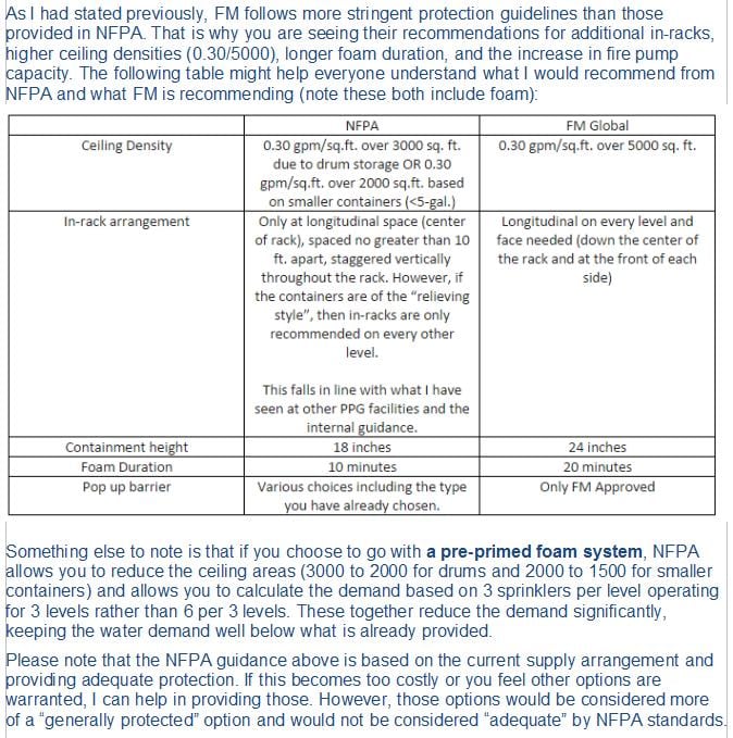

I received the design criteria just a few minutes ago and it appears we're going to go with NFPA standards. Note that everything is foam.
Ceiling Density: 0.30 gpm/sq.ft. over 3000 sq. ft. due to drum storage OR 0.30 gpm/sq.ft. over 2000 sq.ft. based on smaller containers (<5-gal.)
In Rack Arrangement: Only at longitudinal space (center of rack), spaced no greater than 10 ft. apart, staggered vertically throughout the rack. However, if the containers are of the “relieving style”, then in-racks are only recommended on every other level.
Foam Duration: 10 minutes
Something else to note is that if you choose to go with a pre-primed foam system, NFPA allows you to reduce the ceiling areas (3000 to 2000 for drums and 2000 to 1500 for smaller containers) and allows you to calculate the demand based on 3 sprinklers per level operating for 3 levels rather than 6 per 3 levels. These together reduce the demand significantly, keeping the water demand well below what is already provided.
There is drum storage so it will be the .30/3,000 but that could be a challenge with a 1,250 gpm pump.
As I said I just now got this so what about the pre-primed foam? I think I know what is involved but I *think* it has more to do with maintanence of the pre primed system.
Welp, time to start reading up!

Yeah...0.3/3000 plus 3 levels of in-racks for 18 sprinklers total is going to be challenging with a 1250 gpm pump. FM used to only let you use 120% of rated capacity (vs 150% allowed by NFPA). You may need to look at some things that can help reduce your demands if they are available.

The owner has elected to go with NFPA standards not FM.
With AFFF a pre-primed system doesn't appear to be any great issue and by so doing "NFPA allows you to reduce the ceiling areas (3000 to 2000 for drums and 2000 to 1500 for smaller containers) and allows you to calculate the demand based on 3 sprinklers per level operating for 3 levels rather than 6 per 3 levels. These together reduce the demand significantly, keeping the water demand well below what is already provided."
I think the table used was TABLE 16.5.2.1 Design Criteria for Sprinkler Protection of Single- and Double-Row Rack Storage of Liquids in Metal Containers, Portable Tanks, and IBCs. It appears we will need 500 gpm hose but without knowing for sure what table was used I suppose it could be 250. Good thing is with pre-primed and the reduced areas 500 vs 250 isn't going to make much of an impact.
.30/2,000 with a total of 9 in-rack sprinklers isn't bad with the 1,250 gpm pump.
What I was told by the AFFF people is pre-priming consists of filling the system when testing the proportioner through the test header and we're done.
Before the tenant came with the flammable liquids we were going to go with an K16.8 ESFR system; 2 1/2" grid with 4" mains and 6" riser. I can't find a reason we couldn't use the same pipe (Dynaflow) arrangement just change heads. Pipe size wise I am way over designed if we go that way and in the future if the tenant ever moves out converting the system to ESFR would be as easy as modifying the riser manifold and changing the heads.
This all said I am still going to oversize the tank because preliminary calculations show I need 90 psi when I have about 150 psi available and we all know what that does. I will do a demand calc and base the quantity of concentrate on that.
