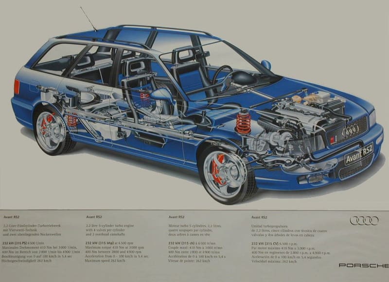

Good day.
Is there any simple method to approximate a radius of gyration of a car?
I have found on a recent thread the next statement:
useful term that represents the departure from one (1.00) of the yaw radius of gyration [in meters]
Can someone explain more what does it mean 1.00 in relation with CoG?
I`am trying to make front heavy Audi RS2 Avant Quattro with I5 engine be more agile.
Is it right in a real world trying to tune response on a production wagon by playing with PMOI and weight?
Chassis of the subject
P.S. Sorry for the grammar, English isn't my native language.

G'day Boris,
I think, you may mixing/confusing two different terms here. yaw radius of gyration (often labeled k) and a measure, which is known as the Dynamic Index in yaw (DI).
The often as "rule of thumb" cited DI=1 for a full sized sedan, is not the same as a yaw radius of gyration of 1 m^2.
Yaw radius of gyration = SQRT(MoI_z/Mass) MoI_z = Moment of Inertia aroud the (vertical) z- axis a.k.a. Moment of Inertia in Yaw.
To estimate MoI_z, (and this assumes a DI=1), you need the wheelbase of the car, the mass of the car, and the location of the CG - which is easy enough to measure, with a set of scales.
Then you do the following calculation MoI_z=a*b*Mass ( a= distance of the front axis to the CG location, b= distance of the rear axis of the CG location)
Let's use an example which is close to the car you ask about.
I will use a Audi quattro 4000 (in Europe better known as a Audi 90 quattro from 1984, the model before the B4)
The wheelbase of the car, is given as 2.520m, the distance a = 1.124m, from this is follows that the distance b = 1.396m (the car is "front heavy, and uses the same base engine I5 as the car you question about)
the mass is given with 1240 kg (empty).
Now, if we use this data (which come from the NHTSA database, and you will see soon, why I use them), we can extimate the MoI in yaw as.
MoI_z = 1.124m * 1.396m * 1240kg = 1945.7 kgm^2
which gives as a k^2 value of 1.5691 m^2 [k^2 = MoI_z/mass]
and if we take the square root of this k^2 value we get our radius of gyration in yaw
k = SQRT(k^2) = SQRT(1.5691)
k = 1.2526 m ---> as you see, the radius if gyration is not 1 m, but the DI=1
so what is the DI? --> it's k^2/(a*b)
But the estimate of DI=1 is not always true, it just happened to be a reasonable "rule of thumb" for a "standard (front engine, rear wheel drive) full size sedan, something like a BMW 7 series etc.
The measured data for the Audi 4000 quattro, show a MoI of 2352 kgm^2 [compare to our estimated 1945.7]
Therefore the radius of gyration for this car is:
k = SQRT(MoI_z/mass) = SQRT(2352/1240) = SQRT(1.8968)
k = 1.3772 m [ compare to our estimated 1.2526m]
the resaon that k is larger then the estimate is, because this car has a DI of >1 [k^2/(a+b)] = 1.2088
There are other, (better?) , rules of thumb to estimate MoI which take the overall length of the car, and the ration overall legth to wheelbase into account, which gives a indication of the "overhangs" and thereby a better "guess" for the mass distribution, but I can't remember the formula out of the top of my head. But I'm sure someone on here, will know it.
So, all things considered, you may use a DI=1.2, measure the wheelbase and the mass of your car in question, and that should give you a good enough estimate for your radius of gyratio (k) - IMHO
On the other hand, without relocating heavy items &/or altering the wheelbase (front overhang) it will be difficult - IMHO - to change this value by much. Not sure if this is a daily driver, or a track/race car.
The only item, which I can see, that you could reasonable easy relocate is the battery, if it is not allready at the back.
See, what Audi did with their Audi Sport quattro S1 group B rally car, to try and change this --> they placed the radiators at the rear, but this is quite a heavy modification for little gain.
But this is up to you, if the battery is still at the front, you can try to move it more backwards (boot) and then you can try to move the front wheels a bit more forward, to get the engine a bit more "over the front axle" [see similar issue with BMW 3 series 4 vs. 6 cylinder cars].
If this is a track/race car, and cost and effort is not a limiting factor, you should consider moving the complete engine gearbox backwards, but this is a "major project", which needs a modification of the front fire wall, a shorter propshaft, and maybe longer front drive shafts and other mods. Not sure this is worse it. But that's fr you to decide/figure out.
best regards & good luck

RE: Radius of gyration
Very helpful! Thanks guys!
Yes I was confused by DI (I've never read in books about it and never heard in the university)
It's a weekend car with some track day action.
My plan is:
Fiber hood - 10kg save 1.3m from CG = 10x1.69 = 16.9 kgm^2
AC Remove - 20kg save from 1.6m = 20x2.56 = 51.2 kgm^2
Electric PAS - 10kg save from 1.6m = 10x2.56 = 25.6 kgm^2
Alloy Rad - 10kg save from 1.4m = 10x1.96 = 19.6 kgm^2
Remove spare wheel - 20 kg save from -1.6m = 20x 2.56 = 51.2 kgm^2
Light battery - 10 kg save from -1.8 = 10x3.24 = 32.4 kgm^2
Remove tow bar - 10 kg save from -2 = 10x4 = 40 kgm^2
Total = 236.9 = -10% from NHTSA 2352 kgm^2 and it's nearly 1 DI
Am I correct in my approximation and in DI understanding?
I need it only to realize - will it be worthwhile work due cost and effort?
What DI is a ballpark for weekend track day car? Or it would be wise to keep 1 DI and tune other factors of the transient response?
I recognize the original statement, seeing that I wrote it. It is based on real measurements of hundreds of vehicles: both inertias and total masses AND the analysis of theoretical vehicle dynamics differential equations.. The relationship I mentioned is a large factor in yaw and sideslip dynamics because the balance between the SUM of side forces and their DIFFERENCE places demands on tire and suspension characteristics in order to meet handling goals. What is evident to those willing to construct the coupled differential equations that govern these motions is that the inertia to mass ratio is a strong player in the foundation of the plant dynamics (denominators) for yaw velocity and sideslip angle motions. To simplify this relationship, this ratio is often reduced to an index form, which suggests that the vehicle is only a bar bell. Unfortunately, vehicles are not actually bar bells. There a few point masses. The big players (engine and transmission for example) have their own inherent principle inertias so just adding a motor as a point mass doesn't work very well in getting total vehicle inertias from the placement of (point) masses. BTW: the powertrain principle inertias seldom line up with the vehicle body inertias.
The factor you mention is a big player when it's time to synthesis vehicle dynamic characteristics (gains and bandwidths/response times). Then it is evident that an 'inboard' mass distribution puts lower demands on things like tire cornering stiffness. (Remember the gains and bandwidths are targeted by design, not settled for). The bottom line is that a vehicle requires lower cornering stiffnesses at each axle in order to meet its handling goals if this index is lower.
So now for your specific question. Moving BIG parts inward is good. Small motors are good, manual transmissions are good. Light glass is good. Fuel tank inward is good. Passengers inward are good. Spare tire left in the garage is good. Heavy bumpers are bad.
Note that it is the transient response traits that mainly benefit from this effort. For the same wheel weights, tires needing to generate lower yaw moments will ride better and ultimately deliver better fuel economy via lower rolling resistance.
