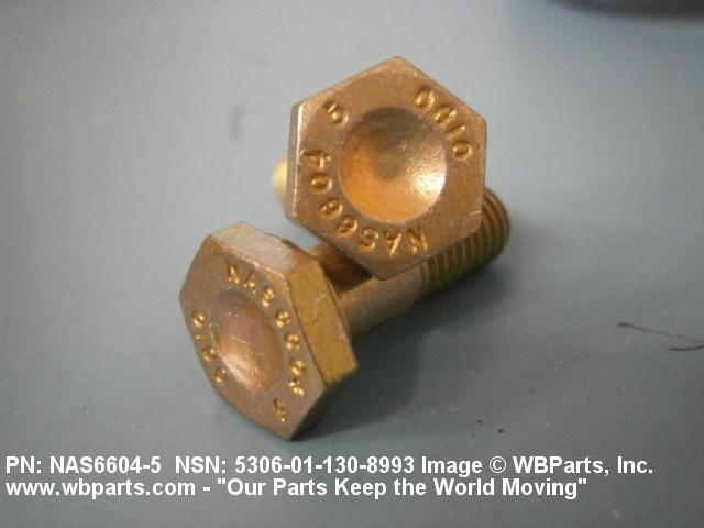

Can some one tell me the difference between the different types of NAS hex head bolts such as the 11xx series, the 13xx series and the NAS 501, NAS 464, 564 etc. Also can we use the NAS 13xx series bolts for tension applications or just for shear applications.

You can use shear bolts for tension applications as long as you take into account their specific design characteristics that reduce their tensile capacity versus a tension bolt of similar size and material. Shear bolts usually have thinner heads, smaller radius under-head fillets, and shorter thread lengths.

That helped a lot, however the list did not contain any details on the particular application (shear or tensile) for each bolt. To make my question more specific, can i use a NAS 6604 (1/4" dia) bolt for a tensile+shear application. The 6604 has a dimpled head:
It is rated at 150000 psi UTS.
RE: NAS Bolts for tension application
Maybe, or maybe not. The dimpled head is typically used for aircraft shear bolts to reduce weight. You will need to do an analysis to determine whether this bolt is acceptable for the combined tension/shear loads of your particular application. The NAS spec should give you all of the information you need for your analysis.

it'll have a shear and a tension allowable ... why not use in a shear + tension application ?
Yeah, in fact if you look at MMPDS-05 Vol 8, Tables 8.1.5(a) and 8.1.5(b), the allowable tensile and shear loads in those tables are based on the material ultimate tensile and shear strength values.
Just make sure that for a shear application no threads are in shear, and for a heavy duty tension application there is a nice hex or pan head supported with a washer and there are at least 5 threads engaged.

Just to elaborate on stressebookllc's general rule about having at least 5 complete thread pitches engaged for highly loaded tension installations, this assumes the mating component (like a locknut) is made from a material of equal/greater strength.
Also, as I noted previously, aircraft shear bolts have very limited thread lengths and tighter control of the grip length. One reason is because the threaded section of the bolt should never be loaded in shear as stressebookllc pointed out. Another reason is that since these bolts primarily carry shear loads the mating shear nuts have reduced height to save weight, so less thread length is needed. If you're going to use a shear bolt in a tension application you need to be careful about the locknut you use.
Here are links to specs for a typical aircraft hex head shear bolt and a tension locknut. The total thread length listed for a .250-28 bolt is .316". Subtracting the (max) 2 incomplete runout threads and the .018" end chamfer, that leaves around .227" of useable thread. The height shown on the spec for a .250-28 tension locknut is .292". Most aircraft locknut installation procedures require a visual verification of at least one complete thread protruding past the locking feature, which in this case would be the upper edge of the locknut. So that would mean a .328" complete thread length required by the locknut, which is more than the shear bolt has available.
Lastly, with the short thread lengths used on shear bolts you need to pay close attention to the tolerances in your fastener stack-up. You want to avoid a situation where the nut bottoms out on the bolt threads before it clamps tight against the component surfaces.
