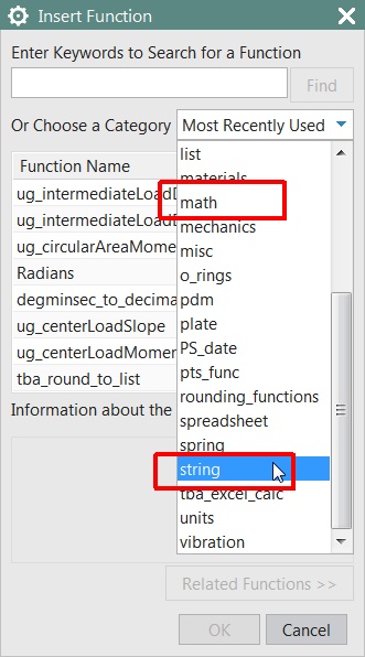

So, there are a bunch of string functions and math functions available inside NX now... These are found very near the spreadsheet functions you've mentioned:

And as John mentions, you certainly have the option of adding to the function list, using a bit of Knowledge Fusion programming. (In fact, now that I think about it, the "rounding functions" and "tba_excel_calc" categories in the image above are both custom sets of functions.) Knowledge Fusion has some ODBC database access functionality that might be of use to you here, if that's really critical. And of course, once you make the leap into customization programming, you could also start to leverage .NET, Java, C++ etc. if needed.
