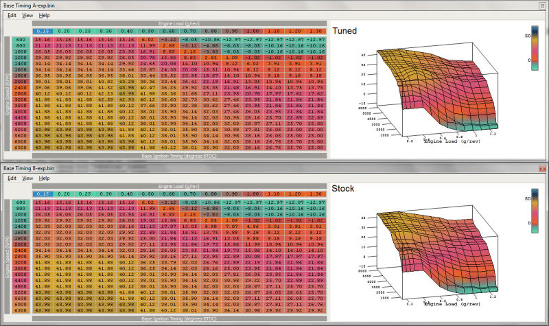

When you added ignition advance did you add it in stages, like 2 degrees, between tests?
Did you add it to the stock or pre-existing curve, or just in a section of the rev range?
Did you end up with a load/rpm/timing map as varied as this?
http://www.911chips.com/USignst.gif
RE: Air Fuel Ratios for NA Engines
Yes I added timing in stages and it was load vs rpm based. I added more in lighter loads and slightly less as loads increased. I gave up after first stage due to loss of torque and detonation. I dont think the risk is justifiable.
I think I will stick with stoich or richer AFR tuning...14.5-14.2 AFR seems to give best torque without loss of BSFC for part loads. Above 3000 rpm at full MAP I start to enrich slightly to 14-13.7 AFR and keep it until peak torque. This gave me best BSFC rich of stoich partly because I could advance timing further than before. Also I can run 3-4° more timing than factory under cruising loads without detonation. I just wasn't sure about my method since it's leaner than factory and common practices for NA.

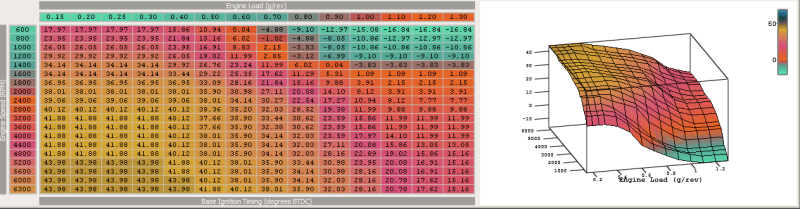

Total Ignition Timing

The best timing at high load at 1000 rpm is 11 degrees AFTER TDC?
And, at 4000 rpm under heavy load it has to be limited to 22 BDC?
Did I miss that this is a turbo engine?
Quote (tmoose)

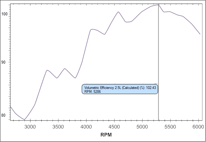

No its NA. But its compact pentroof chamber with high swirl and fast burn plus its 10:1 compression head requires much less advance than your regular big block v8.the closest V8 I think of to this engine is the ls7. Mid 20s in knock free timing makes peak torque with this engine.
Quote (gruntguru)
How did the knock you experienced at 12.5 AFR respond to retarding the timing? 12.5 should really be a sweet spot for power and knock resistance.
I experience 90% of my knock problem at peak torque 3800-4200 rpm and at peak VE ~5300 RPM. At peak torque going any richer than 13.5 AFR gives me knock. The closer I get to 12.5 it seems the worst it gets. You can retard timing as much as 4° and it will still knock. At peak VE its not too sensitive to fuel and more so to timing. So anything higher than 25-26° at peak VE causes knock whatever your fuel ratios.
On the dyno approaching 24° starts to flatten the torque curve and any more timing the torque falls. I can run MBT on pump gas with the AFR table I posted above. With stock furl map which is richer (NOT stoich) I can Not come close to such timings. It's strange but it is what it is.

New AFR Table:
Timing
note timing may seem to be over advanced at cruising ranges, this is because I performed part load tuning before this lean burn and timing was advanced until best torque. Actual timing added after lean burn was around 3-5* on top of previous tune or 14%.

I'm having difficulty fighting knock with leanburn and making the same amount of power. The lean conditions at low loads 'make their way' to higher loads with sudden opening of throttle cause detonation. I think I'll stick with stoich/rich map for now which allows me to advance timing to MBT everywhere in the powerband excluding at low RPMs (1000-2000 RPM):
VE:
also on a separate note, my engine experiences higher loads than defined in this table. It's not unusual to see 1.7 g/rev at higher RPMs specially with colder temperatures. MODs are mostly on the exhaust and intake side, like headers and higher flowing piping. MAF has been re-scaled as well. I'm just happy I managed to kill detonation with an unusual way of leaning (closer to stoich). As said I experience knock near the VE peaks 4000 and 5500 RPM. Currently I'm not getting any knock.

correct timing table

volumetric efficiency over 100% with a modified street vehicle at 5300 rpm?
How are you calculating that?
I guess the load scale units are grams/per revolution passing thru the mass air flow sensor.
Are the values for the whole engine?
regards,
Dan T
I'm not calculating it. The ecu is estimating VE based on airflow from Maf and other sensors. Stock with no mods it was around 95%
MAF = Engine Load * RPM / 60
Example:
at 3534rpm * 2.91g engine load / 60 = 171g/s maf
