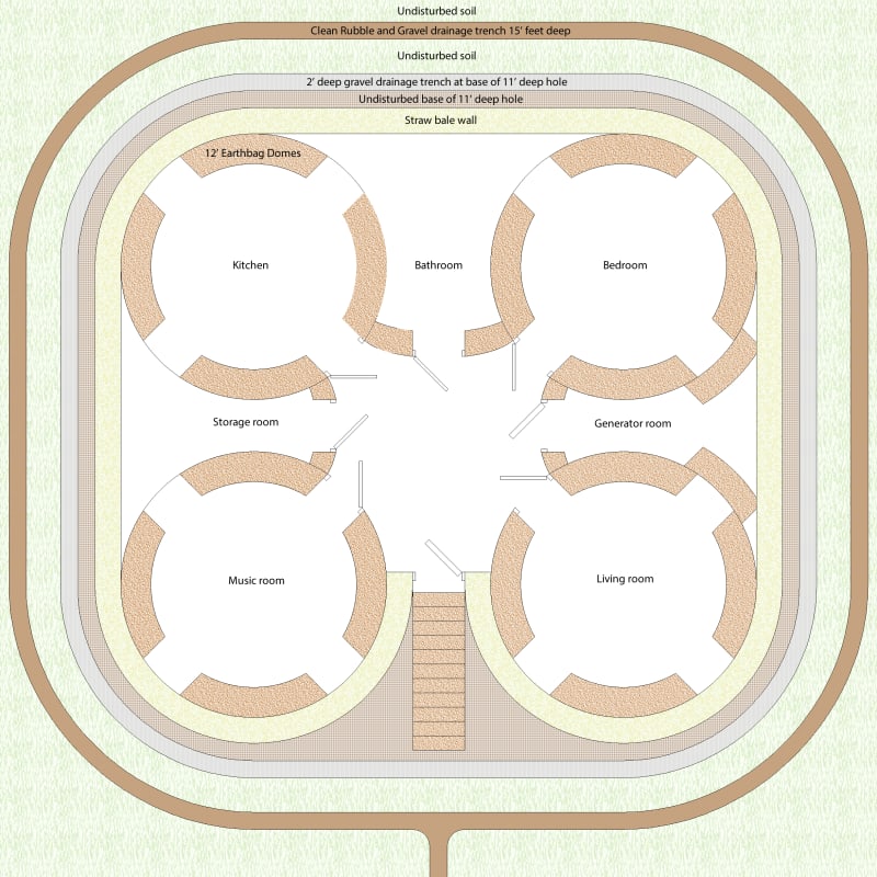

Thanks for looking at my thread. I'm not an engineer, some general advice would be greatly appreciated. In some cohesive soils, can holes (90° walls) be permanently self supporting if protected (from above and sides) from ground water and weather?
I understand if you were asked to confirm that a large hole (11x11 meters) is self supporting you'd need a large amount of data about the site geology which I don't have currently, so this is just theoretical for now.
The plan is to protect the hole from weather by covering it with a rubber membrane which is supported to be high in the middle, so to drain to the sides. Protecting the sides from running ground water is more tricky. Currently my best idea is a trench around the hole (2' away from the hole) filled with clean rubble and gravel to below the floor level of the hole. The 2' thick wall of soil between the trench and hole would act as a (not 100% effective) vapour barrier to reduce the humidity inside the hole (which has some protected ventilation).
Thanks in advance for your help!

Thanks again for the great answers guys! Sorry for the slow reply, I'm in the UK, it was pretty late when I posted. For some context I've inserted an image below of the mostly self build underground dwelling project. Any input is greatly appreciated! From the image it looks like humidity would build up between the walls of the hole and the straw bales, but there will be active ventilation.
RE: Newbie: In some soils, can holes be permanently self supporting if protected from ground water and..
I should mention also, the plan to waterproof from above is a massive rubber (epdm) sheet which is supported at it's centre by a bamboo supported sky light, to be the highest point, so water drains off into the gravel trench. Domes finish prematurely before reaching the full dome shape to support 8' circular sky lights.
Oldestguy, thanks, here's some of the info you said may be useful:
Lat & Long: 50.155853, -5.158280
Soil type (only topsoil info available right now) can be seen using the lat & lon at at http://www.landis.org.uk/soilscapes/
Soilscape 13:
Freely draining acid loamy soils over rock
Loamy
Freely draining
Drains to: Local groundwater and the river network
I originally designed in waterproofing to the sides of the building design, but thought (with my lack of geotech experience) it may be better to attempt to keep the sides dry using ground works.

Hi again Oldestguy,
Thanks again for your input, I'm familiar with Frank Lloyd Wright especially because of his rubble trench foundation ideas. This isn't my technique by the way, I'm using a book written by a couple of who live in CA who have built bermed domes with this method already, I'm simply converting it for my climate and trying to put it underground.
I do appreciate it when any aspect of my plans is questioned, it makes me think again about the design:
Not pictured on that image is a bamboo frame supported by the domes holding up straw bales below the rubber membrane. In the rooms not in domes the underside of the straw bales and bamboo poles will be plastered with a clay plaster to avoid the condensation on rubber problem you mentioned. Inside the domes during points of high internal humidity it would settle into the earth and be released during times of low humidity (heat exchanger ventilation), or on the skylight which can be monitored and dehumidified. The bathroom will be tiled and with extra active ventilation and the kitchen will have a normal extractor fan. the floors will be sealed with linseed oil on top of a normal earth floor preparation.
The mice / rats would need to chew through the rubber (which I know they can do) enter the front door, but in the design in that image the straw bales on the sides would be available for inspection, not least by a house cat :)
We have very minimal snow loads and no snow most years, besides the dome shape is fantastic at distributing loads. If the design does get build underground there would be no wind loads. I'm a big proponent of composting wood chips to heat water for underwater heating.
Please feel free to let me know any other points you can think of, or if I didn't provide enough detail / you think a solution is not suitable.

Hey Guys,
Wow what a lot of interest, very inspiring indeed! I think the most important factor deciding if this project will be pulled off to the extent where the structure is stable and safe, is how well the input from varied and experienced guys like yourselves is sought, taken on board and sternly implemented. Perhaps some of the interest in this project from a Geotech forum is due to this building method being entirely structurally earth based with geotextiles?. Concrete is fantastic for bridges, sky scrapers and countless other uses, as I'm sure you guys know concrete products are not necessary for modest structures.
OG: Thanks again! Your first point I must admit I didn't even consider! I assumed due to the aerodynamic shape and almost grade level of the waterproofing membrane and skylights that wind wouldn't be a problem. Polypropylene mechanically tightened strapping will now hold the skylights in place with tonnes of dirt, I'm adding this detail (and others) to a new CAD elevation sketch which I'll post here once completed. This solution should cope with considerable vibration. Regarding uplift to the waterproofing membrane, you paralleled an airplane wing, which are of course smooth, I haven't mentioned but I intend to cover the waterproof membrane in a thin (1-3") of soil to sustain succulents such as sedums which will provide a very rough surface. Do you think this will be enough to counteract the uplift effect?
Due to the complications mentioned of having a wall of undisturbed earth to the outside of the domes I'm not yet decided if the waterproofing membrane will simply be applied to the outside of a more load bearing insulation, such as volcanic rock in polypropylene sacks stacked against the domes. The earth could then press against the domes from the outside which have proven themselves (in other projects) able to distribute / support such a load. The amount of horizontal load will be clearer on the new elevation sketch once completed.
That said I'm still very interested in the eco solutions for retaining walls, as not having the earth loaded onto the domes does have advantages. Below is an image from http://www.flexmse.com/ who basically are branding Earthbag building. I phoned the guy up and asked him directly what the difference is between their earth walling system and earthbag building, there's basically no difference, what do you think? Does this count as a gravity retaining wall?
I will employ a local engineer who specialises in earth building. Thankfully in the UK (not sure about the US) we have third part approved inspectors (who don't work for the local building control office) who can sign off a building. This means I can find one who specialises in earthen building methods and who hopefully has good Geotech experience.

As to a barrier around the facility to cut off lateral flow of water, well yes that works, but nothing can prevent that water from sneaking around under that barrier short of founding it on very impermeable material. Again, with these questions coming up, it shows the need for help there with your project. As to some vegetation on a dome preventing lift, I'd not take a chance, since a strong wind will peel of coverings once it gets under the edge. I'd not do any plan using details not tried and proven elsewhere. Should I repeat that? From an 86 year old who has seen a lot of failures.
