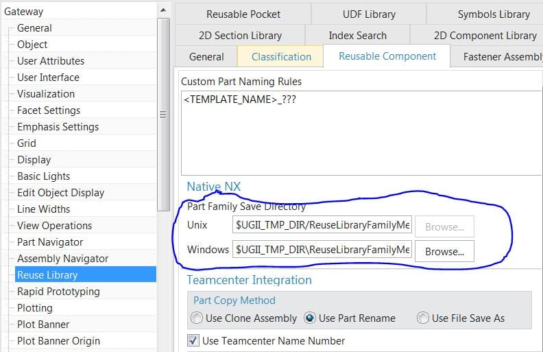

So, after some diligence, I've realized I need to create a reusable part or I won't get the cloning capability. After looking it up it appears that I can make a reusable part without it being a "part family" part. Is this correct?
Also, while making changes in customer defaults I must have accidentally deleted something. I cant drag anything into the ass'y from the reuse libraries without getting this message
Reuse Library Error
"The family member saving directory does not exist"
It's been so long since I've set this up I'm having trouble finding it.
I think I may have deleted a line in
Gateway, Reuse Library, General
Reuse Library Configuration File
"Windows "Field"
I'm pretty sure I had something in there before. Any help?
TIA
Dave
Automotive Tooling / Aircraft Tooling / Ground Support Structures
NX9, Win 7 Pro SP1
RE: Adding custom reuse library part to ass'y with "clone option", NX9
Dave --
I heard about a similar error recently (earlier this week, in fact), and got a response to this effect from the Reuse Library developers:
In a previous release, the Part Family Save Directory was set to $Windows/Program Files/ReuseLibraryFamilyMember by default. On the WinX64 platform, there appear to be times when NX cannot create this folder under the "$Windows/Program Files" folder branch -- we suspect because of a security-driven limitation on write access. Changing this customer default setting to a writable location can eliminate the error:
Does that fix the problem for you?

The spreadsheet dictates what expression can be presented in the NX dialog.
so the variables that you add can be edited through the NX dialog. - you can omit things like extrude start distance if this is always 0 by not including that expression in the spreadsheet.
If your variables has "poor" names, such as "p0" there is a possibility to change this,
see attached image.

In the Krx dialog, move the expression you like to rename( erratic in above post) from the left to the right, then double click the descriptive name. ( see image.)
Note that all expressions in the spreadsheet will be listed in the details field but only "expressions in the right field" will be presented in the "Primary parameters".
( The reason all variables in the picture have a "blank value" in the image is that the spreadsheet doesn't have any values.)
