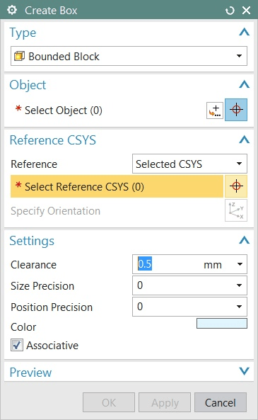

Seen posts here and had customers ask about bounding box functionality in NX.
The answer was to use Journals/NX Open/Grip etc to solve the problem.
NX has a function called Create Box that existed in the Wizards (Mold, Die or Electrode).
Without one of those Wizard licenses, you couldn't use it.
Saw an IR recently (see image below) which says that from NX9.0.3 onwards, you only need a solid modeling license to use the function.
Thought it was pretty neat function so we've made a video to show how to access it and how it works: https://vimeo.com/116116872
Also did some testing and NX9.0.2 can also do the same.
NX10 version of Create Box is better as well.

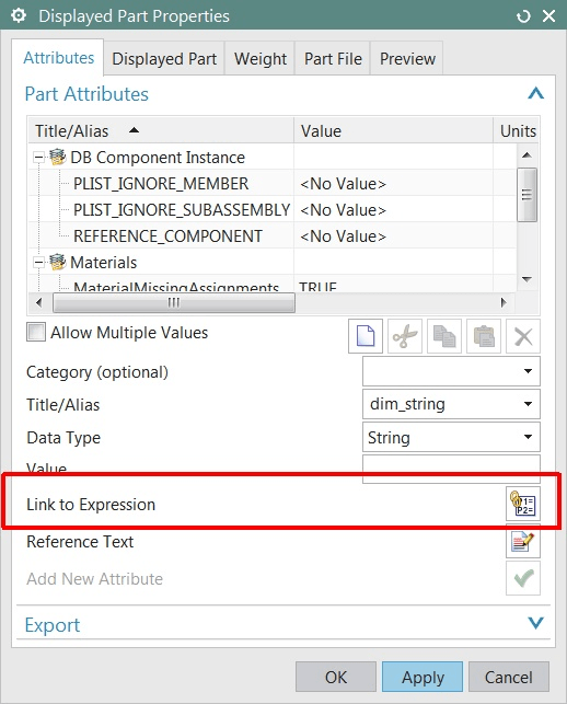

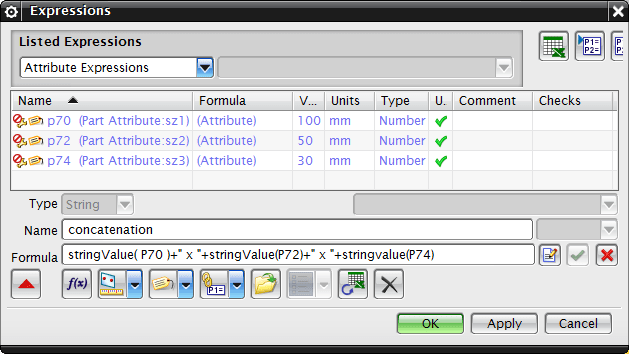

Maybe someone could help me with this, petulf is trying to do something that I have been somewhat doing
What I do sometimes is create the box, then create 3 associative dimensions and call them sz1, sz2 and sz3
Now I have 3 expressions that I can use that will automatically update
On my drawing I can use <X.4@sz1> X <X.4@sz2> X <X.4@sz3> to show the sizes
But is there any way to get these to an attribute so they show up on my bom in the format sz1 X sx2 X sz3 (I do not want 3 columns in my BOM)

RE: NX9 Bounding Box function
Anthony, I'm running NX9.0.3.4 MP03.
It does work in NX10
When I use command finder, I do not see Mold box or Create box
any suggestions? I currently use a journal from Cohens NXcustom setup to make a bounding box, but i'm interested in an actual command
Robnewcomb:
Do you run 902 or later ?
As Anthony noted in the first post, its in 902 and later.

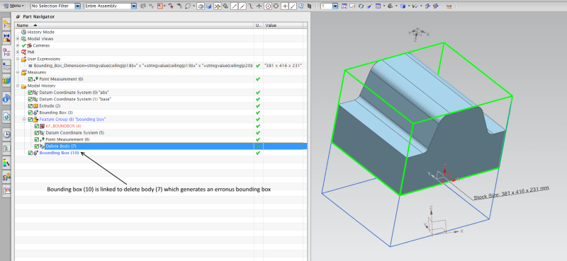

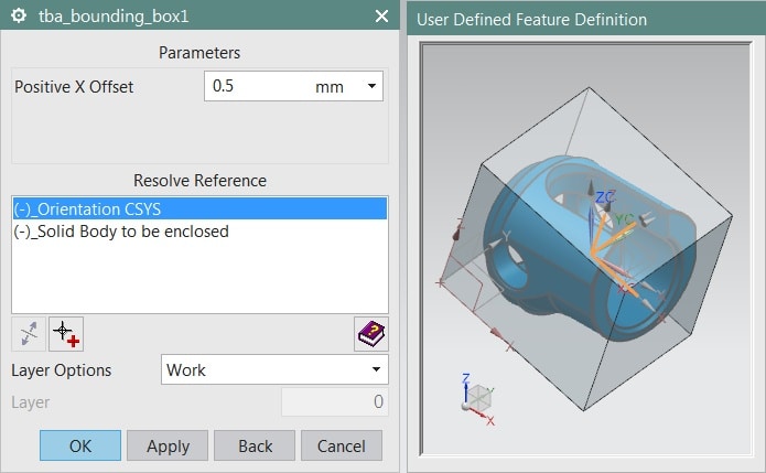

PhoeNX: Yes mold wizard has the stock size tool but it is not associative, it only runs the bounding box function and then as you say stores the result into two attribute strings but it will not update if the underlying objects are changed.
phillipd: Create box uses knowledge fusion functions so i would start troubleshooting there, i run the same version and it works.
bmarchand: You could create an expression that concatenates the expressions using the stringvalue() function, the following example uses referenced attributes but measurement expressions will work the same way.
We currently use our own NXOpen program to get a complete list of stocksizes as we find the current NX bounding box tools to be lacking. This solution is not optimal as the values are not associative thus we do not want to push them directly into drawings and teamcenter.
What I would like to see in an NX bounding box feature
  • Be contained in one fully associative feature.
  • Outputs the bounding box dimensions into attributes and or expressions, so that the values can be used downstream in drafting and teamcenter.
  • Can reference abs, wcs or a datum csys feature as the bounding box frame reference.
  • Optional creation of solid, i.e. so that it is only visible from within the feature dialog.
Our current plan is to create a knowledge fusion feature for this, but it would be oh so much better to be able to do this with native NX feature modeling.
Another technique for associatively collecting the three dimensions of the bounding box would be to put an associative Datum CSYS on one corner of the bounding box and then create an associative Point Measurement [also new in NX 9] on the opposite corner of the block, RELATIVE to the Datum CSYS. This will give you an accurate set of dimensions for the box, regardless of orientation or size changes:
...and with the Point Measurement feature, you can choose whether to get just one "Point" expression for the answer, or optionally create all three components dimensions as individual "Number" expressions as well:
Just another thought. smile
petulf: I suspect you could get awfully close to your desired end state with a UDF -- particularly using the NX 10 version of the bounding box -- and with the technique I showed.
(Target body and orientation CSYS selections as two inputs,
extract faces as input for bounding box,
create Bounding Box feature,
create Datum CSYS feature,
create Point Measurement,
which creates expressions...)
...and avoiding the ongoing maintenance of a programmatic solution would probably be worth the tradeoffs. smile

@robnewcomb, make sure you're in modeling when using command finder.
Otherwise, the attached ribbon bar file will add a ribbon tab with the right Create Box function.
To automatically load a RTB file at NX startup, put it in the startup folder pointed to via the USER,GROUP or SITE DIR variables.
I made a video showing how I would do that for the USER variable UGII_USER_DIR.
RTB File
Video file
TaylorAnderson
That is a great Idea
How would I get the values to a single attribute so I can add a column to my bom and have "value X value X value"
petulf suggested stringvalue() but I haven't figured out how yet
Taylor: Good idea and had completely missed the point measurement feature which is sure to come in handy. To bad that create box reference csys is not associative and the object selection does not use selection rules as input but directly references the object tags. Thus it is not possible to create an associative udf (extract feature face will not help) that takes a body and csys feature as input. An improvement request for the create box feature might be in order?
I have included a test part that tries to create what we want with out of the box features, the non-associative nature of create box is the only obstacle.
bmarchand: Check out the included nx9 part for an example of how to convert numbers to strings.
