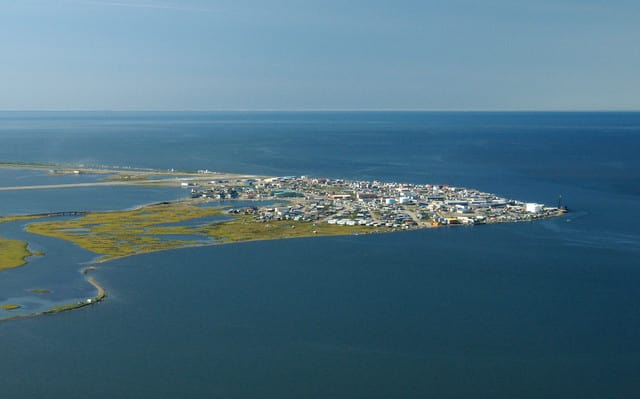

I turns out that this bad boy will be located in Kotzebue Alaska. If anyone has a contractor relative there, put me in touch.
RE: Skid Platform in Permafrost Environment
Thanks to Brad's map, I can say that this is a "discontinuous permafrost" region. Not sure if that changes anyone's answers.
That site is quite remote, but it is within 550mi of Anchorage. I see that Arctic Foundations has done some work in Kotzebue, Alaska and they have completed projects with this scope. I noticed a lot of driven piles, and screw piles of some form. The drake company refers to slab on grade, but I didn't see where the concrete comes from. I think arctic foundations will get you headed in the right direction. Considering the seismic aspect, this might be a complicated design.
