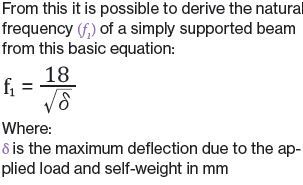

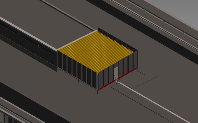

And.... we're back.
Similar sort of situation, Arch. wants to single span some purlins, without cladding, over a plant platform to somewhat conceal the mechanical equipment inside.
Structural details: 8.6m single span @ 500 c/c, relatively low wind area Qu = 1.5 kPa, desired C purlin to be used with lower lip on an angle to stop it holding water.
I'm mostly worried about the low speed wind 'flutter' (in particular a cross wind response/vibration) as mentioned above, but have no clue how I would check this.
Any ideas?
EDIT: Running a quick number on the natural frequency of a simply supported beam with a service wind load acting in the vertical direction, the frequency comes out at around 3 Hz.
RE: Vibration of Suspended Steel Fin
I would put some bridging in, say at third points, just to make them all act together. Other than that, I wouldn't worry too much about flutter.
