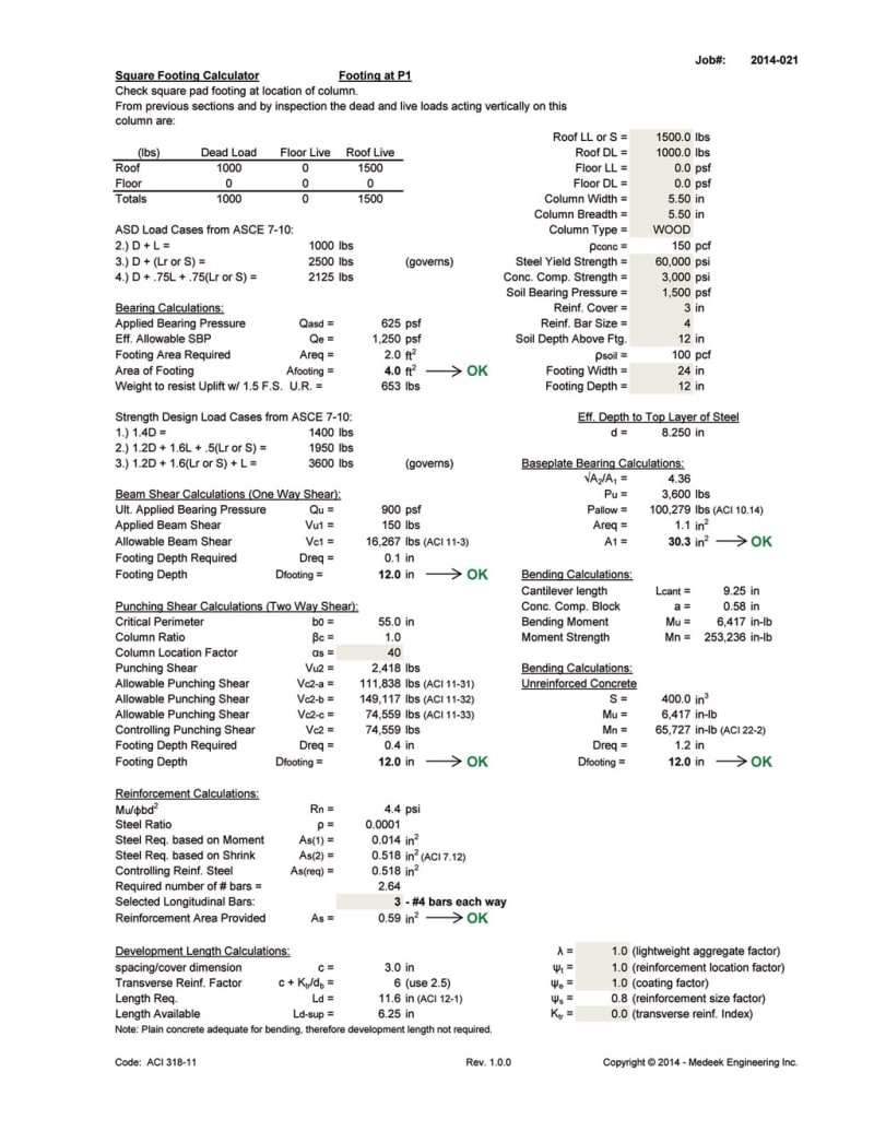

This is what I have for a stemwall footing. Now I need to modify it further to include overturning due to shearwall action.
The Excel file is here if anyone is interested in testing it out:
http://design.medeek.com/resources/footing/

The updated stemwall calculator and the square footing calculator:
http://design.medeek.com/resources/footing/2014-02...
The output of the square footing calculator looks like the following:
Going through the exercise of creating these two spreadsheets and comparing them to StruCalc's Output finally got me motivated enough to finally open up the ACI 318. I can't say I'm totally comfortable with concrete yet but at least I've got me feet wet. With my square footing calculator I was not able to completely reconcile my values for the applied beam shear and the applied bending moment with StruCalc's values (their values are slightly higher), otherwise everything else seems to checks out. I've sent an email to their support requesting more information on how they are arriving at their values and hopefully I will get to the bottom of it.
