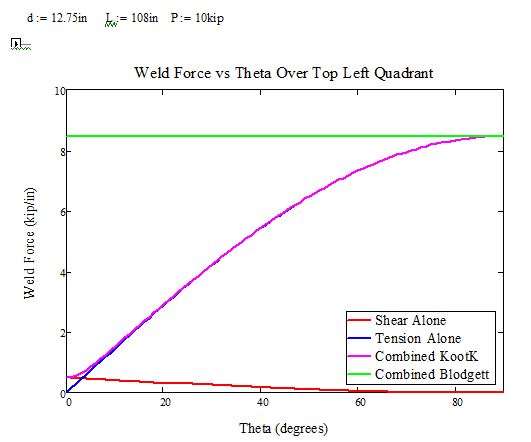

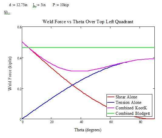

Quote (Medeek)
However, if you apply a simple thought experiment perhaps it might become more clear. Assume we have a hollow pipe welded around its perimeter, at the other end of the pipe we have a load evenly distributed around the pipe perimeter that is perpendicular to the pipe's long axis. Now imagine that we slowly decrease the length of the pipe until it is almost zero length, everything else remains the same. You would find that the shear load around the perimeter of the pipe is now evenly distributed along the weld. There may be a flaw in this thought experiment but for now it makes sense to me.
The flaw is that, for loads applied further from the support, the stresses that comprise the resistance to those loads have time to reorganize themselves to reflect the inherent stiffnesses and flexibility of the cross section. Your mental experiment could also be applied to a wide flange section. In that case, the result would be the same. However, I think that we can all agree that the welds along the web should be designed to constitute the bulk of the shear resistance.
Quote (Ron)
Now you have to consider that the horizontal load must be resisted in shear. The whole circumference resists this.
I've quoted Ron but this seems to be the sentiment of pretty much everyone other than myself. Try this "proof" to the contrary on for size:
1) The forces in the welds at the support are simply the stresses in the circular hollow section at the support multiplied by the wall thickness.
2) The shear stresses in the circular hollow section at the support -- or anywhere else -- are not resisted by all segments of the cross section equally. This can be verified through VQ/It analysis and by one our own threads on the topic Link.
3) IF (ARGUMENT 1 = TRUE) AND (ARGUMENT 2 = TRUE) THEN (Welds more parallel to the applied load will be disproportionately loaded in shear).
I like to debate structural engineering theory -- a lot. If I challenge you on something, know that I'm doing so because I respect your opinion enough that I want to either change it or adopt it.
The greatest trick that bond stress ever pulled was convincing the world it didn't exist.

RE: Capacity of a round weld
There is another point that was made in that mechanical thread that I feel is significant. To paraphrase:
For weld design, the end game should be only two force components in each unit segment of weld:
1) A force parallel to the longitudinal axis of the tube, reflecting bending stress.
2) A force tangential to the tube representing VQ/It stress.
That makes sense to me. There should be no component of weld force in the radial direction as radial flexibility in the tube walls will tend to relieve that force component. This would lead one to assume that the welds at the very top and bottom of the section resist none of the applied shear. And that would match the expected VQ/It result.
I find myself in my least favorite of positions: I no longer believe that I am right but, at the same time, I also do not understand why I am wrong. Now I'm just... confused.

@ Everybody:
I did a bit of numerical fiddling using the Blodgett example and assuming my theory of shear distribution to be correct. See the graphs below which describe the variation of force in the top left quadrant of the weld starting from horizontal (0 degress) and ending at the zenith (90 degrees).
I plotted four relationships:
1) Weld shear force on its own calculated via VQ/It.
2) Weld tension (bending) force on its own.
3) Combined, vector sum weld shear calculated with my theory.
4) Combined, vector sum weld shear calculated with Blodgett's simplification.
The results are as follows:
1) At the original 108" length, shear stresses barely register on the graph.
2) At 24" length, the shear stresses register on the graph but do not affect the outcome.
5) At 5" length, the shear stresses would finally affect the outcome. Of course, at such a low span to depth ratio, flexural theory probably doesn't even apply.
My conclusion:
An improvement upon Blodgett's simplification would be to simply not include shear in the calculation at all. There doesn't ever seem to be a practical scenario where it would affect the weld size.
5" Length
