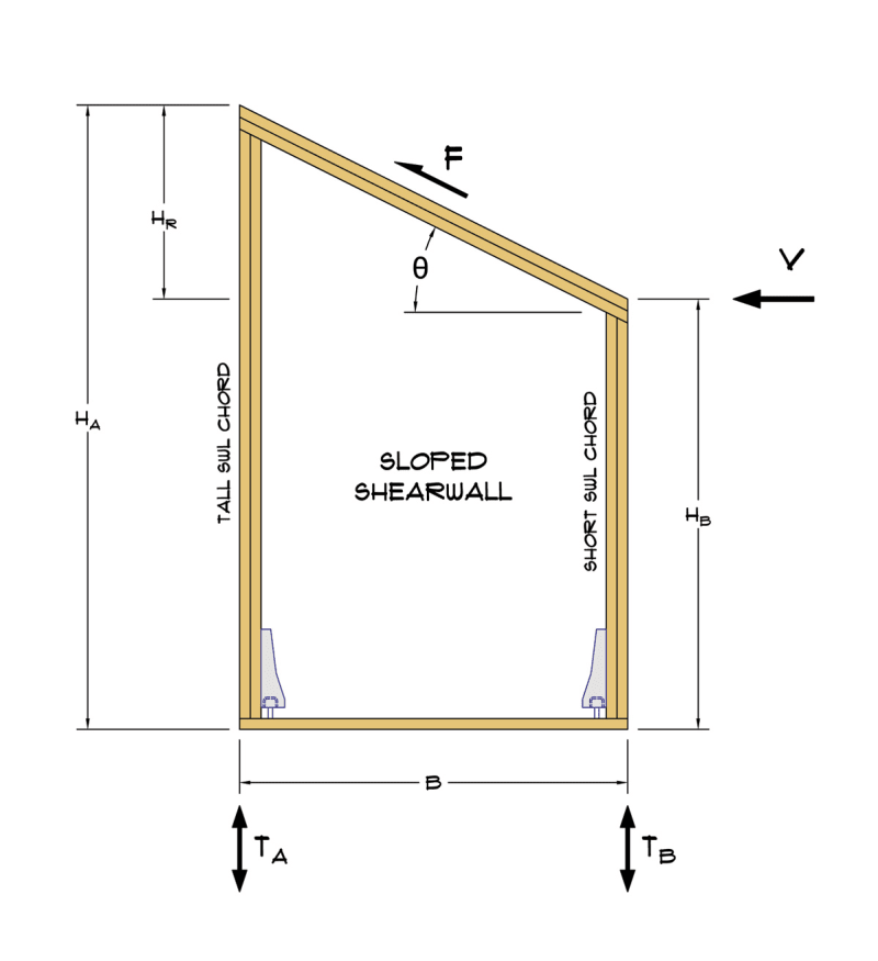

RE: Gable End and Interior Shearwalls
Note that up until now I have been treating the gable truss as a drag truss in my analysis which means the holdown force I've been using is given in the first box above:
T = F(cosθ)wh/b
This holdown force is less than the holdown force given by Matteson's paper (second box) and also less than holdown force given by the average wall height method (third box).
The other thing thats stands out to me from Matteson's paper is the suggestion to apply a strap at the low end of the sloping shear wall that passes over the top plate of the shear wall and connects to the chord. I've never seen this done, which doesn't mean it hasn't been done or shouldn't be, but I'm oblivious to it. Does anyone have any examples of this being done in practice, picture or diagrams would be educational. The downward force that must be provided by the strap is: Fy = F(sinθ)
My findings based on this discussion are presented below:
Which brings me to one additional question which was already partially addressed by Dave Atkins above. Every truss in the roof that is subject to a lateral load along its top chords will experience an overturning moment with an uplift force given as:
V/2(tanθ)
The lateral force on each truss cannot be resisted by the walls beneath it since they are perpendicular to the load so the lateral load will be collected up by the diaphragm and resisted at the shearwalls. However, the vertical uplift force I would argue can be resisted by each truss connection to the wall beneath it hence the only loads that need to be dealt with at the shearwalls are the total horizontal component tributary to each shearwall. Once you have the total shear for the shearwall then if the truss above cannot act as drag truss you then have to analyze it according to the method proposed by Matteson or the avg. height method. In this reqard the Matteson method appears to be a more accurate and rational method of the two.

I agree with woodman88. Even if you assume a drag truss there will be additional overturning force simply because the lateral load is not imparted at the eves to the system as a whole. Personally, I used the midheight of the roof structure, I do not use dead load to offset the tension (I specify the nailing of stud groups so typically I have much greater capacity than I need for compression; my stud group thickness are governed by the minimum for the holdown) and I clearly spell out what the in-plane shear needs to be for drag truss. I can almost guarantee the truss manufacturer will not size the truss members for right load if you do not explicitly define the demand.
This has been an important and enlightening discussion for me. Thanks for getting it started Medeek.
I tepidly disagree with woodman and Robert on this one. Unless a moment couple is developed between the top of a shear wall and the drag truss above it, the shear wall will feel the applied shear as though it were delivered at an elevation matching the top of the wall. That's just statics.
Moreover, if the couple mentioned above were possible, it would put the shear wall in double curvature and reduce the overturning on the shear wall. For the truss over shear wall condition, I just don't see any way for the overturning moment to be any more than it would be with the shear applied at the top of the wall.
The real question here is how to address that left over moment that reflects the elevation at which the shear is actually applied. And I believe that DaveAtkins has the right of that. I'll confess I'm a little worried because I have not been tying down my drag trusses or specifying that they have studs directly beneath them.

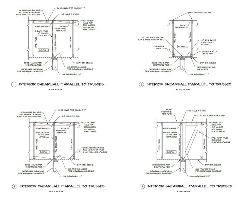

Here is the way I have always done it:
Assume platform framing with trusses above.
Specify on the drawings the location of the drag strut trusses, and that they must be positioned above the shear walls. Specify the lateral force you want the truss supplier to design for.
I don't ask the truss supplier to do anything special at the gable ends--those trusses will be covered with sheathing.
Detail the connection of the drag strut truss bottom chord to the top of the shear wall (toenails or Simpson angles).
Detail the connection at each end of the drag strut truss for uplift due to overturning, if required (otherwise, a normal hurricane tie will be sufficient).
Detail the connection of the bottom of the gable end truss to the top of the end wall (there will be a horizontal joint in the sheathing at the top of the wall).
Detail the shear wall holddowns.
You also need to note the nailing pattern for the roof sheathing and the wall sheathing. Assume unblocked sheathing at the roof--they almost never put in blocking. Blocking is typically required in the walls, because the design tables assume walls are blocked.

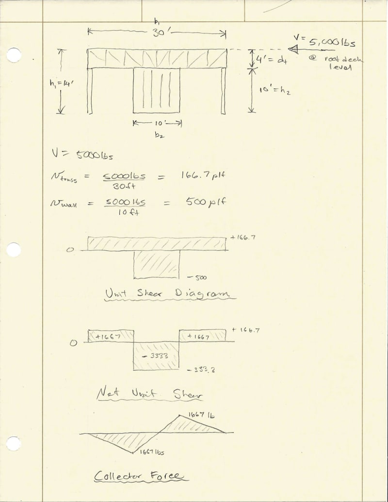

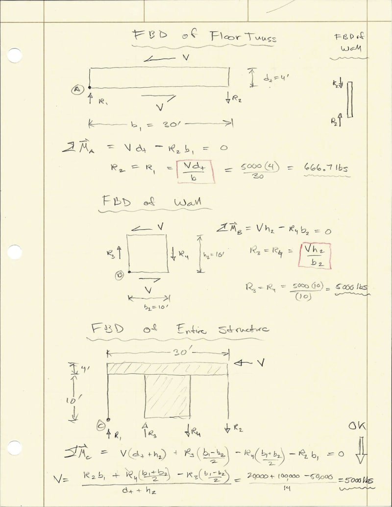

I thought it time for a summary sketch to ensure that I've really got the gist of this now. I went with a flat roof as the sloping diaphragm business detracts from the principle of most interest to me. Any objections?
Your statics looks solid to me:
My question is what is the best number to give the truss manufacturer? V, v, or R1/R2
A confused student is a good student.
or the collector force?
Nice. Exactly the calcs that I would have provided were I more industrious. I say give the truss guys everything. It's just ink and, the more information we provide, the better the odds.
Most truss companies delegate the connections for lateral forces to the EOR. The only number of interest to them is the total shear applied at the top chord. In my neck of the woods it is my job to decide how to connect their truss to the shear resisting element. They will eventually provide you a simple 2D shop drawing denoting the applied forces and their assumptions. This will be a standard output from a company like MiTec or another truss plate manuf. Truss engineers do not get paid a lot. Years ago it was something like $50 per truss. They are not interested in excess information. It is a cut throat industry and low price gets the job always.
If you are going to work towards breaking even at this in the future, you should read the recommendation by woodman. There are a lot of standard practices for wood framing.

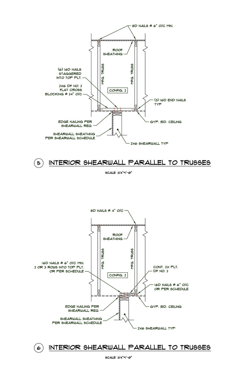

Since we are on the topic of interior shearwalls I've sketched a rough schematic of a typical residential interior shearwall situation that I commonly encounter in some form or another. I apologize that the drawing and dimensions are completely not to scale:
I'm pretty confident with the SW2 and the drag truss inline with it. The truss completes the load path and provides the collector to SWL C.
With SWB since it runs perpendicular to the trusses needs some shear panels above it to the roof diaphragm or some mini-shearwall trusses made up by the truss manufacturer. According to everything I've read a collector should connect SWB to the exterior wall SWL 3, however this is entirely open space. I think I am a little more unclear as to best handle the need for a collector at this location.
The trusses are standard trusses in this case, nothing fancy here, no vaulted ceilings etc...
Note that the exterior shearwalls are not shown. Due to the number and size of the windows there typically is not much room for exterior shearwalls hence the need to utilize interior shearwalls. FTO shearwalls, portal frames and moment frames are always options but avoided if possible due to the added complexity and cost.
Most of the residences I work on are in Exp. C or D and the basic wind speed is 155 mph (ult.) so lateral forces are usually quite significant.
Quote (Medeek)
Yup. I see it the same way except that I think the collector needs to be at the level of the plywood rather than the drywall. You can play some games with partial diaphragms and ride along roof sections but it gets pretty sketchy pretty fast. And then there's all the considerations that go into achieving rotational equilibrium for each of the three little panels.
Unfortunately, for all but four sided, flat roofed boxes, most diaphragm designs are full of load path holes and questionable assumptions. It's a tough road for the conscientious.
I have never done a FEM for a wood truss roof. The crux of the problem you are concerned with seems to be the impact of roof slope on the roof diaphragm and the flow of the forces. I believe the worst case will be a typical gable roof. Once you start adding hips into the mix the stiffness of the assembly will increase. You could make this roof as complex and accurate as you like, but I would start with something simple to calibrate the idea and keep the meshing simple. I would model a single truss as a 2D element assuming some chord dimensions and material strengths. From that it would be easy to create a 3D roof and then add a roof diaphragm element. Then I would likely add in some typical construction bracing and apply some interior restraints to get a better idea of the force distribution. To determine the shear wall load distribution you could assign spring constants, but I would likely start with pinned connections to check that the deflection appears reasonable. Spring constants will take some time to calibrate to get a reasonable load distribution. I suspect you would find the roof stiffness is greater than many of the simplifications suggest, and the roof will behave more like an assembly rather than individual components.
As we can clearly see from the respondents posting, the simplifying assumptions can vary. Most of the literature usually only covers the simple cases. From those we all develop rules of thumb we follow for our practice. There are some interesting practitioners in the residential engineering field.
The last detail you posted makes sense, but keep in mind the labor to implement that. A typical roof truss for a common house is approx $100 (can be less). The labor to cut all the blocking and nail them into place and can be more than adding an extra truss if the shear forces suggest you need more than one truss.
The interior shear panel you posted earlier can be a time consuming detail to implement. All of us engineers like plywood in these cases because it can be cut neatly cut to fit (in our minds anyway). From the contractors point of view on site he has to cut each 2x4, nail it into place and then attach the plywood. This is more time consuming than adding additional bracing between the trusses while they are installing the construction bracing. You can add a top/bottom chord member laminated to the vertical webs to create a truss of sorts. You will have eccentricities with that detail, but practical solutions will lead to more work long run. We do not typically get direct feedback on our designs, but you can be certain the framing contractor will make comments to the owners, or the GC about time consuming details.
For a $300 fee I hope you are working towards solutions that are in the realm of 2 - 5hr. You need a salary and must use a multiplier on that rate to account for the fact you are the IT, PR, HR, and accounting guy (assuming sole practitioner).
So which is better?
PDF and AutoCAD
Mechanically, I like four. I'd expect contractor pushback though and would probably compromise to three. Like woodman88 suggested above, sooner or late, you end up using drywall for stability. Maybe CBSE can comment on how well the pre-fabbed bracing has been received on his sloping roof projects.
If the resistance is the same in all four, #2 is the one they will pick in the field. That is very easy to implement. Your personal preference is meaningless unless it is your house. If the resistance is different I don't follow the point of the question.
Many truss companies will sheet a gable end truss in the shop, but you would have to accept a joint at the top of the wall.
Has anybody used two and had the opportunity to verify its condition after a few winters? The concept is clever but fatally flawed in my opinion. The wall won't be centred between the trusses, it'll be six inches or some other random value from one of the trusses. When the trusses deflect, if the plywood doesn't snap in flexure, it might just shear clean off.
I should mention that all this stuff is hypothetical for me. Unfortunately, I work in a region where diaphragm design garners little respect so it just doesn't get done for the most part.
I don't think 1 or 3 are that unreasonable, weather it comes sheathed or not. Really any of these I could see working. I've never seen #2 implemented but in order to brace a partition between trusses (and parallel) you normally would have wood blocking between trusses to brace the top of the partition. I don't recall seeing this blocking in bad shape but I can't say that I have looked either. I was thinking 4 was being used for the perpendicular case but I see that it helps eliminate buckling stability concerns. I suppose though the gypsum board ceiling will do fine in bracing the bottom chord (given the lack of failures??).
I agree with the premise Koot if the roof is considered to be a combination of 2D trusses that all deflect independently as the truss calcs suggest, but once the roof is complete it functions like a unit. If this were a problem I would expect this problem to exist at all interior walls where they are parallel to a truss. It is very common to screw the edge of the ceiling drywall to an interior wall that has a larger plate attached to the top of the wall. After the ceiling board is in place, the wall board is installed tight enough for taping. This in effect will create a similar situation since the walls are much stiffer than any one single truss. I have also seen many renovation projects where walls parallel to the roof trusses have been framed tight to the U/S of existing drywall and they have performed acceptably. That is not a good practice, but if you have installed any sheetrock you will get why some might choose to do so.
He could add a 2x4 on edge to stiffen the shear element and avoid excessive drwyall cracks if he is concerned. That detail still can be completed with a framing nailer, and some leftover material that was ordered to create all the tee bracing truss guys come up with these days to deal with the long unsupported truss chord lengths. Nails and 2x4 scrap are both cheap. Think of implementing the other details if you had a 12/12 roof where the truss span were say 35'. The total truss height would be 17'-6". With a 10' or 12' ceiling that puts you almost 30'-0" in the air. That is yet another piece you get to fly in with the picker, whereas detail #2 is ladder/scaffold work whenever you have a grunt to do it.
The plywood will not shear off, nor snap, but it might deform. I have watched truckers use 3/4" plywood scrap to offload their loaded trailers (high boy trailer). The plywood is not happy, but it is does not shear or snap.
I'm with you on all of that Brad. However:
1) I consider connection to a shear wall to be much more critical than acceptable performance of nearby drywall. For shear wall connections, I'm much less willing to place my trust in anecdotal experience that doesn't calc out.
2) A long truss could easily deflect 2" vertically next to a wall 4" away. That would induce a good deal more curvature into the plywood than your scrap offloading example. Snap, snap, snap I say.
Everything in your post confirms a suspicion that's been building in my mind: the Malone detail is bass ackwards. Designing the plywood to be flexible enough not to draw gravity load is silly. Instead, we should design the element that spans from the wall out to the trusses to be able to hold the trusses up. 2x6 @ 24" o/c with clips or something along those lines.
Yes, I agree the shearwall is more critical from a structural point of view, but drywall cracks are more critical to the homeowner. Homeowners get annoyed by a such a problem and they call to complain or ask you to spend your time investigating the problem.
I doubt the plywood would fail before the nails would start to deform in the example, but it will boil down to a battle of stiffness. I have a vacuum press for veneering and have edge loaded plywood many times by accident when the backer hangs over the edge of the piece being veneered. I have also built curved forms for veneering. The trailer was not a great example since it is sitting on clay, but the trailer was loaded to approx 25,000lb.
The importance of this question boils down to ones belief in the 2D truss deflection analysis. I agree with the 2D approach, but I do not believe it is very accurate at predicting the deflection of a 3d roof assembly. Have I tried to prove that with a detailed analysis, no, but I have looked at enough snow loaded roofs to be comfortable. I was going to share some of my examples, but I found a couple of technical papers that might be of interest to your inquisitive mind.
- ASCE: http://ascelibrary.org/doi/abs/10.1061/%28ASCE%291...
- Wind Engineering Conference: http://www.engr.uconn.edu/~wzhang/Pdf/C201306ACWE1...
The ASCE paper does not appear to have compared deflections, but they did find up to a 58% reduction in connector forces. The ASCE study did not include a plate element for the roof sheathing.
Away for a christmas party and I miss all the fun. Here are the other typical methods that Terry Malone's book considers as flawed:
Detail 5 is problematic in that the nails connecting the flat blocking to the trusses will probably fail in shear.
Detail 6 is problematic in that the 2X cont. plate will be in cross grain bending and/or prying.
I've mostly seen Detail 5 both for interior shearwalls and other interior partition walls.
I've seen detail 5 more times than I can count. And I would reject 6 in a heartbeat if I ever saw it.
2 would bother me as well. since the sheathing would only be a single span if the board didn't snap in 2 I would expect the fasteners to rip out of the edges and the whole piece get popped into the attic.
1 and 3 are my preferred details but getting the contractor to line up the truss over the wall is a pain.
4 is a pipe dream, as nice as it is no one has ever done it that I have seen.
jayrid12:
If you are using Detail 1, how are you bracing the top chief of your shear wall from buckling out of plane? Relying on Sheetrock?
Detail 3, 5, and 6 in theory could work. It doesn't tske much force to brace for out-if-plane. 1 and 3 aren't really much different than 5 and 6. They are all braced by Sheetrock.
The contractors that have built my projects have always put the blocking in...on the buildings I have inspected. If it wasn't there, it was noted to be installed.
Yes, I consider the gyproc enough. If the wood design manual gives me diaphragm values for gyproc then it must be worth something.
However, 3 is my most preferred detail, 1 is for lightly loaded shear walls where out of plane buckling is unlikely. The gyproc provides some nominal support even if you don't like using it for actual lateral resistance.
Have you ever read your truss shops? More often then not they have some note about the building designer to provide a rigid ceiling, how do you provide that? I use gyproc, I'm not going to specify that the ceiling is sheeted in OSB prior to drywall, I would never get another wood framed job in my life (and I actually like wood framing).

This thread is a bit dated but to bring it back on topic and close it out properly I've spent some time tonight putting together a very simple spreadsheet for a sloped shearwall based on the paper presented by Thor Matteson:
http://design.medeek.com/resources/shearwall/SLOPE...
I just recently ran into another shearwall on a balloon framed gable end, as they say necessity is the mother of invention.
